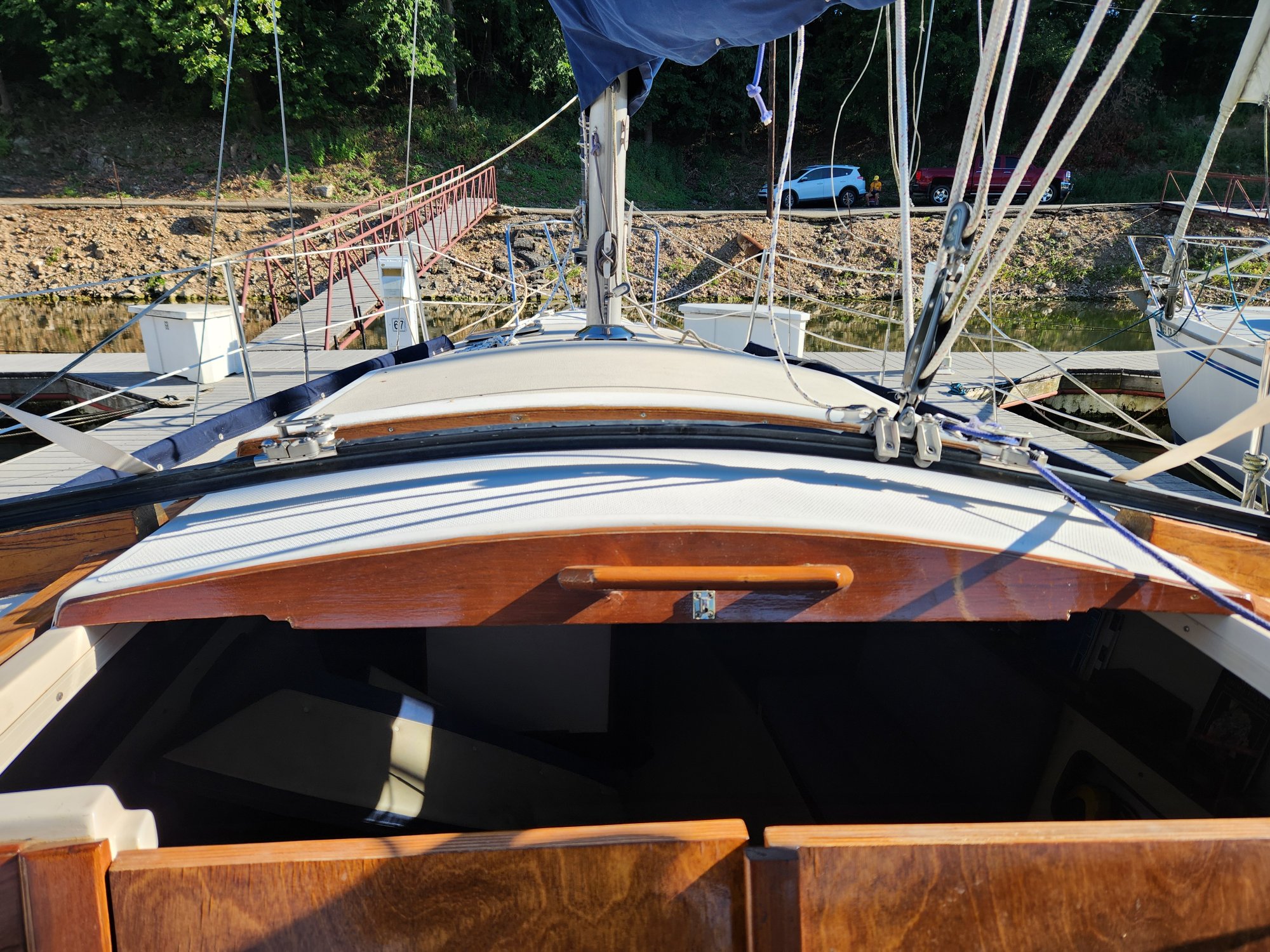

Your friend should consider replacing the curved track system with the Garhauer straight track. They sell a version that sits on the existing teak blocks. I assume the traveler car is original and the rubber rollers lost their efficiency years ago. The curved track traveler looked nice but it was one of the poorest designed system ever created.

I was aware that the curved track was a poor design, another friend replaced his for that very reason. This particular ower doesn't really need the new tech, I always sail with him and I understand that the arch changes the trim. He got a great deal on this boat and I'm helping him sort it out.
Thanks for the tip about Garhauer. I'm sure it's also available through Catalina Direct. I was just exploring other options.

You indicated that the curved track traveler effects trim and you're right but it shouldn't. The traveler only adjust the angle of attack and trim is not effected as it moves but what happens with the curved track traveler is when the traveler car is moved off center and if the mainsheet is not adjusted the car is traveling downhill and acting like a boom vang and accordingly changing twist and draft position.
When I purchased my C30 the traveler was the first thing I looked at. The second was the pin type jib cars. Anyway, trying to save a few bucks, I had Garhauaer build me the double block system your friend has. I knew the first time with the new setup that it was a mistake and I should have bitten the bullet and purchased the straight track, which I did. I should have "cried once" instead of twice. I didn't make that mistake with the jib cars and purchased the Garhauer adjustable system.

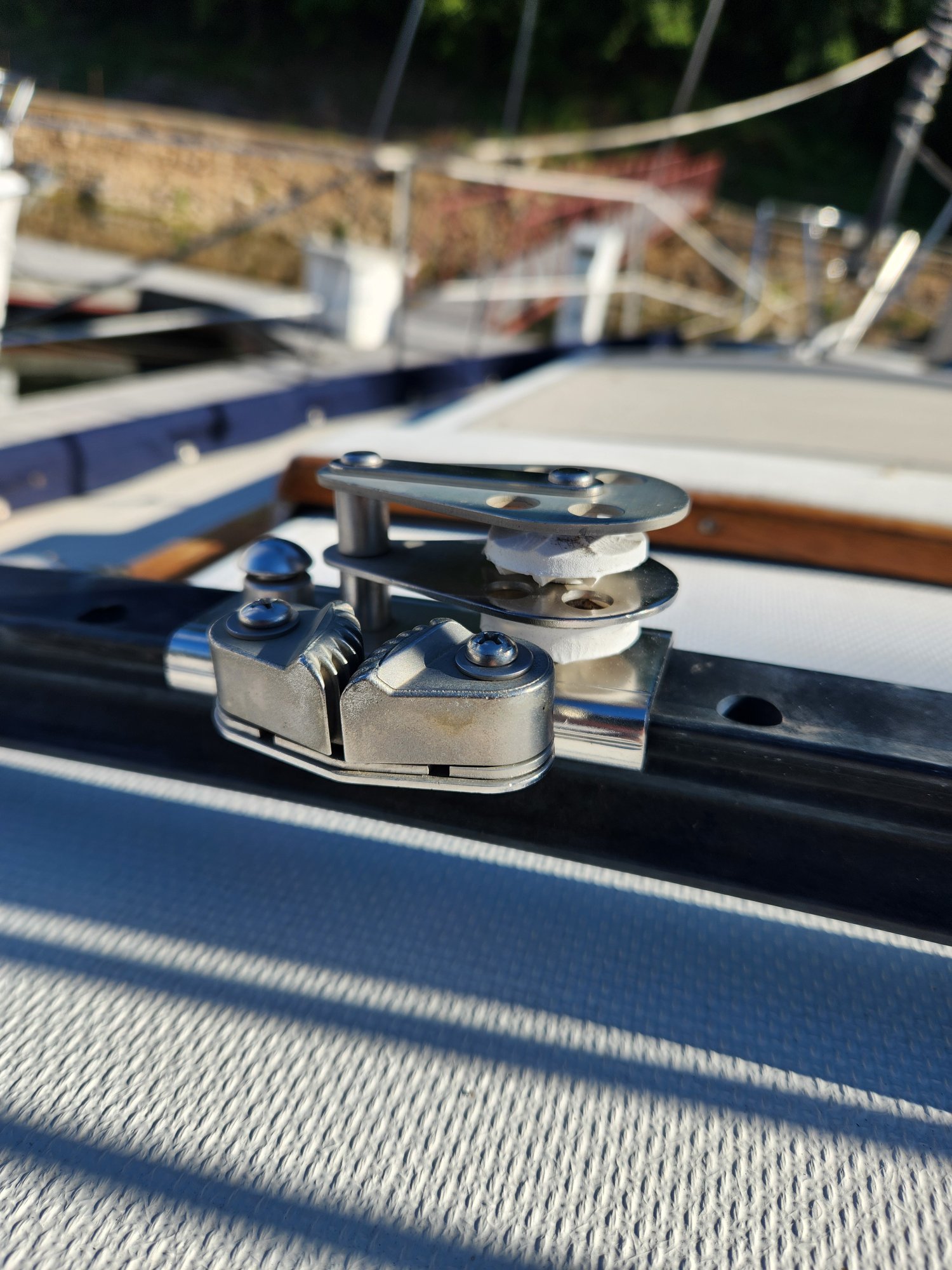

Troy, this isn't really a Garhaurer component. It's at least 40 years old and out of production. Garhaurer didn't start supplying equipment for Catalina till 1990.
Anyway, you're going to have to do some work... which means identifying and measuring the sheave that needs replacing...hopefully you still have the other component for reference.
Here are two references. First is a clue. Plug this search in google to get started.. sailboat rigging sheave replacement
To refine your search you might add Delrin sheave to the search

Before I upgraded to the Garhauer straight traveler on my 1984 C36 I made new sheaves for the old traveler from Starboard. It requires a lathe. the toughest part, according to my vague recollection, is grinding off the rivet heads to take these apart. But, it can be done.

You might suggest that he use vang sheeting. Normally the vang is not used for upwind work, but you "can" use it to set the twist which is the typical main sheet function. Then with the twist taken care of, they can use the main sheet for angle of attack which is what the traveler usually does. With this usage, the old traveler is just a centerline anchor point for the main sheet and does not need to move.
I have a friend with a C34 that has been sailing his boat this way for years due to the bearings in the traveler car being toast.
