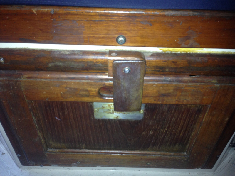

My doors don't have hinges they have been modified as suggested and work great.

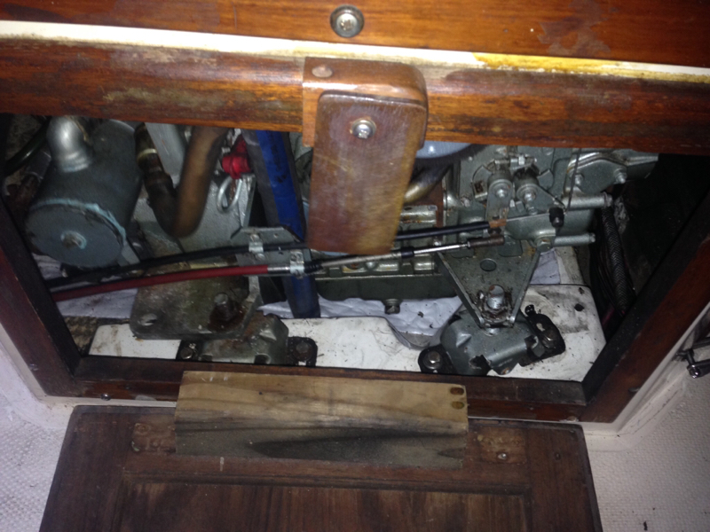

Not the best picture but you can see the doors on the left side of the picture and you can see the wood latch at the top of the opening. Picture was taking as we were preparing to lift the engine to replace the transmission.

<img src="http://forums.sbo.sailboatowners.com/attachment.php?attachmentid=84616"/> Not the best picture but you can see the doors on the left side of the picture and you can see the wood latch at the top of the opening. Picture was taking as we were preparing to lift the engine to replace the transmission.
That looks pretty much like my cabin when we were getting ready to hoist the engine to replace the transmission!! Did you place the door hinges on top of the doors, and did you make any mods to the doors or frames to fit the hinges? If you are using "take apart" hinges I would appreciate it if you could take pics of how you attached the hinges to the door and frame. I realize you may not be able to do that now, if your boat is wrapped up for the winter. Thanks!

Ok hvbaker - just checked your post again and you said you didn't use hinges! So, if possible, pics of the how you attached the door latches! Thanks!

<img src="http://forums.sbo.sailboatowners.com/attachment.php?attachmentid=84702"/> <img src="http://forums.sbo.sailboatowners.com/attachment.php?attachmentid=84703"/> Hope you can see from these pictures.
Thanks for the pics!!

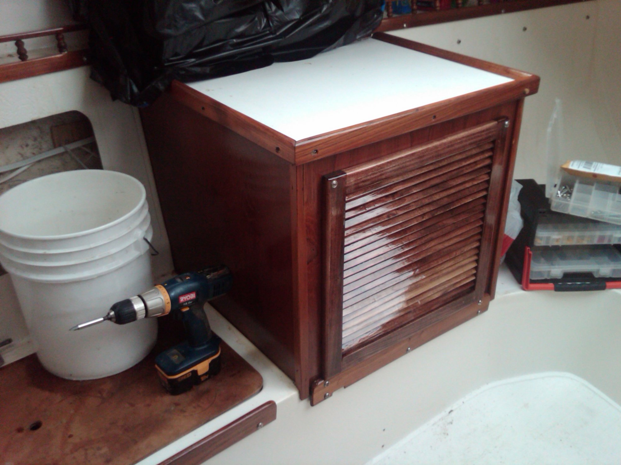

When I installed the house batteries under the nav table. I made a simple louvered panel to cover it. Originally, it was screwed in.
Then I installed velcro around it.
That was 3-4 years ago and it works fine.
