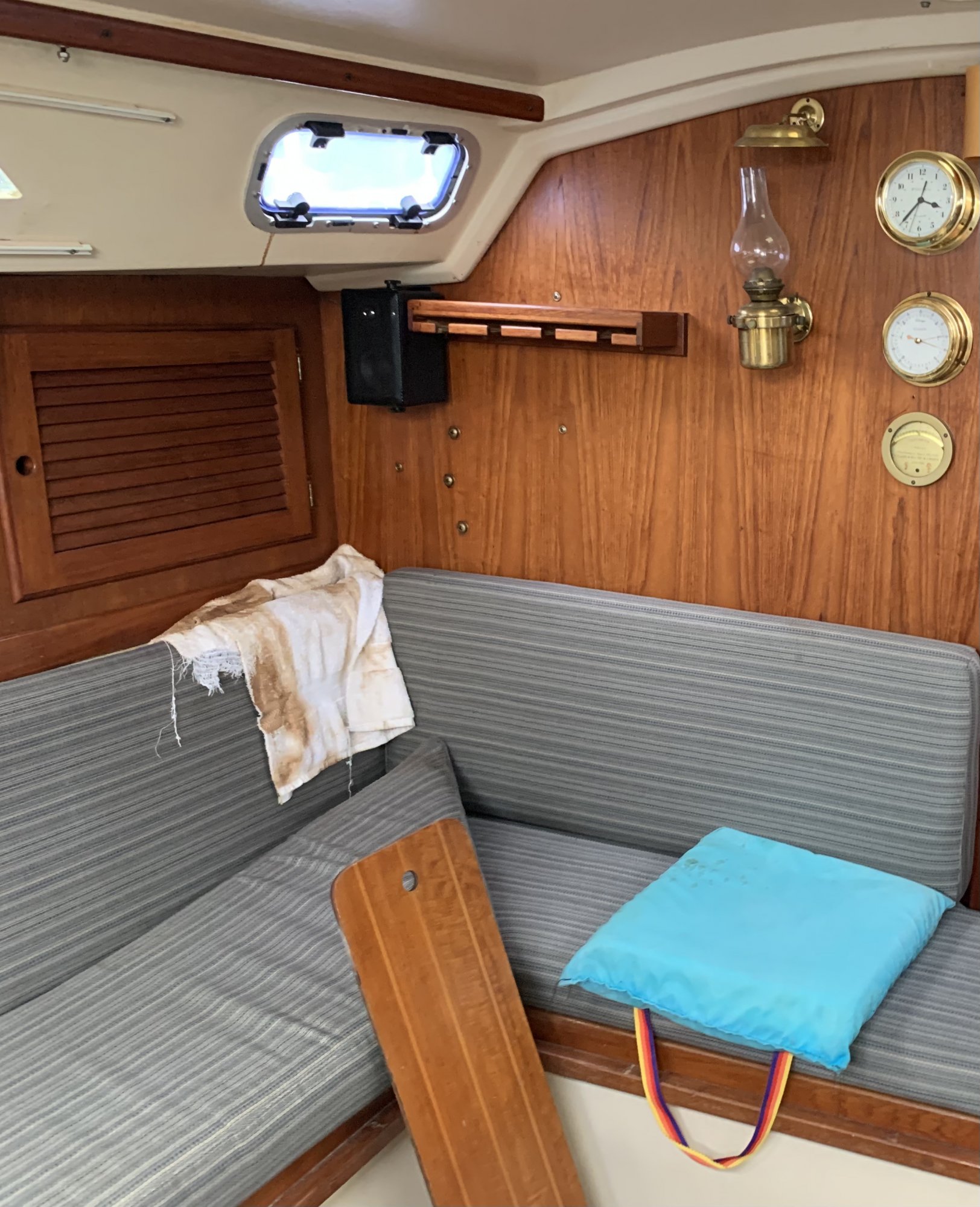

The port side window of my 1989 Catalina 30 TR BS, the one aft of the head window, has a dark, brown liquid leaking out of it when it rains. The previous owner said it started about three weeks ago. When I opened the window, the leading edge is wet and covered in brown liquid. I’ve been told the brown liquid is water mixing with the resin in the deck. If so, I’m concerned it’s coming from the mast step and there may rot everywhere. But, it could be something as simple as a window leak. My question is this: Has anyone had this problem?
As an aside, approximately 2 years ago, the previous owner removed the wooden compression block in the bilge, added a metal one fiberglassed into the boat. They pulled the mast down and noticed the so called “Catalina Bird Bath”. While the mast was out they checked for rot and didn’t see any. To be safe, they injected epoxy around the opening and built up the deck for the new Mast step to sit on. They then installed a Stainless Steel Mast step and reinstalled the mast.
The boat is in impeccable condition and we are looking at purchasing it. This came up right before signing the paperwork. I’m trying to figure out what is going on so I (or he) can get it fixed. We just need to know if it’s something major or normal.

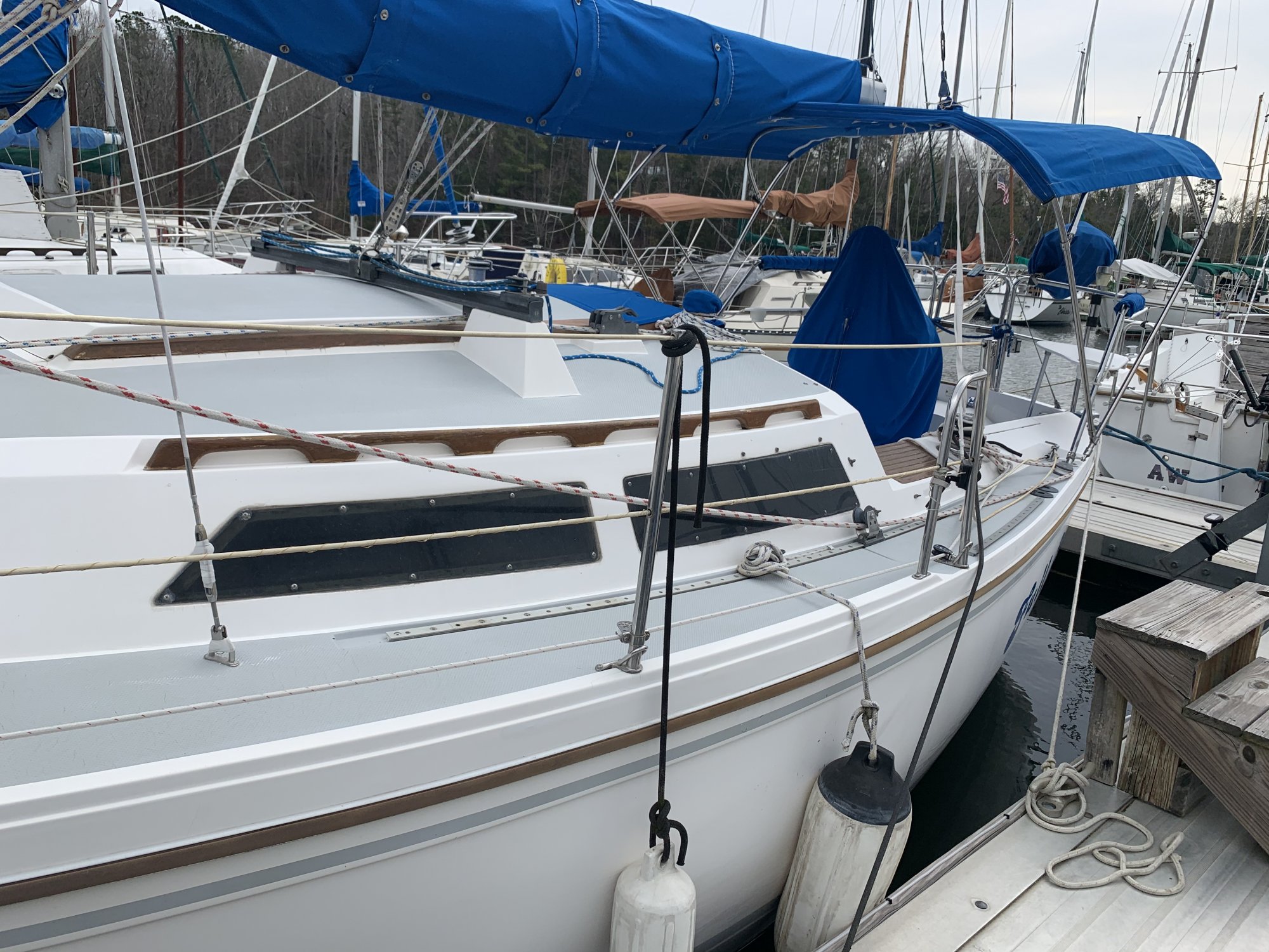

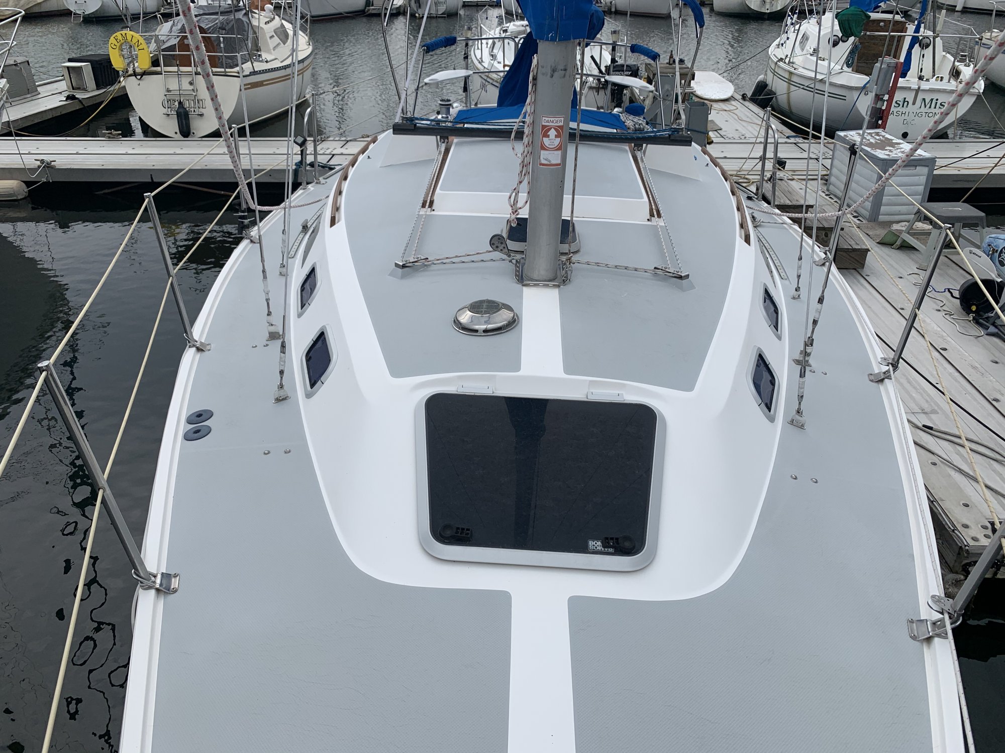

Looking at the pictures possible suspect’s are the mast, the hatch behind the mast, the fittings for the halyard turning fairleads.

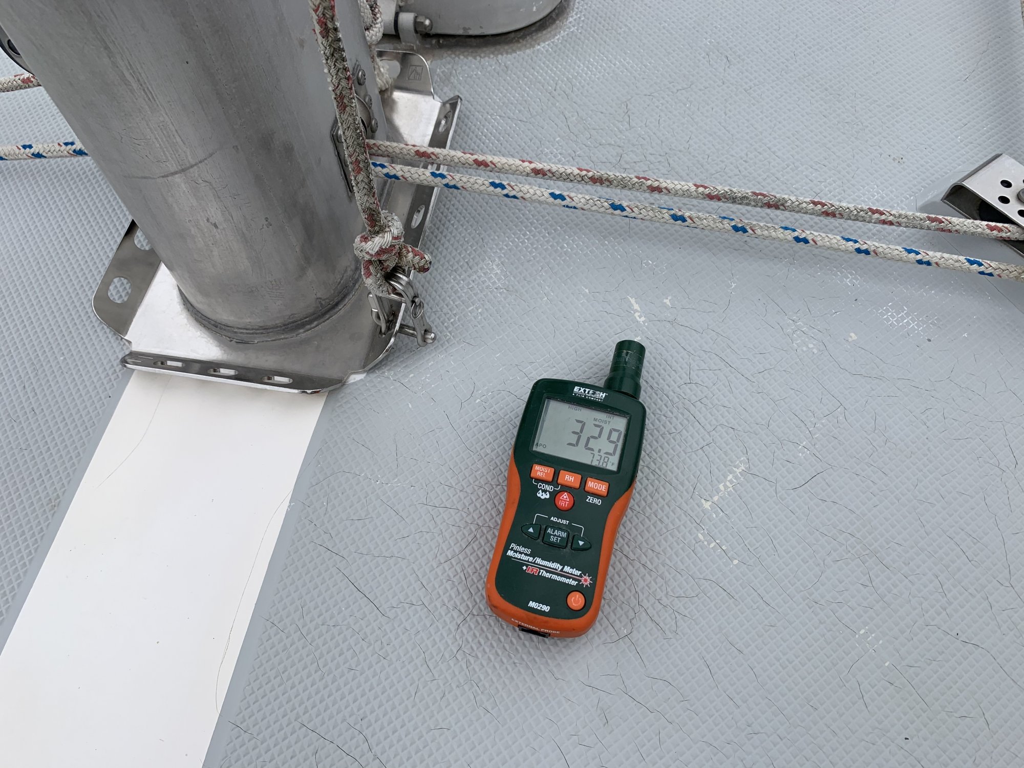

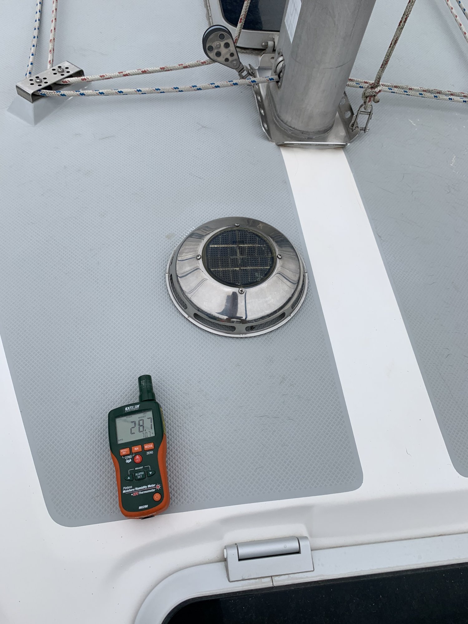

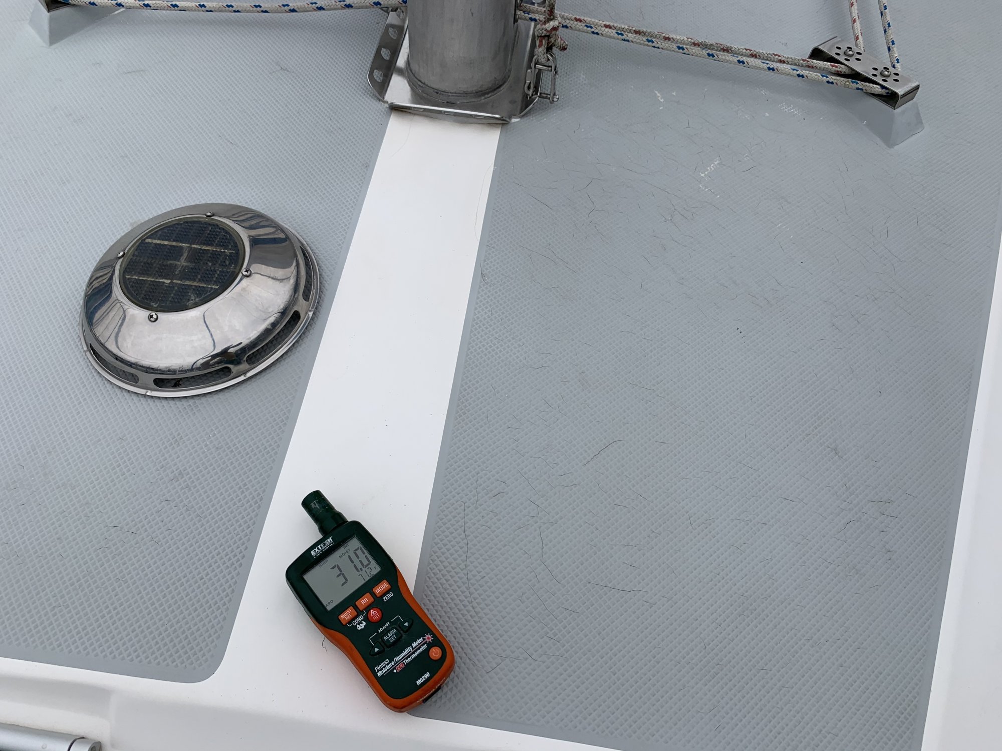

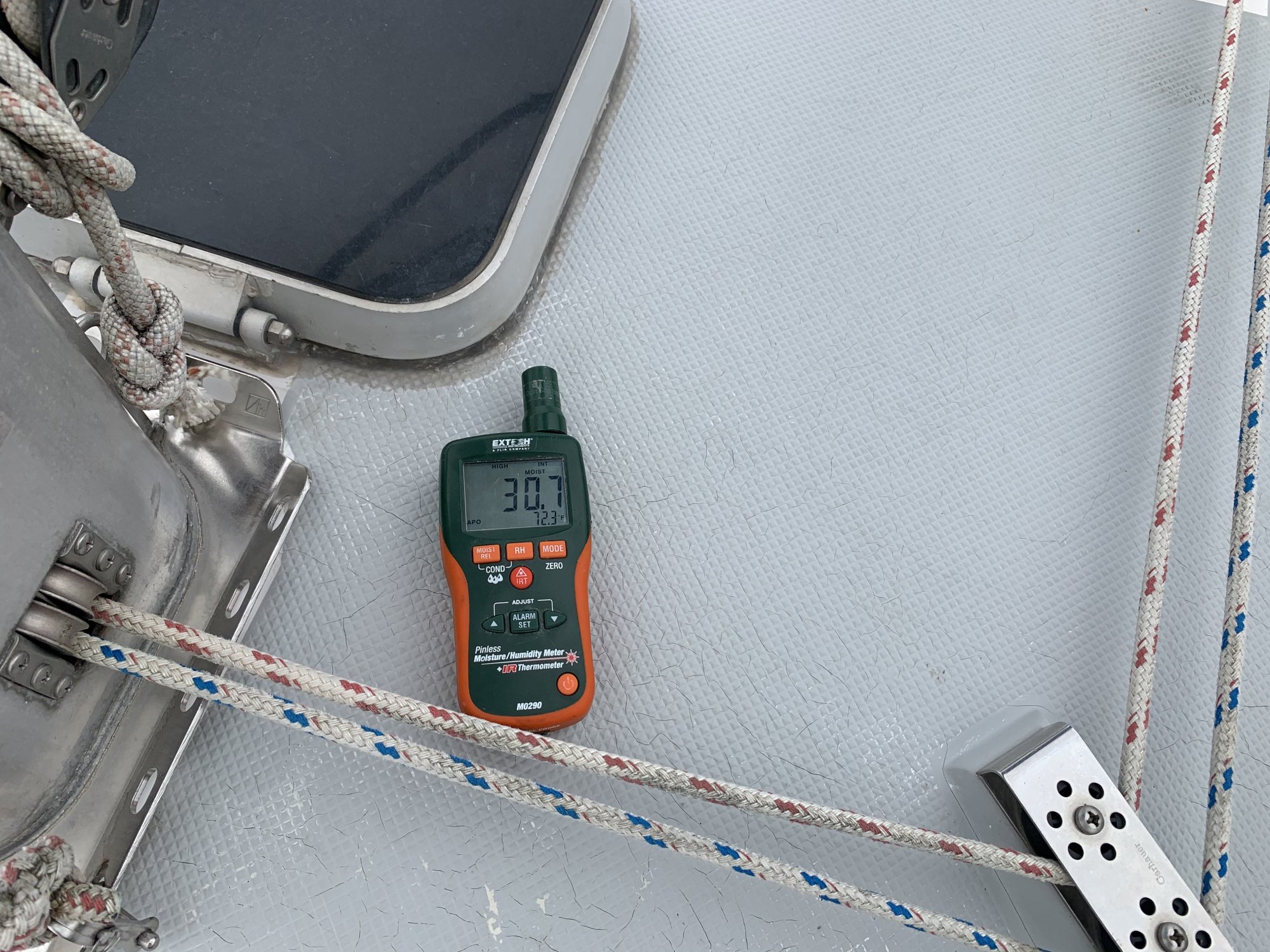

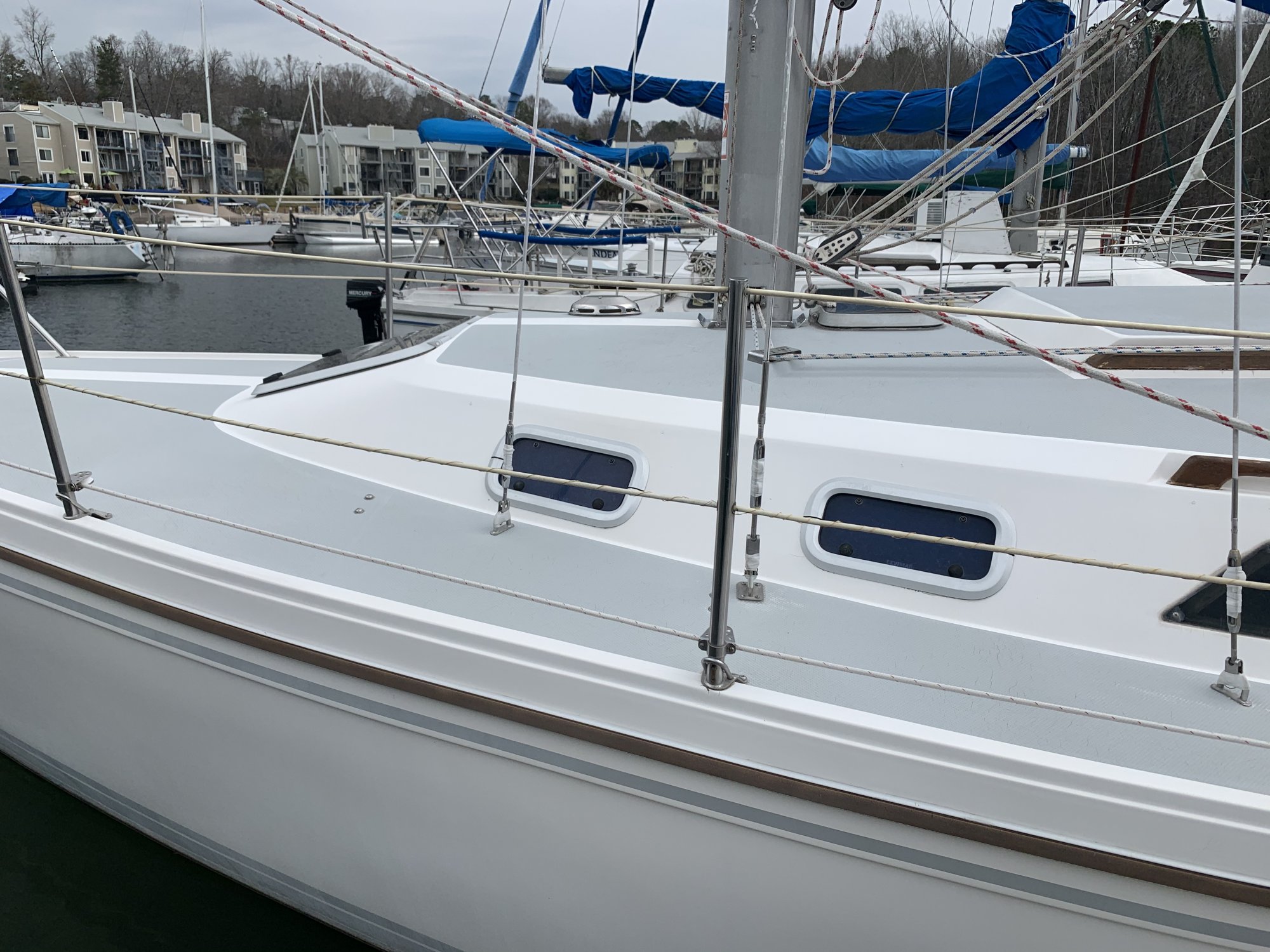

I borrowed an Extech MO290 moisture meter from a friend and checked the boat. The moisture levels around the mast and on the side of that window was high. I had a local marine, fiberglass repair guy come out and give me a rough guess on price (a range).
After talking to the owner, we settled on a price that would allow me to get it fixed in the near future. Once I do the repair, I’ll post pictures.
Here are pictures of what it looks like now
14,245
The photos tell the story. The area under the mast step is wet, the core has rotted and it needs to be fixed. There is not enough support for the mast. This is not a repair that should wait. Otherwise the boat looks clean and cared for.
Good luck. :beer:

The weird part is you can’t hear it. The repair guy did a percussion test and really couldn’t tell where it was. Maybe a little but barely. He said the deck felt strong. However the meter showed a different story.

The cracks in the deck are from the water in the core freezing and expanding. Boat looks nice otherwise and that can all be fixed - my last boat was a 1989 C-30, great boat.
The depression in the deck is the telltale sign. The yard guy who said it was the "Catalina bird bath" was referring to that depression. Don't rely on only measurement, i.e., deck sounding. Use all the available information.
