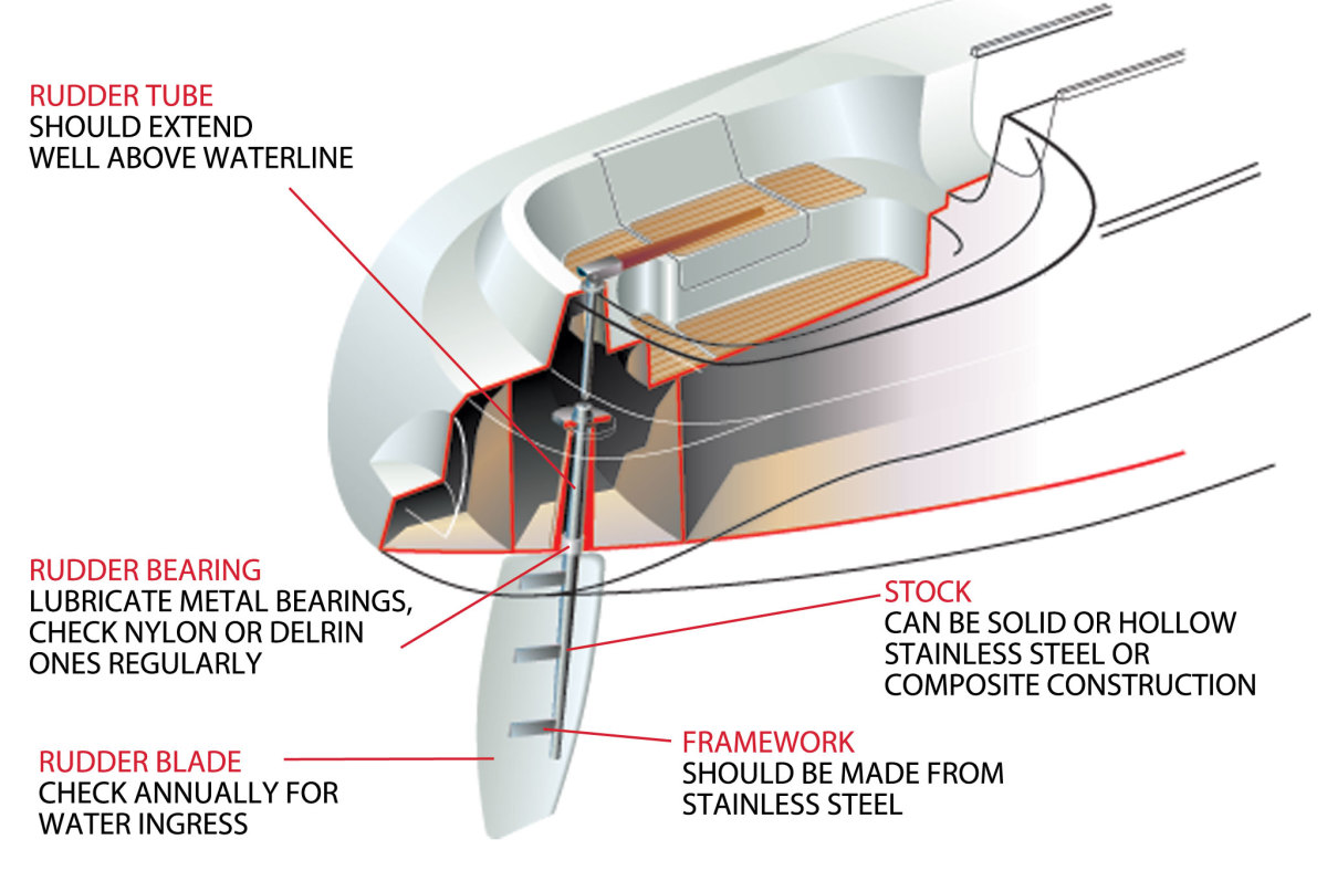

William, while not good news at least you have identified what could be the issue.
Nearly all rudders I have seen on small boats have a similar construction. Here is an image that shows the shaft and attached metal braces(frame work) that are used to shape the rudder upon.
Andy from BoatworksToday did an informative rudder rebuild that may help you with ideas about your challenge. Your rudder would be similar. The shape and centering would depend on where the bend is. Be certain, before going to the work of repair, that the issue is the rudder and not a defect in the rudder shaft log or bearings in the boat hull.

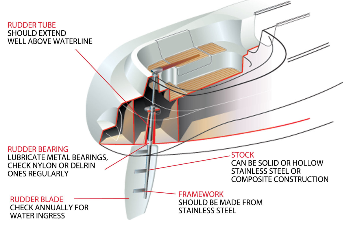

Andy from Boatworks Today did an informative rudder rebuild that may help you with ideas about your challenge. Your rudder would be similar. The shape and centering would depend on where the bend is. Be certain, before going to the work of repair, that the issue is the rudder and not a defect in the rudder shaft log or bearings in the boat hull.
Thanks for the info. I have had the boat out of the water and looking at the rudder from the stern I can line the port face of the rudder with the centre line of the back of the keel, when I try to line the starboard face up with the keel the closest that I can get the face to line up with the centre line of the keel leaves a gap of about 50mm, wherever I point the blade. Technically each face of the blade should line up with the keel with the same amount of rotation. This led me to believe the shaft was bent, if you say that all the Catalinas have the same problem makes me think it is an alignment problem with either the prop shaft being offset to starboard, or the rudder stock is off centre to the port. I didn't think that with the reputation that Catalina have regarding the quality of their yachts that they would release yachts with this problem. I have never had any yacht that you couldn't let the helm go for a second without going into a spin. I don't know where to go from here, I don't want to go to all the expense of dropping the rudder out if it is an alignment matter and not a bent rudder shaft. I had better do a little more research, maybe other 28 owners can comment on their experiences. Regards Bill
