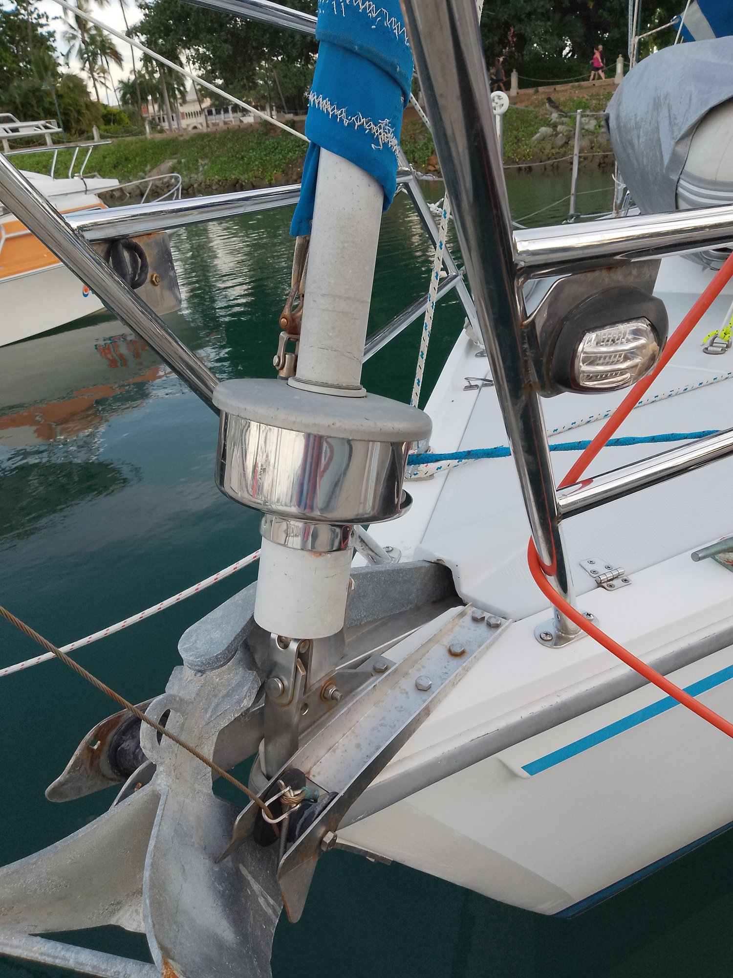

Evening all, I have a 1993 28 hull number 337. I am trying to identify the Roller Furler so I can give it an overhaul. Also, can anyone help me with the mainsail traveller make. I have been online trying to match them up but with no luck. Any help anyone can give me will be much apricated. Regards Bill.

Call Warren Pandy at Catalina (727) 544-6681. Give his the hull number and he should be able to tell you the source(s)..

To me it looks like a Hood Seafurl 800 furler. Manuals and much info on many sites including this site. Pompanette.com purchased Hood. Good luck.

That's a Hood furler. I have rebuilt, modified and addressed many issues with my last one. What's the issue with yours?

I have Hull 272 the roller furling is hood and the traveler is Garhauer

if you haven't already identified these items I have Hull 272 and my items are all from Garhauer.
