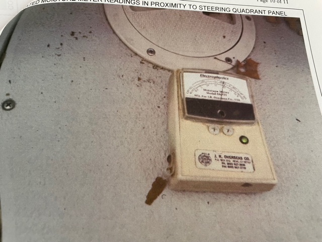

The cockpit panel to the steering quadrant is spongy and probably needs replacement. Where can one find such a part?

Fiberglass parts like that are often hard to come by - you should try Catalina. However, the panel is eminently fixable, especially since you can bring it home and do all your work from the underside, saving the top from any scars. There's lots of information out there on how to replace a soggy core and it would be a great project to get you familiar with epoxy (if not already).
