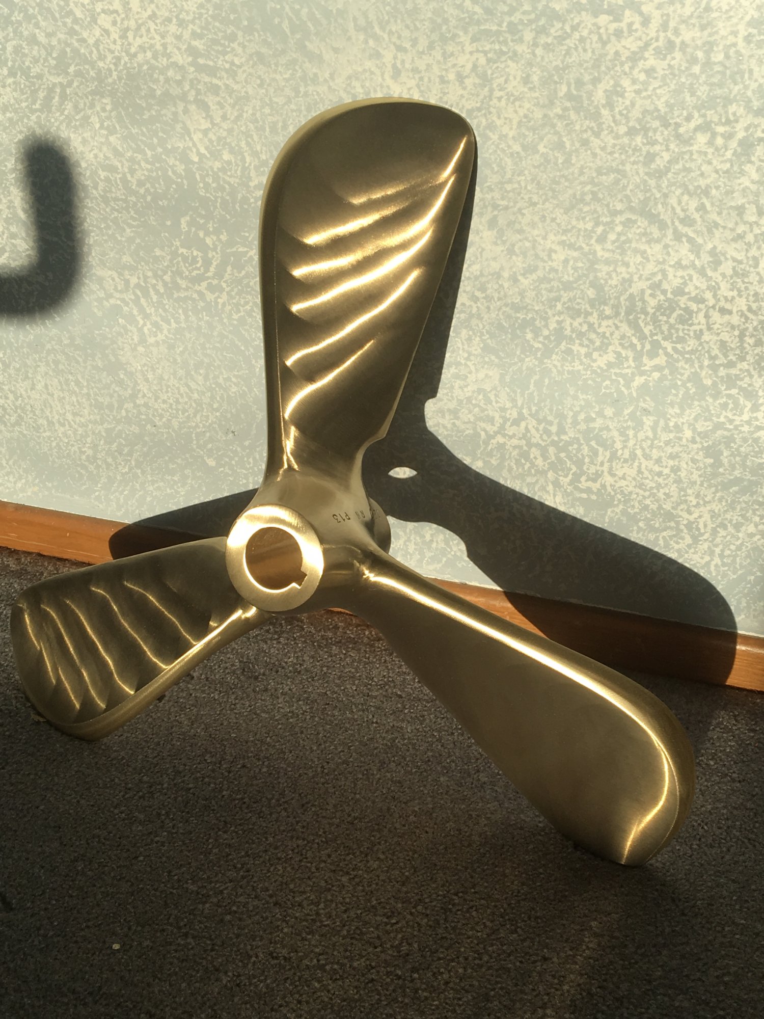

I had a prop that caused strong pull to port and pulled the stern end of the boat down as much as 0.4 meters when running at near WOT.
I changed to a much improved design, the Campbell Sailor. I got more efficient thrust. Less prop wash pull and no more sinking stern.
It might be an area to explore on your boat.
