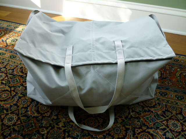

Also, I have found that the top down assym. slows the boat down if it is left furled and hoisted, so I drop it as soon as I can.
Yes, ETNZ found that out when they left up their code zero for the short sprint from the start line to the first turning mark. In the first year, I would hoist before leaving the harbor, but I always knew this was not aerodynamic for the leading edge of the jib. Typically, I sail upwind when sailing and reach back to the harbor. Lately, I just leave the spinnaker coiled on the deck or haul the spinnaker out and connect before we get to the turnaround point. My wife made the below spinnaker bag for me this spring:
which will allow me to rig up the spinnaker and keep it bundled together until I'm ready to hoist. Should be able to see how it works in the next few weeks.

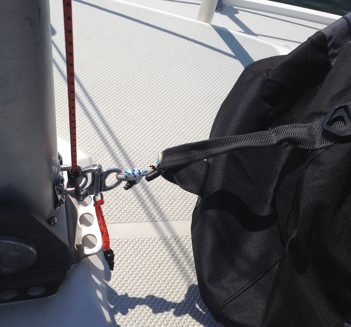

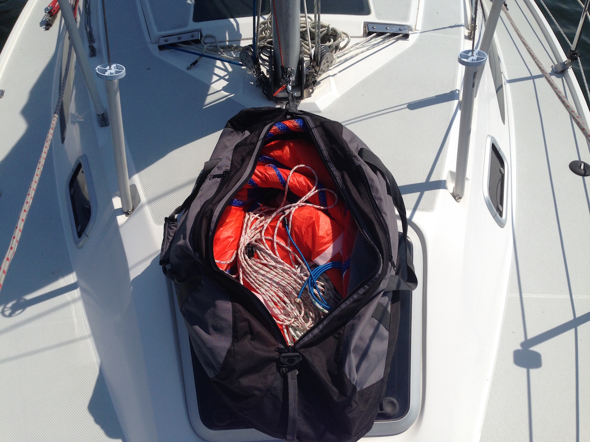

Codybear,
Another angle is to attach the bag to the mast base, with a quick release, so that the kite is ready to deploy. Here's how I did mine. (this way it can't escape while you're not looking...) It also make dropping it quite fast, the torsion rope coils nicely in the bag, the halyard clips nicely to the mast base, as does the tack line from the sprit, so it all launches from one spot.
Unfortunately, that is not an option with the self-tacking jib where the track is just in front of the mast, so leading anything back to the mast is problematic. My bag will sit on the locker hatch secured to the locker hatch handle and a stanchion to port. I put it on the port side so as to not interfere with the retractable spinnaker pole on the starboard side. There really isn't a lot of options for bag location with the C275 and the self-tacker.

Of course. The 270 is more of a traditional layout where you have to persuade the 155 manually. :) Food for thought anyway....
