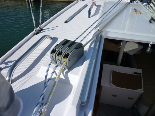

Can an owner of a 275 please describe the deck layout? Catalina sales info indicates only 4 rope clutches and one winch on the cabin top, but from some online forsale images I see up to 3 Lewmar DC1 singles on the port side of the cabin top and 4 DC1 singles on the starboard side and 2 Harken ST winches. Is that stock? Are the rope clutches all 8-10mm or a mixture of 8-10mm and 10-12mm. What are the lines? (Main Halyard, Jib Halyard, Spinnaker Halyard, Boom Vang, Outhaul, Single Line Reef, Cunningham)? Of the ST Harken winches , which model? If you wanted to make a change, what would it be? Thanks!
Jun 6, 2016
208
Catalina 275 Wilmette, IL

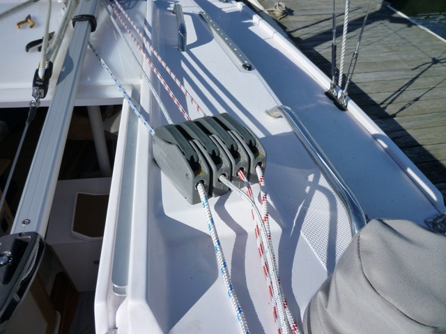

Looked at my receipt from 2014 and the "performance package" is standard, no charge. It included: Selden Bow Sprit, 2nd Cabintop Harken Winch, Deck Mounted Jib Tracks & Cars, and Cunningham Adjuster. The Harken manual titles it as a Radial Winch. Don't know the exact model number, but it is single speed, one direction only. The lines are from left to right (see thumbnails): jib halyard #1 (originally 10-12mm DC1, changed to 8-10mm), self-tacking jib sheet (10-12mm), boom vang (10-12mm, just fits), reef (10-12mm), main halyard (8-10mm), jib halyard #2 (8-10mm), spinnaker halyard (10-12mm).
See "Pimp" for what I did for the outhaul and the cunningham. Check out the other pimps and "Problems" for more ideas. I have several more future posts in "Pimp" that I need to get around to for additional ideas. Keep in mind, buying a Catalina is like buying a Ford. Your options are very limited and Catalina is resistant to custom. And if you want to save yourself some future mold problems, tell Catalina to keep their paint off your boat (see "Problems"). Gelcoat only.
Good way to determine what comes on the boat is to get a quote from a dealer which will list everything and select the ones you are willing to pay for. The spin at $3500 seems expensive, but I wouldn't go without and it was one of the two options I chose.

Excellent. Exactly what I was looking for. I really like the setup. Thanks!
View attachment 138584 View attachment 138585
