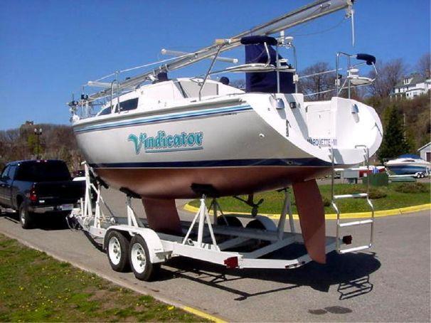

My first boat was a C-22, then I bought a new C-270. It was on a 2 axle Trailrite trailer.
I did not have a tongue extension. The boat floated off, but we had to crane/ Travelift the 270 onto the trailer. The 270 doesn't come with a tabernacle, so you must crane to step. Not hard.

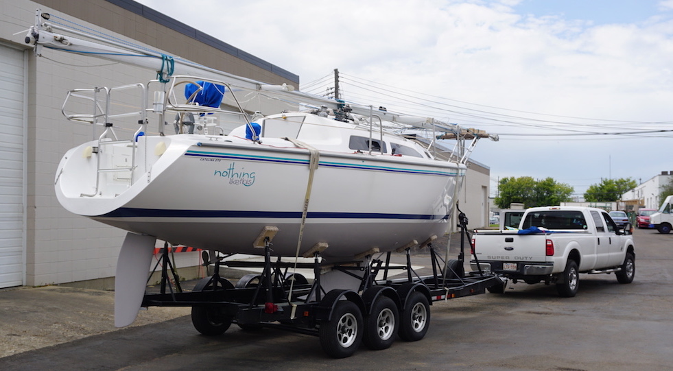

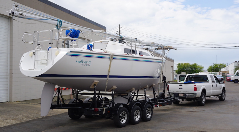

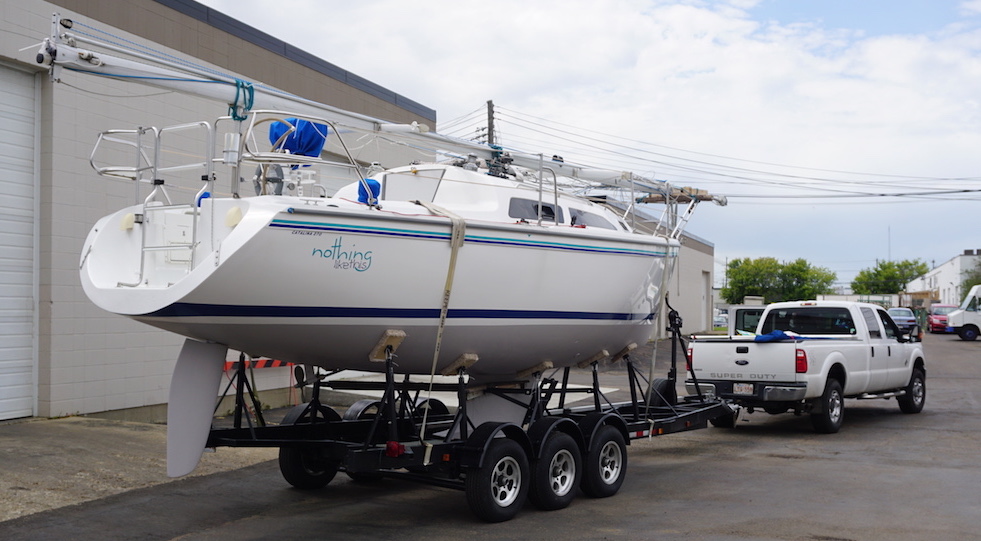

Hi Ron,
Welcome to SBO. If you have a look at the WordPress pages as listed at the bottom of this message you will see some pages about the trailer, the modifications and the migrational upgrades. I specifically bought this boat as it had a trailer. I did not think it would be like starting from scratch. It was essentially home made, and has been considerably re-worked, inspected and properly documented since. It sports three 6000lb axles with full electric brakes for a couple of reasons, firstly, the boat on the trailer tips the scale at just over 11,000 lbs. Two 6000 lb axles would be under capacity for the recommended distribution of 3/4 the total weight. Secondly, the safety and security consideration of blowing a bearing in the middle of nowhere is significantly reduced, as it would be relatively easy to jack up, then strap up a single wheel and carry on, particularly in the case of driving over some of the nastiest mountain passes on the continent.
The "usual" argument about three axles and the turning overhead was taken into consideration. With a long wheelbase, full size diesel truck, it takes a whole fleet of Honda Civics to get this rig into a parking spot anyway, so turning radius isn't of much concern.
