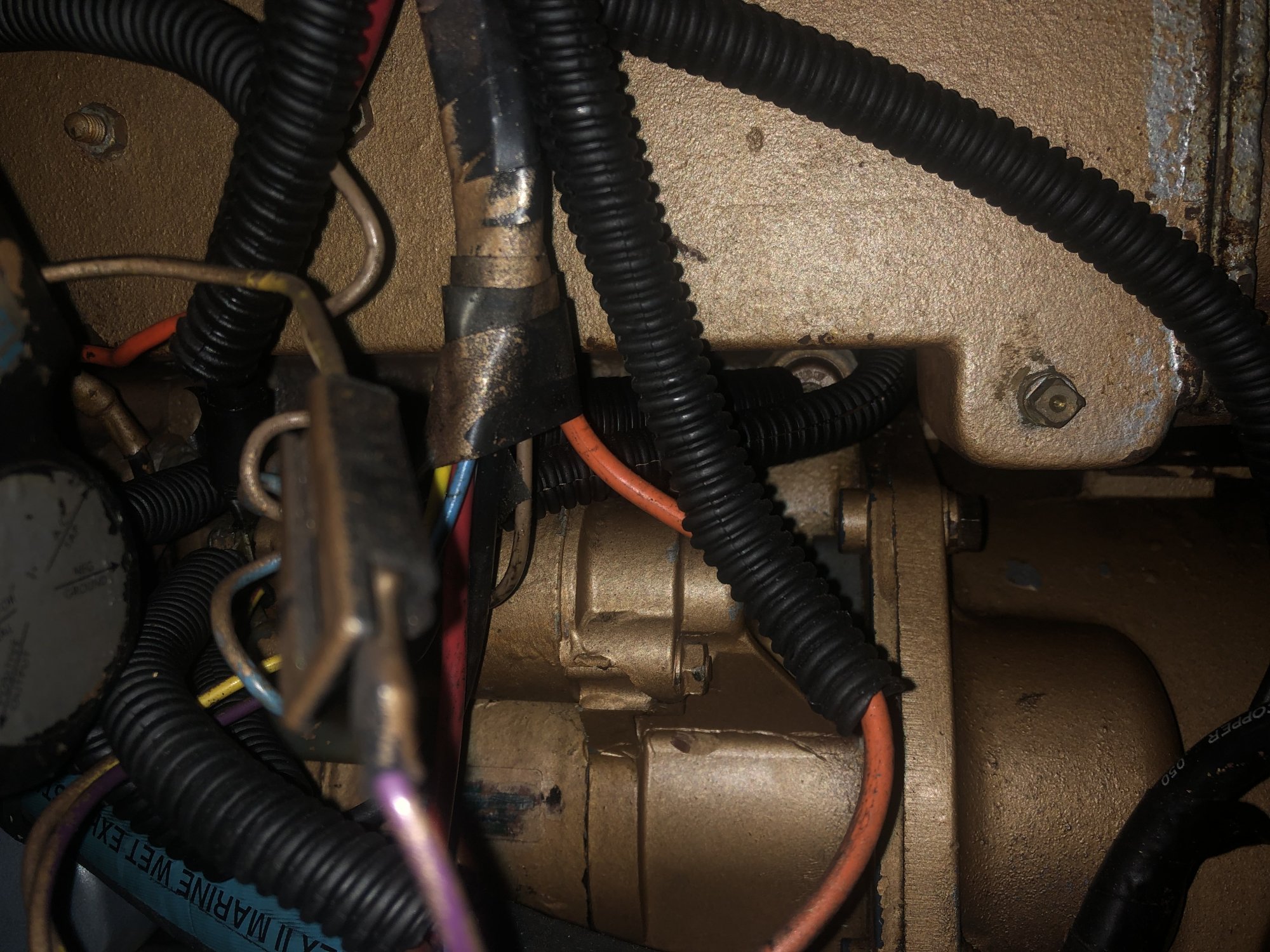

The starter and starter solenoid and panel plug are on the port side of the engine behind the alternator (attached photo) in a very easy to reach position if you are the size of a leprechaun. I’m thinking to get a non-contact voltage meter and try to start checking voltages without having to do do a lot of disassembly or replacements if possible.
