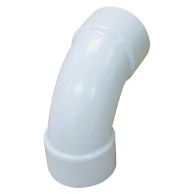

PVC pipe is an alternative. When choosing a tool for a 90degree turn you want to assure maintaining full flow of water. PVC pipe fittings for drain lines can be full flow design. It is often called a “sweep” elbow.
A reinforced formed hose can also serve to accomplish the job.

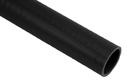

Thank you John, that is very helpful. With the help of some friends I was also able to find this on Amazon. It is a Pegasus silicone auto racing tube SHL-41 with an ID of 1 1/58 and said to be flexible. I will give it a try and, if it works, I will do a follow up post as it might be helpful for others.
Click image to open expanded view
Pegasus Auto Racing Supplies
Be the first to review this item
Price: $41.95 + $6.99 shipping
24,739
David. That looks like it would work great as a straight line run. If you need to make the hose turn a corner before it exits the boat get a pre-formed hose to make the bend. That way you will maintain full flow around the 90degree turn. Reinforced hose so it maintains it's shape and does not collapse.
