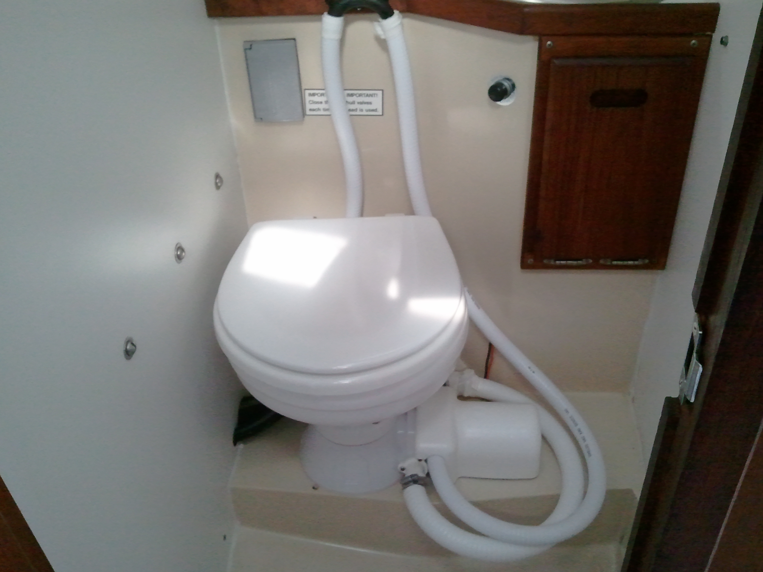

my old 27.
This loop was to keep sea water from flowing into the bowl. The electric jabsco didnt have a water/air switch like the non electric one, so sea water would fill the bowl when heeled.
Keep the waste out was solved by simply twisting the pvc elbow in the right direction so it had to flow a bit uphill from the tank.

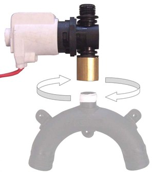

Relying on the "water air switch" (wet/dry valve) to keep water out of the bowl is very risky because a) water usually doesn't just fill the bowl, it overflows it....b) wet/dry valves fail and...c) people forget all too often to switch to dry after using the toilet. If you're lucky enough to be aboard and awake to notice that your shoes are afloat in the cabin in time to switch the valve to dry, you only have a mess to mop up. But more than one person has had to get up in the middle of the night and stepped out of his berth into calf deep water and a lot more boats have gone down in their slips when no one is aboard. Which is why the installation instructions (which too many people don't seem to think they need to read) for every manual and most electric toilets specify a vented loop in the intake (see the 2nd paragraph in post #4 above for the correct location). If your electric toilet is one that doesn't have a line connecting the pump to the back of the bowl, it's necessary to install it in the line from the thru-hull to the pump. That requires an electric solenoid valve wired to the flush button.
