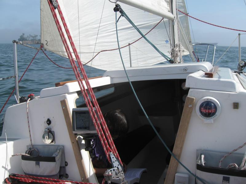

I just finished my radio installation on my C27 and thought it might be of some interest. it seems to be a reasonable compromise for a sailing ham, though some might bemoan the loss of storage space.
give it a view at www.doublereef.net

Hey Danni, isn't the chartplotter a bit close to the compass? Garmin wanted 2' of separation. Same with radios. Mine is on a Ram double swingarm so I can monitor it from the cabin or the cockpit.

you ignored my comment about swinging the compass, which is essentially a recalibration and table of offsets. in aviation we must correct for anything added to the panel with correction factors on a correction card. it's not all that critical on the boat, as with GPS I am far more interested in COG or the displayed heading from my linearized flux-gate compass. my bet is that you and many boaters haven't swung their compass or recognized that the magnetic compass is an inherently inaccurate measuring device.
for the record, after the install the compass was not affected much at all. certainly within the margins of aggregate error from all sources. should I need to see the chartplotter display from anywhere else I use the iPhone or iPad via the remote Raymarine apps.

I suppose the compass is more of a decoration with all the electronics...
I wonder if there is any variation depending on bluetooth communication, just seems to make more sense to minimise interference, rather than compensate for it. But given that most recreational sailing in small boats is done within sight of land in known waters, probably a moot point.
And yeah, I have swung my compass, tried to do it on the trailer, but found out it made a difference. :doh:
