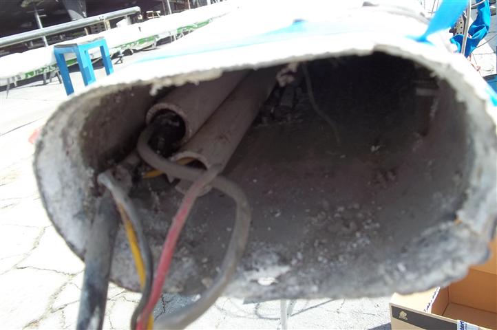

  • There may be conduit for your wiring and/or VHF antenna. Stand on deck and look at your mast - you should see rivets going up. If you do, that is what is holding your conduit in place. Some masts were built with the conduit molded-in when it was made at the aluminum extruding factory, but I don't think Catalina used any of those on the 27's.
  • If the wiring does not run through conduit, expect to find it wrapped around some sponge halfway up the mast, usually around the spreaders. That was done to shut it up - that is - keep the wiring from pinging into the mast.

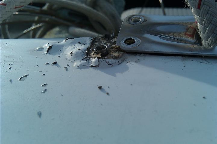

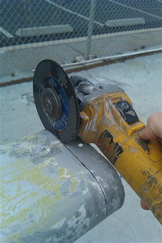

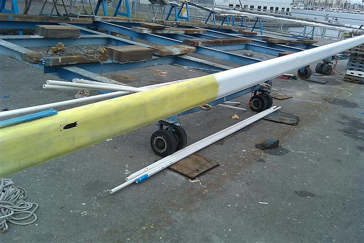

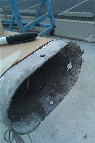

I'm attaching a few photos I took from my mast rehab. You can see inside the mast at the conduit in one. In another, note the blisters at the mast exits indicating corrosion where the dissimilar metals were reacting. Painting aluminum is not the same as fiberglass - it's a whole different process. As you can see, the corrosion at the mast step was very severe and necessitated a trim. You would not have known it was this bad from the outside, before the mast was stepped. In the last photo you can see where the loss of that bit of mast was compensated by a heavy chunk of aluminum between the mast plate and mast step.

If you removed the mast and found no internal problems, you can exhale now! I had no idea of what I was getting into when I started my project. Yes, I cut one inch off the base because of corrosion, but added a one inch chunk of solid aluminum under the step as a riser to make up for it. After 34 years perhaps some corrosion is to be expected on non-anodized aluminum.
