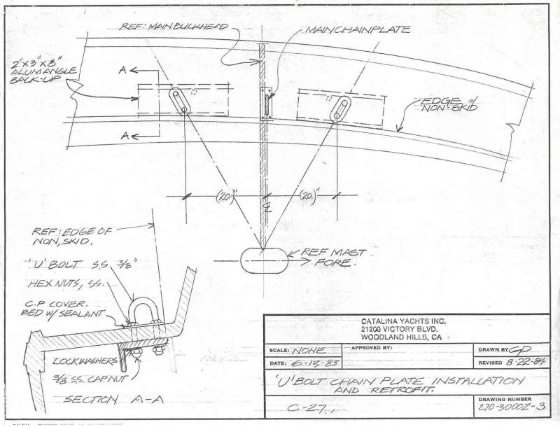

Haven't done it but see this print from Gerry Douglas. It should help with getting it right. The u-bolt is aligned axially about the mast. The edge of the u-bolt cover plate will just align with the edge of the non-skid. Referencing the center of the mast, and drawing a centerline from it through the upper chainplate, the u-bolt hole(s) adjacent to the non-skid will be drilled a distance of 20" from said centerline.
Note the print shows an angled backing plate, but I am sure that a backing plate change will not have affected the dimensions as shown.
