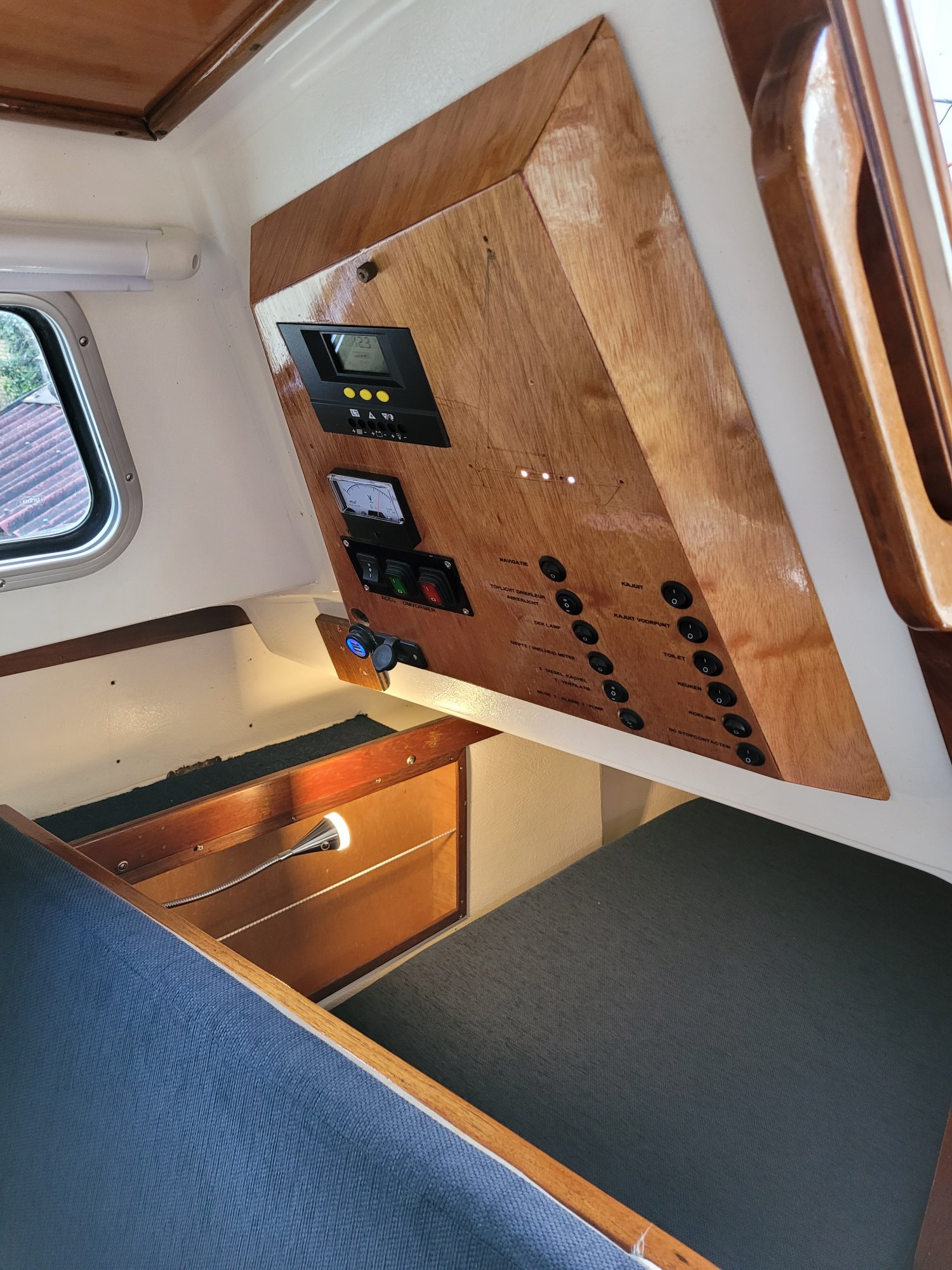

My plan to re work the wiring panel (if I ever get around to it). is to install a hinged cabinet on the starboard side bulkhead above the pilot berth. There's plenty of room for a three panel layout. Also my choice would be to keep the battery switch(s) and the hardwired smart charger near the battery box. On my dinette layout, the switchs and charger are hidden inside a built-in cabinet on the wall beneath the aft settee which houses the battery boxes in an adjacent storage area. I think the cabinet could have been factory installed. But it's perfect and I won't change it.
interesting. We've got a compass mounted there but I like that location. Would you just through bolt the cabinet to the bulkhead?
No, I'd use forstner bits to counter sink a hardwood frame with the appropriat wood screws directly to the bulkhead, which is 3/4 inch marine ply. The panels and bus bar set in the swing out section, actually a swing down might work better, bottom is wider to compensate for bulkhead angle. I too had an old bulkhead compass there, along with two other instruments that I no longer use. When removed there are three serious holes in need or filling and resurfacing. I did run across a DIY article in an old Sail Mag that gave a detailed fix. something that shouldn't be a hard search on youtube.
Each panel will be about 5' wide and 8" tall... so the box will be about 16x10.. All the chandleries sell the hardare with dimensions. There will usually offer the high end versions, with features you many not need for inside mount on a sailboat. The lesser panels will save significantly and certainy do the job. It has for well over 30 years on my boat.

Suggest that you use a few terminal strips in the old location for all wires size 10GA or smaller to extend these to your new location. Larger wires should probably be replaced and run unbroken to your new location. Remember to fuse battery wires at the battery(s) before extending those. Shorts in those wires will likely start a fire if they are not fused. Original factory boat wiring is usually a disgrace and seldom up to standards. Use only quality marine wiring and crimp terminals. Good luck.

Thanks for the suggested location. I've decided this is the right placement for me. I'll be able to fit all my controls with 200% breaker switch capacity over what I think I need. Its out of the way, its high up, its not a significantly longer run to the batteries than the original location. I've already got the cabinet built now I just have to install.
BTW, by 200% I am not talking about volts or amps (although I'm not worried about that either) I mean I can install 12 breaker switches even though I only need 6.
Actually, there's plenty of room for 3 panels side by side. The standard dimensions for the DC indoor panels are about 4.5" x 6.5" approx. So with a 16x8 case you can give your boat plenty of room for expansion.... for instance adding a USB power panel, a bayonet plug for your spotlight, gauges for battery monitoring to mention a few. Good luck... it's gonna be a fun project.

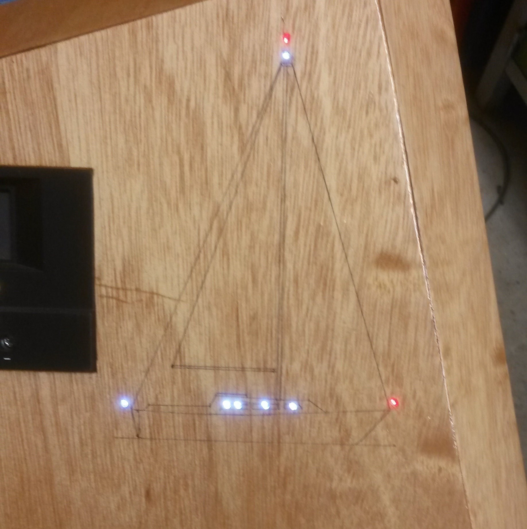

Very nicely done.
