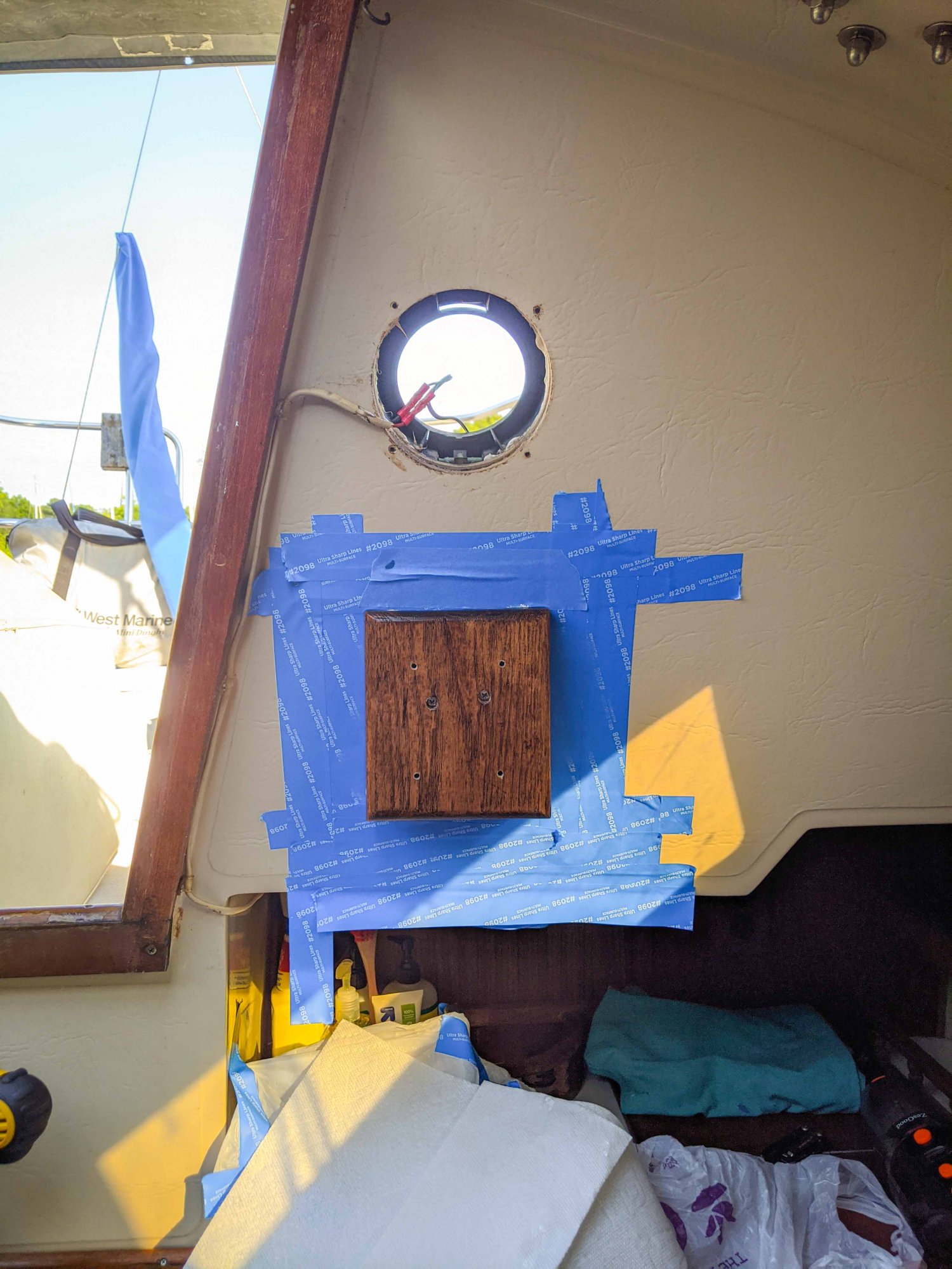

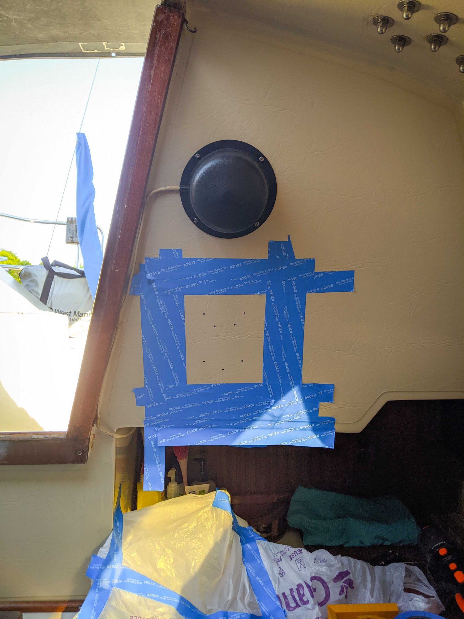

1.) Built mounting block to compensate for the bulkhead angle
2.) Marked mounting location with painters tape
3.) Drilled two pilot holes into bulkhead, with matching holes into mounting block

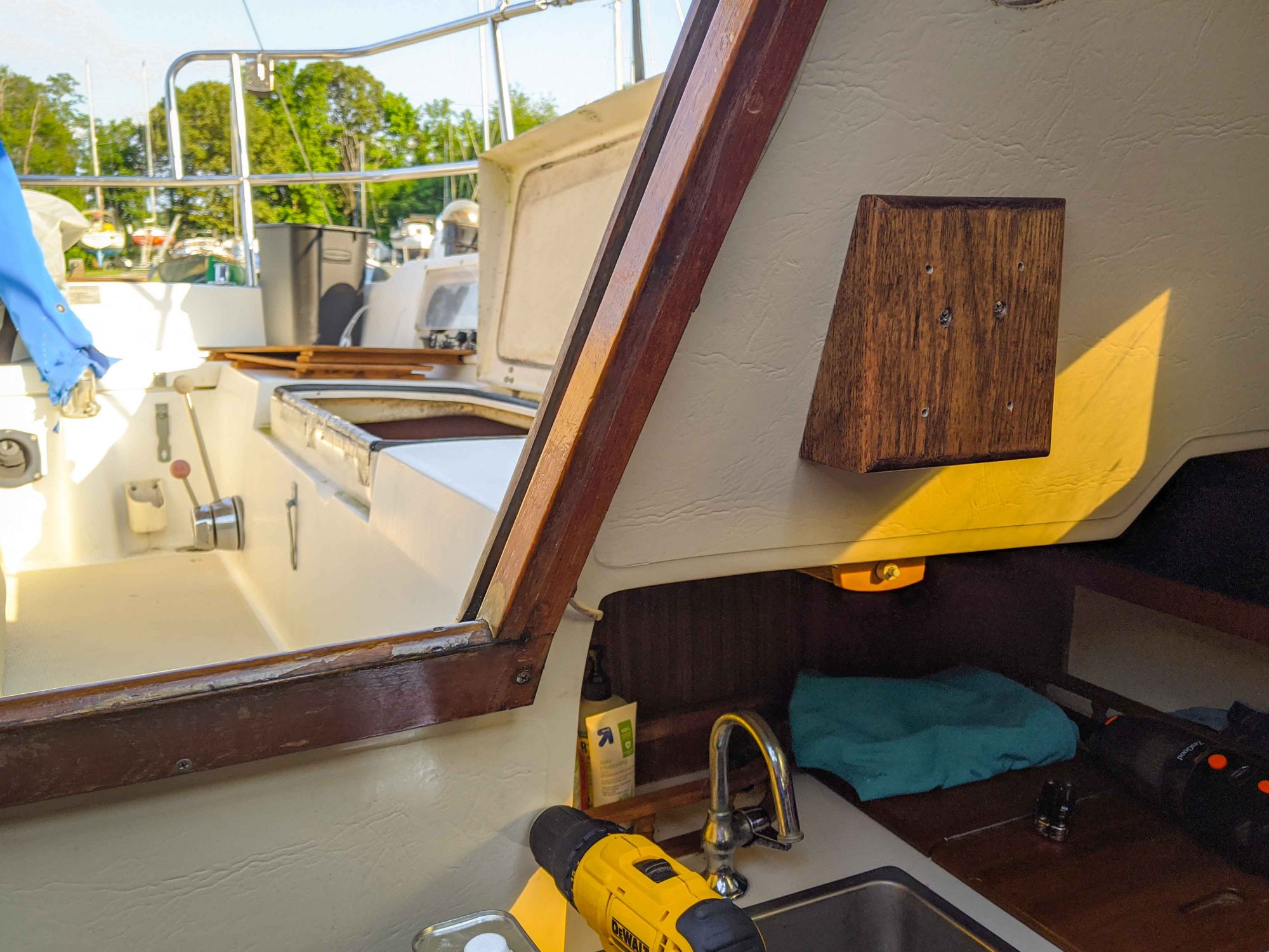

4.) Applied 4200 to the mounting surface and block, and attached the block with screws
5.) (Ideally here you let it fully cure - we couldn't wait)

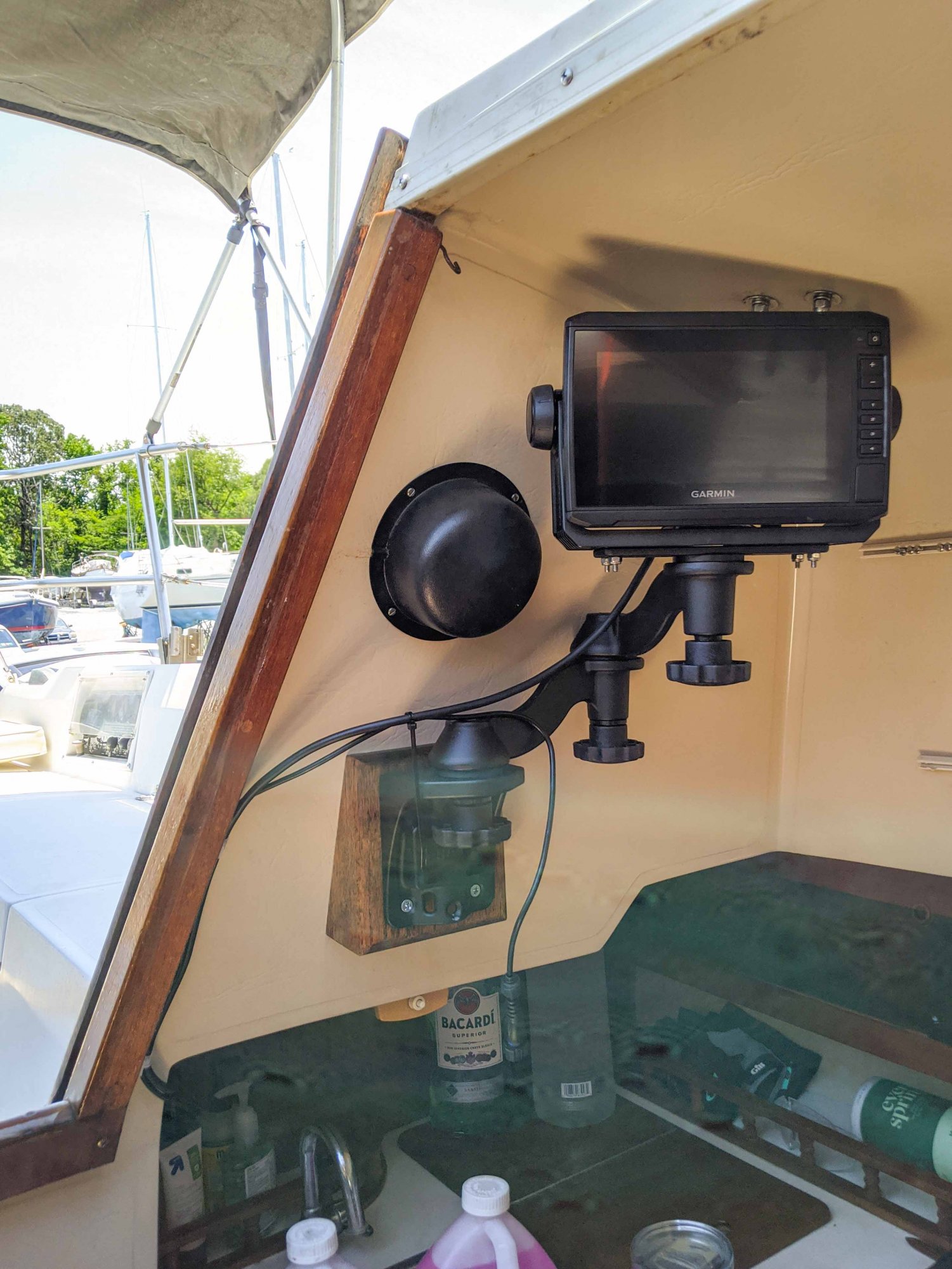

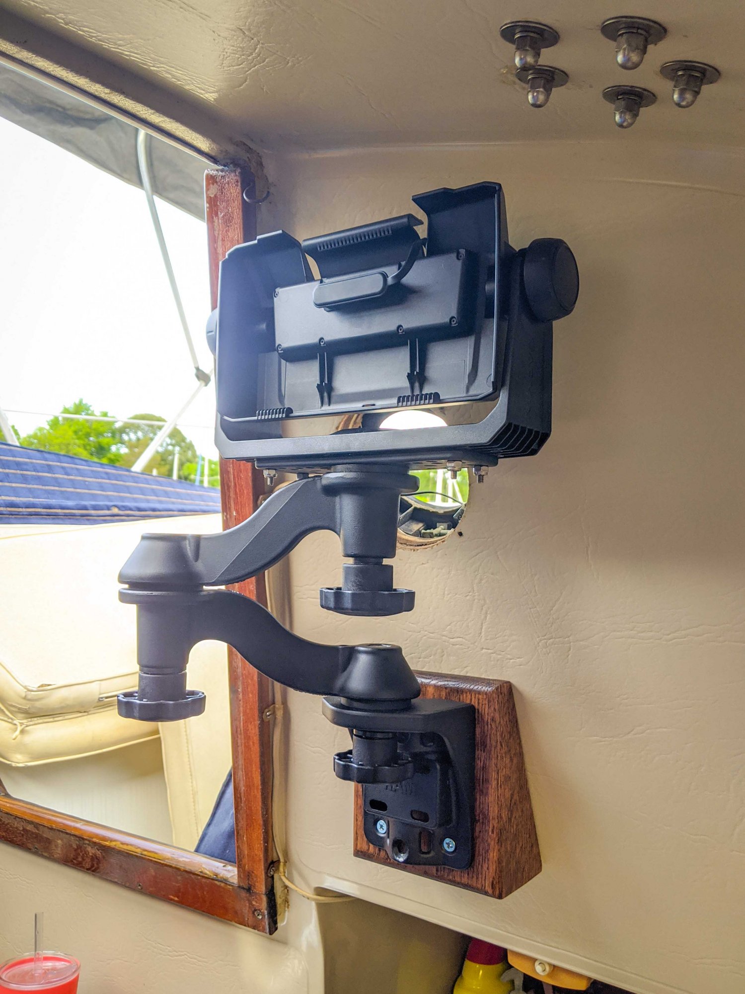

6.) Attach vertical mounting plate for RAM mount
For the mounting block, we glued 4 pieces of an oak hardwood plank together. We cut one side (the side that attaches to the bulkhead) at the same angle of the bulkhead so the arm would sit straight. We sanded and stained it to match some of the other interior trim, and then sprayed on some polyurethane.
The mounting method was the hard part given different requirements for different materials and uses, not to mention the considerations for a boat (high moisture, high-shock movement, etc.). Ideally, you'd use machine screws to go through the bulkhead and into a washer or flat backing plate or bracket. We really wanted to try and keep the outside clean, which disqualified that option. We also felt that screws that were only partially inserted would be too shallow and might not hold given the age of the boat ('85). We didn't want to rely too heavily on the bulkhead given its unknown structural integrity. This is the other reason a mounting block worked well - it gave lots of surface area for the 4200 to grab onto.
