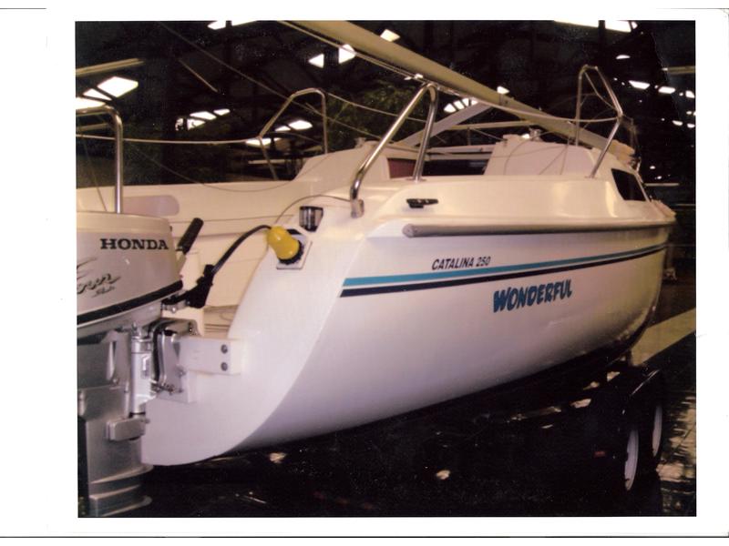

None of this is required on this boat.
The motor does not contact the rudder. Catalina carefully designed the boat for the outboard. It's not an afterthought. There's a transom opening just for access to the motor.

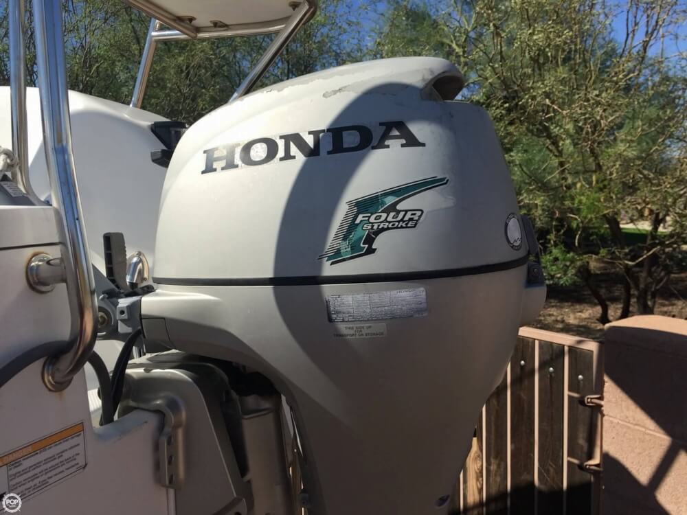

When motoring, you sit on the stbd side in front of the motor. You can just reach over and control the throttle while steering with the tiller.
See pics -from the Internet, not my boat. The closeup shows the shifter sticking up in the front of the motor.
There is no problem operating the motor as is.
