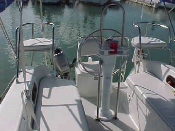

Sure it is possible but why would you? Tiller control on a smaller boat makes lots of sense. You are limited in space. So the cockpit becomes a focal point of space enjoyment. The tiller can be raised out of the way giving you and friends full use of the available space.
A wheel helm will compromise the space.
  • First there is the binnacle. It must sit somewhere in the middle so that you can stand behind it.
  • Next there is the wheel. It has to be of a size that will allow you to apply the force needed to control the rudder through the wires and pulleys that must run through the boat to the rudder. It sits behind the binnacle. You have to climb around the wheel to get to the steering position.
  • Then there is the necessary binnacle guard so you have something to grab while bouncing about in the sea.
By the time you get finished your space in the cockpit is half gone.
Look how tight the space is for this couple.

I have only sailed for 2 years mostly smaller sailboats with the tiller, plus a 28.5 foot Hunter with a wheel and a 45-foot sun Odyssey with two wheels. I am comfortable with both. With the wheel I find it convenient that I can stay in my position when changing tack and the people sitting left and right of me don't have to move when sailing, the tiller is more responsive. With the tiller I most often need to move from one side of the boat to the other when changing tack. I summary, I have a feeling that more people can sail with me on the boat if I have a wheel instead of a tiller. Am I wrong?
Actual photo of a Catalina 250 with wheel.
