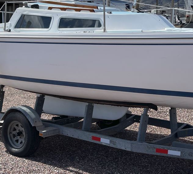

I followed your advice (danooxnard), here is a picture of the result. I think it looks pretty good. Thank you!

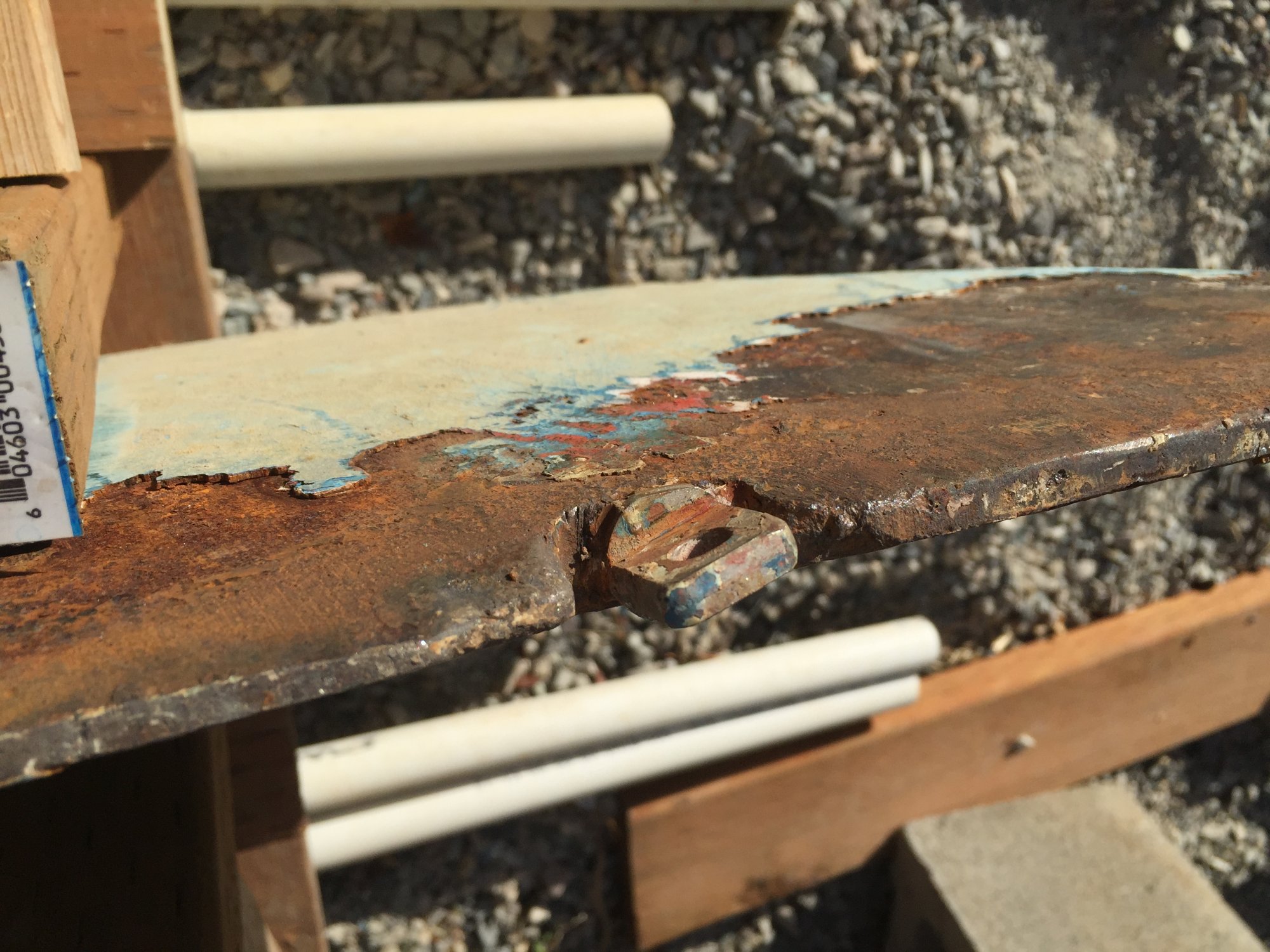

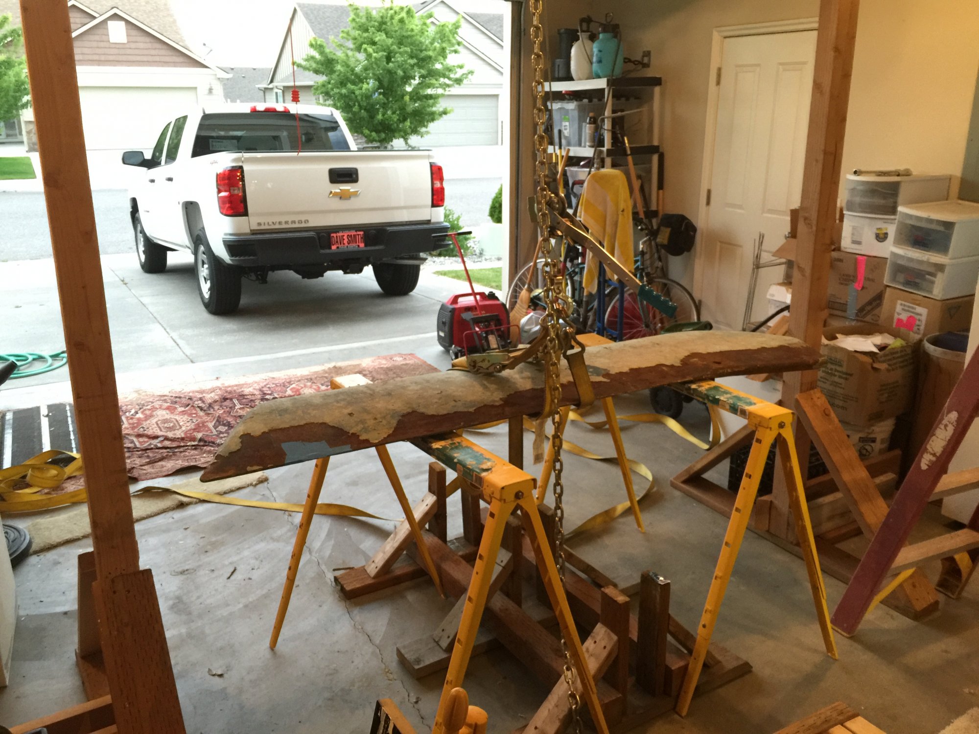

No intention of derailing the post and the sage advice-- as you proceed be cognizant of the materials. It's cast Iron -- it's rusting from the inside out regardless of what you do to it. Short of the full resto and sealing... you will be patching with some frequency. Stay on it-- perfectly viable strategy. My keel would be considered in excellent shape before I touched it.... you can see that regardless of a potentially clean exterior , complete rust magnet through and through.

Probably-- a lot of folks have done amazing things manually, but I have to admit the sandblasting routine was so worth the effort. I didn't have to grind for days on end I picked it up clean and doused it with epoxy. Even with all he extra effort I eventually put in to the keel, the sandblasting / sealing was very efficient all things considered.

My resto was a bit of an epic played out over more time than necessary. Most focused folk could probably knock it out in two weekends worth of focused effort. I had multiple projects going at once and I kept setting it aside and coming back. The gory details here:
