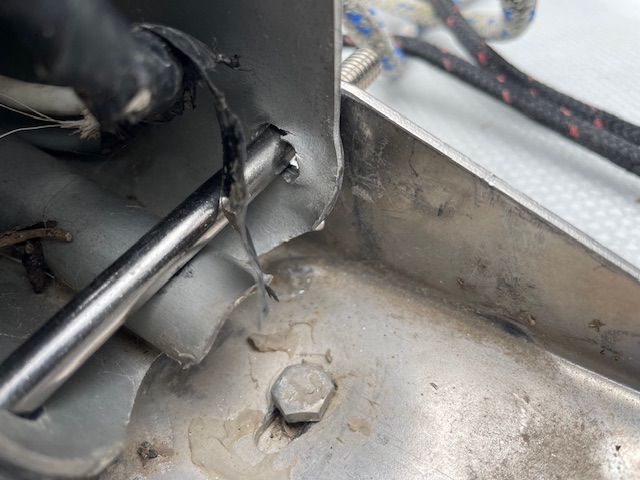

The hole for the step bolt in the mast is oval now not round the mast moves all around when stepping.
Can I bore out the hole and install a bigger bolt to eliminate oval hole?

I would not drill it larger. There is not a lot of extra metal around the hole. Pictures would help. depending on how bad it is I would not worry about it.

Oh boy! What a great first post. Welcome to the forum. I’ll respond with my initial thoughts but, I also think it would be helpful to know the year of your boat, your experience level as well as, how many times you’ve raised the mast and, how those experiences went. I often “trailer sailed” my first 1974 C-22 and never once had an issue raising the mast. I was 47 years younger and the pre-1976 mast was lighter, a combination that made mast raising on pre - 1976 boats easy peasy. Fastforward to today and on my 1988 sporting a heavier OEM mast, I found I need to employ an A frame, bridles on the port and starboard sides as well as the trailer winch to get the mast up. In the several times I’ve raised the mast on Waffle House, I have bent the step bolt once and subsequently replaced it. This was done without unstepping the mast, only removing the old bolt and installing the new Replacement bolt. The step-bolt IMO is a sacrificial part to help keep the mast in alignment when it is being raised. I cannot imagine a situation where the receiver hole in the mast is elongated. I would not enlarge it until we know more about your specific situation. Once the mast is raised, there should be zero stress on the mast step bolt and its connection to the mast step plate.

It might be better to fill the opening with epoxygoop (add fibers for strength) and then re-drill it for the original bolt size. If the step is aluminum you might also be able to get a welder to add material and then re-drill that - but ask them about how strong that would be - the heat might weaken the whole casting. A photo would help people see what we're dealing with.

The mast step on a C-22 is an inexpensive stainless steel plate available from Catalina Direct in both the older and newer designs. Unless I’m mistaken, the OP is referring to the hole drilled in the mast to insert the mast step up bolt which passes through the mast step. The elongation of the hole in the mast itself should have never occurred under normal circumstances and was why I asked the questions in my response to the OP.

I just bought the boat it is a 1989 and I have 0 experience stepping the mast.
The step plate holes are fine the elongated hole is on the mast.
I am hoping to take to a professional welder and have him weld a 5/16 aluminum washer on the inside of the mast
Not how I intended to start out.

It looks to me like the mast may have been moved or pushed before the bolt was properly inserted and fastened to the mast step and the process was stopped before further damage to the mast occurred. The purpose of the hole does it keep the bottom of the mast in the mast step while raising and positioned while sailing. If you wanted to do a repair you could simply wrap the mast at that location with an appropriate thickness of aluminum sheet with a nice smooth bolt hole to keep the butt of the mast in place while raising it.

Personally I wouldn't care.
Ours was also slightly ovaled, even though it had already been reinforced with a sleeve at some point.
That bolt functions as a pivot pin and holds the mast in position while it is being raised.
Once the mast is raised and the standing rigging attached and tensioned correctly.. the pressure is downwards onto the mast step. At that point the bolt stops the bottom.of the mast from moving forward or back. The oval shape you have there won't affect that because it's not in that direction.
At no point did I ever have that bolt tight. I used a stainless nylock nut so the nut wouldn't easily vibrate off.

Thank You just to be safe I took it to a professional welder he is filling in the hole and then re drilling it
