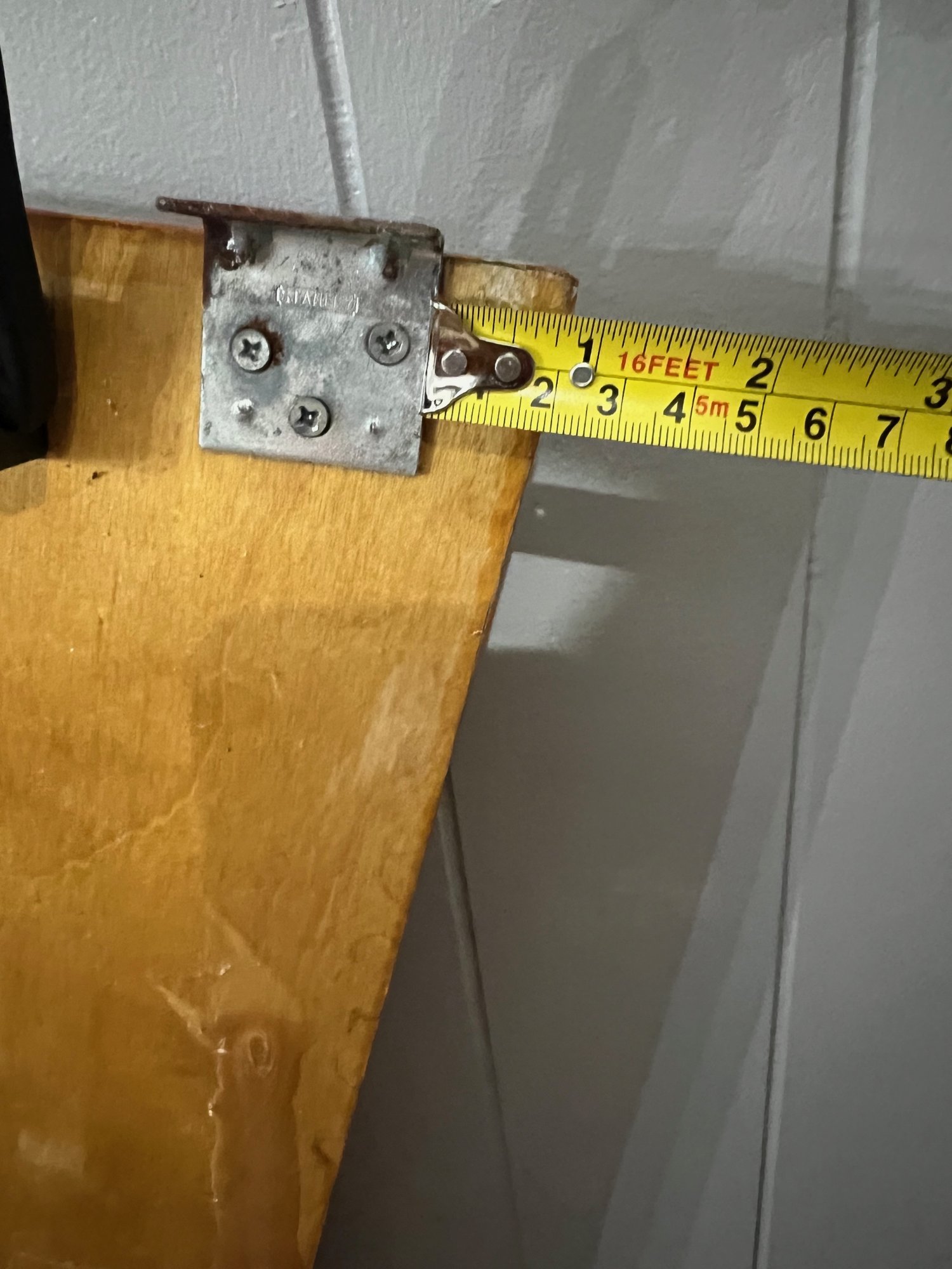

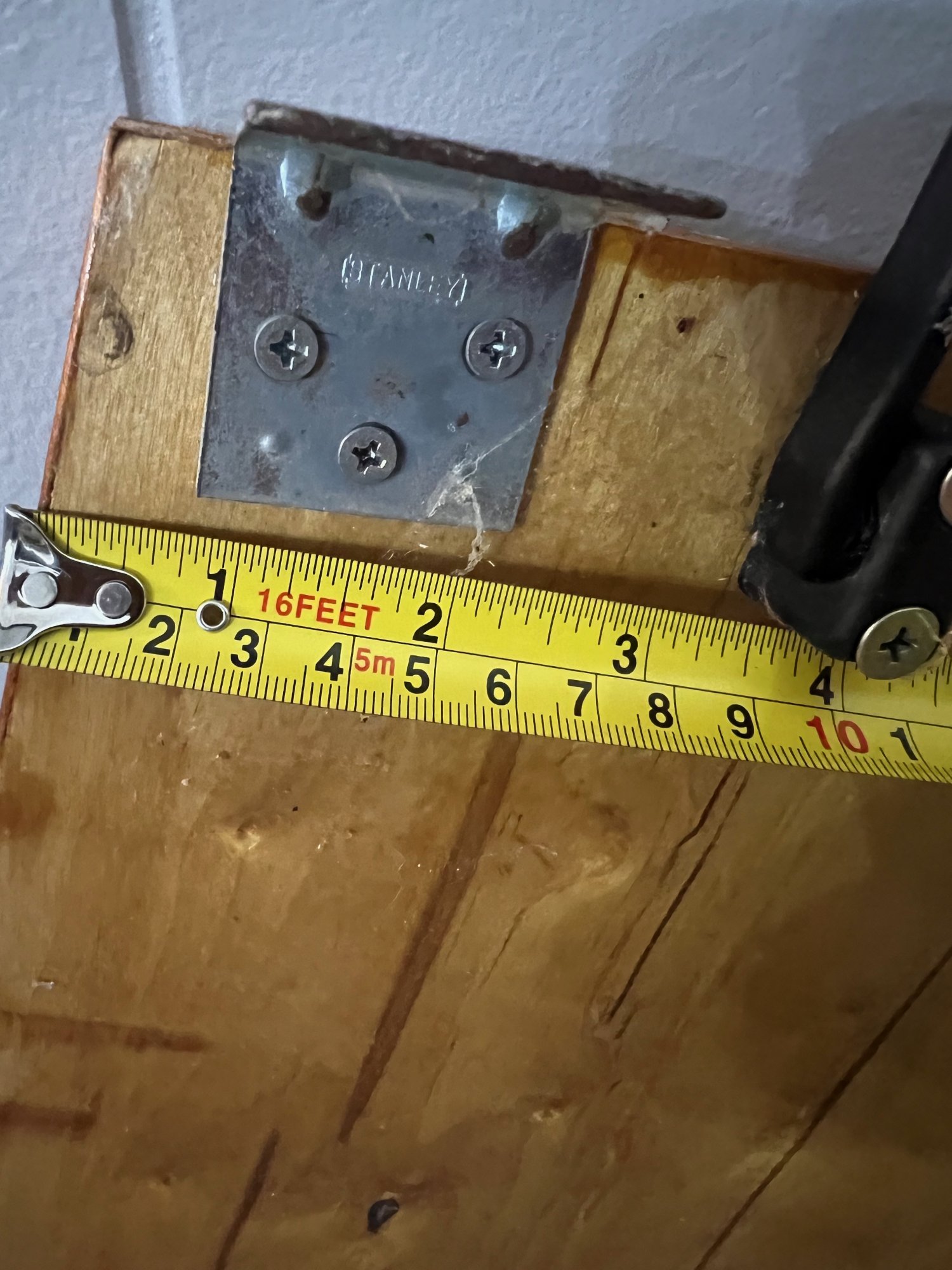

Apr 29, 2025
2
Catalina Catalina 22 (1986) Southside, AL
Have a 1986 Catalina 22 New Design that I purchased last fall. Unfortunately the boat is missing its dinette table. Does anyone have the dimensions for the table? Thankfully the previous owner still had all the hardware for it (just not the tabletop).
Thanks!
Chip
I have an 1986 and am fabricating a new one (40yrs old and only one little area of delam). There is not a right angle (welcome to boat projects) and all the corners are rounded (thankfully)
Best measurements 24" at the mounting edge (get the rubber latches from CD)
Long edge (fwd) 39"
Short edge (aft) 34"
Non-mounting edge 25 1/4"
Likes: chipmonger

If you don't get it worked out I can make a cardboard template from mine. I have the original table. 1988
If you could trace it out on Kraft paper, put it in a tube and mail it, I'd gladly pay for postage plus a bit extra for your time.
