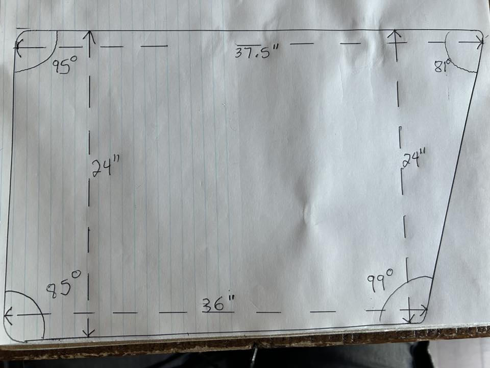

Have a 1986 Catalina 22 New Design that I purchased last fall. Unfortunately the boat is missing its dinette table. Does anyone have the dimensions for the table? Thankfully the previous owner still had all the hardware for it (just not the tabletop).
Thanks!
Chip

I had some 1/2" MDO plywood sitting around so I took two pieces I rough cut to size and glued them together. Then cut to final size and sanded/filled as needed (Home Depot MDO had gaps in the plywood). I've getting ready to test fit the hardware before sealing and painting. I'll probably countersink the bolts rather than rely on wood screws for added strength and fill in the heads.
I saw the same video but just going to go with the original design. I can always experiment in the off season. I haven't had the time I thought I would this year with the boat due to other commitments. July's nearly over, still other projects to do until she's in the water, and had a paid slip for the season until end of October.
Chip

Ive been using a small table for awhile. What's kinda neat is that at least with the new design, the original table fits on the traveler making a cockpit table. No adjustment of the table leg needed. I have a lot more space in the cabin with the smaller table. I used a 24" cutting board I got off amazon.
