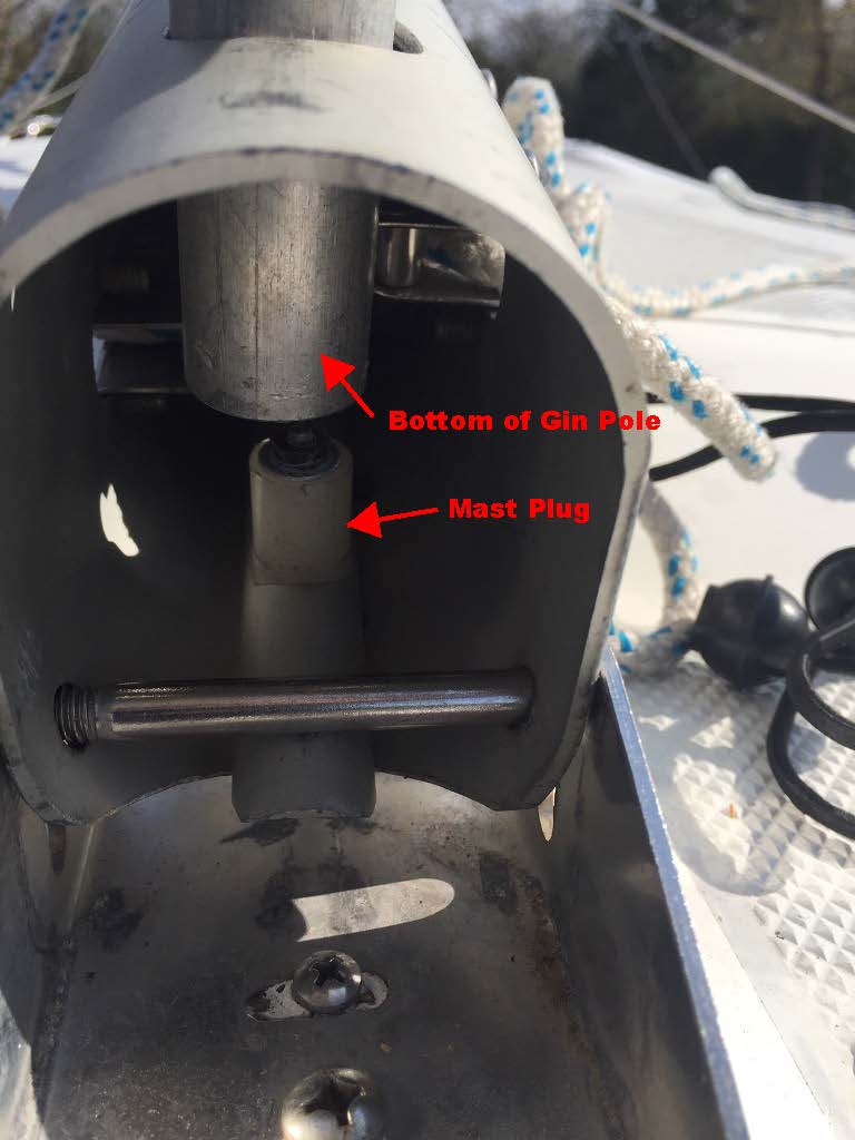

Just purchased a "new to me" 2002 Catalina 22 MkII. Came with the factory supplied mast raising system that includes a gin pole, baby stays and all the block n' tackle. It appears however that I'm missing the "bushing" located inside the mast which the gin pole slides onto once inserted into the hole near the bottom of the mast. Does anyone by chance have a picture of that "bushing" so I can fabricate one if Catalina Direct doesn't supply?

As a follow-up...Catalina Direct has the nylon "plug" which is thru bolted to the inside of the mast and the gin pole then slides on to it in order to stabilize the base of the gin pole while in operation. The part is not listed or shown on the CD website but the part # is Z3390 for $6.20. I'll post photos once I'm able to take some....

Thought I'd update with a photo of the nylon "plug" or "stud" utilized with the MkII mast raising system. This was the part that I was missing and was able to purchase from Catalina Direct (part #Z3390). The bottom of the gin pole slides down over the stud which provides it with a rigid base while in operation. The photo shows the bottom of the gin pole raised up off the stud for explanation purposes.
I must say...the MkII mast raising system has worked like a charm. I can easily raise and lower the mast single handed with no stress or struggles. Kuddo's to Catalina on design. Don't know enough as to why they stopped providing but assume liabilities from operator improper setup and use was a big reasoning. :wahwah:
