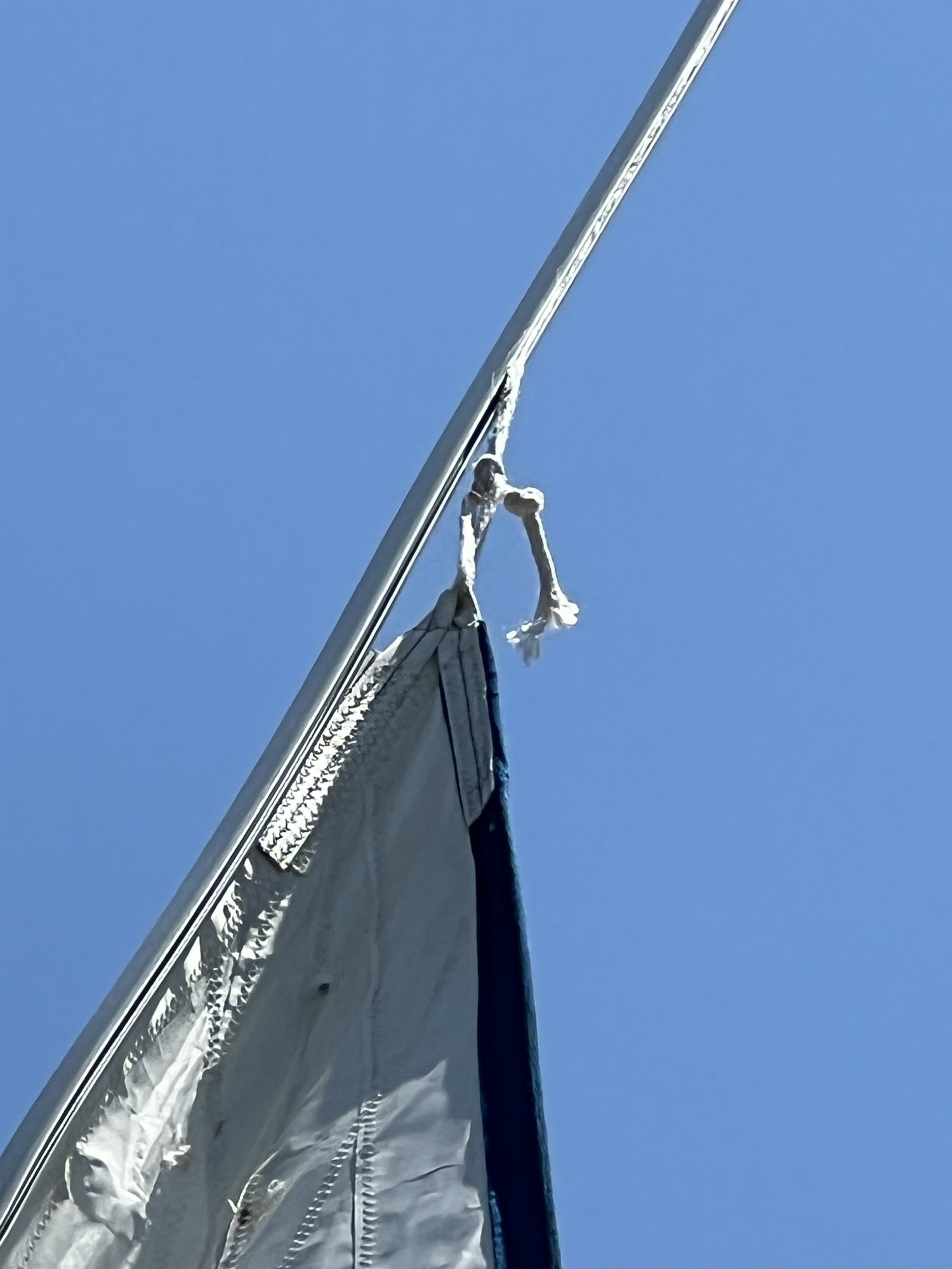

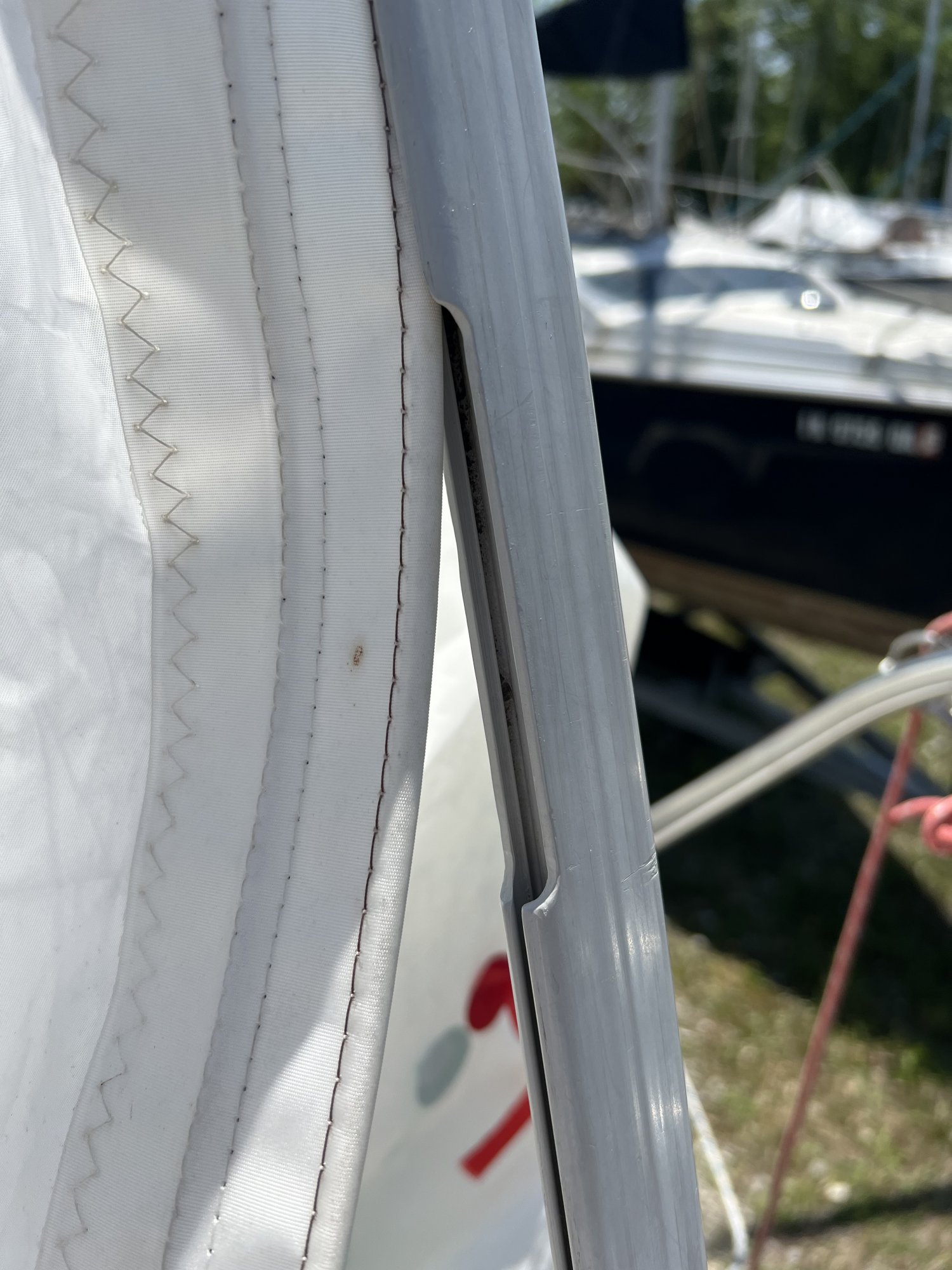

I have this problem every year. I always figure it out and then forget- why is the job getting stuck? This is the highest I’ve gotten it up and something is clearly wrong.

Don't feed the halyard into the luff extrusion slot of the furling foil. Only the luff tape of the sail. Also, make sure there is a well tied knot at the head of the sail if you're not using a shackle. A bowline can be untied after being under tension. That will be important if you change headsails regularly. Keep the knot small so that it doesn't interfere with the upper swivel of the furling system.

As stated, the halyard should not be in the slot in the foil. Let it hang outside of the slot. Just feed the sail luff tape in the slot. And get some dry silicone spray or Sailkote to spray in the slot.

As others have said the halyard should not be in the slot. What is concerning is how the halyard got in the slot. If the slot has become wide enough to accept the halyard, then it will likely be too wide to hold the luff tape in the slot. Also the halyard looks pretty frayed and the head has a twist in it.
It may be necessary to drop the mast to get the halyard out of the slot. while the mast is down, replacing the halyard would be a good idea.

Where is the swivel that should be attached to the head of the sail? The halyard should be attached to the swivel and not the sail.

I don't think you have the FLEX furler. Looks like two extrduded aluminum channels in the foil/luff. The halyard terminates in a "traveler" that runs in the channel opposite the luff tape - refer to attached instructions. When the sail is up, the traveler comes near the the feed point, but not far enough that it wanders out of the channel.

The extrusions on this generation of CDI products do not join. The extrusions simply stack on one another. At the joint there are two internal aluminum links that are intended to keep the extrsions from twinsting and align the channels. IF there is ANY misalignment the traveler (black plastic piece at the terminus of halyard) can be tough pull down in its channel while the sail is being hoisted and the luff tape can also bind. I have had the aluminum lnks bend resulting in misalignment. Also had the links slide down so far that there was no engagement with the upper extrusion. Only fix is to drop the mast if this happens. After it happened to me, tip from Rudy at D & R Marine - drill hole on each side of the extrusion a couple inches below the joint and insert a rivet, so the link can't wander.

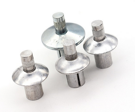

Use a drive pin rivet. These can be removed by driving the pin further in with a punch or drill bit. Once this is done you can wiggle it out with the same tool. Using a drill bit to remove a rivet will result in a larger hole in your furler extrusion. Pop rivets can only be removed with a drill bit and the pin doesn't always come out cleanly when you install it which would lead to holes in your sail. The drive pin rivets are used on Hood furlers and are by easy to install, remove and have always produced and smooth edge
