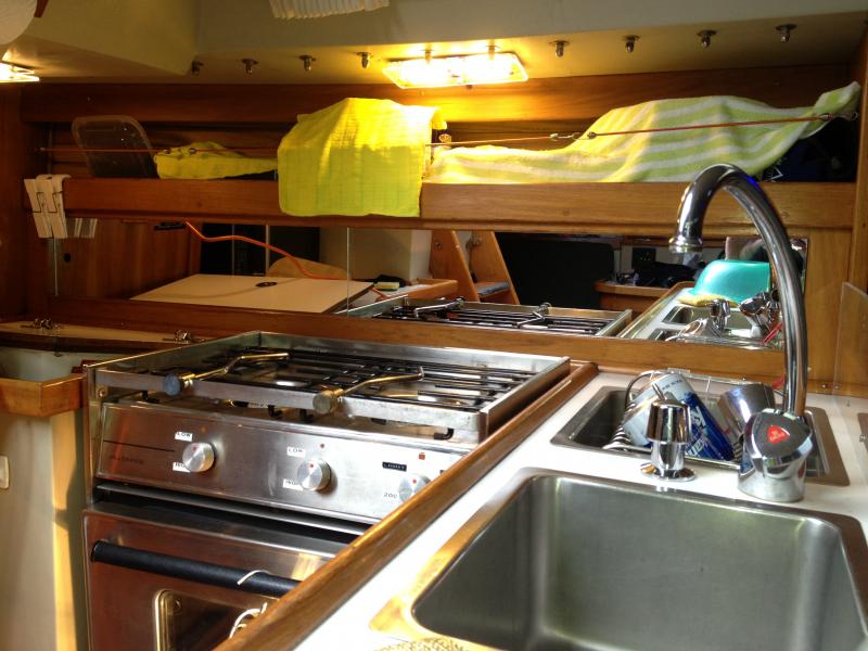

By the way, if you need to replace the faucet, I used the Ikea Edsvik one. It was only $80 and has the single hole to replace the original one. And you can exchange the hot and cold labels when you hook them up backwards!
http://www.ikea.com/ca/en/images/pr...trol-kitchen-mixer-tap__21801_PE097161_S4.jpg
The Moen Renzo faucet is the one Catalina is using in the new boats (or pretty close). It's a one or three hole install with an adapter. $109 at Lowes, I picked one up for $79 on sale.
http://www.lowes.com/pd_231738-866-CA87316C_0__?productId=3118583&Ntt=moen+renza&pl=1¤tURL=%3FNtt%3Dmoen%2Brenza&facetInfo=

You piqued my curiosity. The negative comments all have to do with the attachment for the pull out so I just took a look (it's sitting on my desk, haven't gotten it installed yet).
The pullout has plastic threads, and the braided steel line feeding it has metal threads. My guess is either over-torquing the metal nut onto the plastic threads or neglecting to use teflon tape to get a good seal - both problems I've seen with metal to plastic threads in the past.
I bought this model because the wife liked the faucets on the new boats and I've had good luck with Moen products in the past. The fact that it was on sale was a plus. I'll let you know in the spring how it works out :D

Jim,
I've had that facet in my boat for three seasons with no issues. It looks great. You won't be pulling the head out as the sinks are very small. I think I might have extended it a half a dozen times to rinse with. The problem is the hose is quite long, you could almost shower with it. I know you have that nice tile backstop which might help with the over spray :).
I'd do it again.
