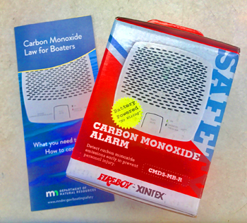

Are conventional "home" CO detectors acceptable for marine use? I ask because the "FIREBOY-XINTEX Battery Operated Marine Carbon Monoxide Detector" at West Marine is $120. The "First Alert Battery-Operated Carbon Monoxide Detector" at Lowes is $18. Might pick up 3 of the latter today, and try them out.
- oh, wait, I think I need four: Catalina 36, forward cabin, head, galley area, and aft cabin. Is that right?

The hardwired versions are only $99 at Defender. Not sure if the home CO detectors are suitable for marine use. They'll probably detect CO, but the salt air may shorten their life.
Absent legal requirements to put one every where, logic may prevail. What are the likely sources of CO on your boat? Put the CO detectors near the source. If the only sources are the diesel and the propane stove, it doesn't make much sense to put a CO detector in the V-berth, but does make sense to put one near the engine compartment and near the stove.

Not according to the MN law. Has to be Marine.

Residential CO detectors are not the same. Perhaps better than nothing, but not as good as marine CO detectors for two reasons.
First, marine detectors are built to withstand the marine environment... Temperature swings, humidity, vibration, etc.
Second, residential detectors have a different profile programmed. Marine detectors are programmed to allow brief spikes in carbon monoxide levels without alarming whereas residential units are more sensitive to lower levels.
Do it right. Get the proper tool for the task at hand.

Can you provide a reference for this, please?
Certainly, but a Google search would find the same info. I googled "residential vs. marine carbon monoxide detectors" and here are excerpts from three of the top five results.
http://www.boatingmag.com/gear/carbon-monoxide-alarms
"First, avoid residential alarms. While marine units may be more expensive, they are built to withstand the rigors of a marine environment. "​
http://sailingmagazine.net/article-899-can-i-use-any-carbon-monoxide-detector-.html
"There is a difference between the behavior of marine and residential carbon monoxide detectors because the presence of carbon monoxide means different things in either environment. Typically, the carbon monoxide level in a house is very low, and should never get any higher. If the level rises, it means there is a faulty combustion device (stove, furnace, dryer, etc) in the house and the occupants need to be alerted immediately. In a boat, it is acceptable for the carbon monoxide level to spike but only for short periods of time."​
https://southernboating.com/engine-upkeep/systems/carbon-monoxide-detectors/
"The first impulse for many boat owners is to purchase residential-type units, but be aware that some may not meet construction requirements for marine-grade units (such as Underwriters Laboratories standard 1524)."​
In the end, the choice, and the risk, are yours.

Note that West Marine has Fireboy - Xintex CO detectors on sale this weekend for $99.99. Model CMD5-MB is the internal battery version. Nope, I have no affiliation with West Marine, just passing this on for your info.
