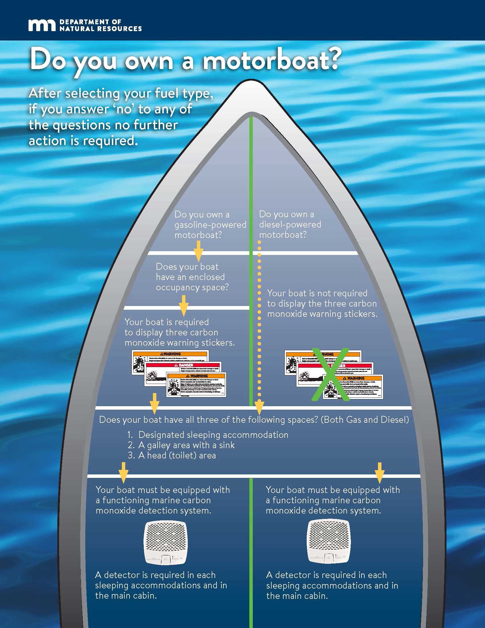

What's the definition of a "motorboat?
A boat with a motor. Gas OB to diesel IB, it does not matter. If your boat has a motor, you are a motorboat. Here is the MN law, sticker portion in effect now. Monitor(s) by next April.
The law applies to any motorboat, with the spaces defined above, operating on Minnesota waters. This includes the Minnesota side of border waters and federal waters within the state. A motorboat includes sailboats with motors and documented boats.

Did you see that the law now doesn't take effect until next year? I've heard it has to do with availability of battery powered CO detectors.
Yep, plus that $100+ price tag. I found some online for around $87 though so..... Being a "yacht owner" I guess I should be able to afford those....
Nov 8, 2010
11,386
One? You need two.
Motorboats, regardless of fuel type, must have a functioning marine CO detector if they have an enclosed accommodation compartment, which is defined as a motorboat with all of the following:
  1. Designated sleeping accommodations
  2. A galley area with a sink
  3. A head (toilet) compartment
Enclosed occupancy compartment is defined as:
One contiguous space surrounded by boat structure that may be occupied by a person
If your boat just has an occupancy compartment you are not required by law to have a CO detector in the space, however, it is highly recommended for the safety of all passengers that a detector be placed in any enclosed compartment.
A detector is required in each of the sleeping quarters and in the main cabin area per the American Boat and Yacht Council A-24 Standard. Supplementing with additional low level CO monitors will alert passengers sooner of the presence of carbon monoxide which can be harmful at low levels/under 30ppm.

One? You need two.
I was wondering if the berth under the cockpit qualified as a different space..... even better. So do you need 3 then as the head area between the main salon and the v-berth is technically enclosed as well?
Nov 8, 2010
11,386
No, just 2. Look at the sticker.
