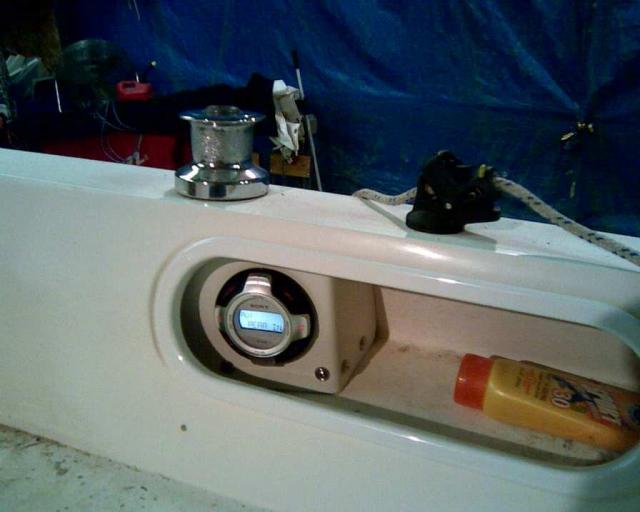

There are two Sony models that are marine ready, and have the now-becoming-standard USB connection for connection of either iPod or a flash drive. The CDX-H910UI is the top-of-the-line model and is hermetically sealed when mounted and closed; so much so that you can hose it down.
http://www.sonystyle.com/webapp/wcs/stores/servlet/ProductDisplay?catalogId=10551&storeId=10151&langId=-1&productId=8198552921665801240
The CDX-M60UI is a marine radio with the same USB/iPod interface. It is styled along the lines of a more traditional car stereo.
http://www.sonystyle.com/webapp/wcs/stores/servlet/ProductDisplay?catalogId=10551&storeId=10151&langId=-1&productId=8198552921665801217
Both feature conformal-coated circuit boards for improved resistance to salt fog and spray. Both can be controlled by optional wired remotes. Hard wired remotes might be a pain, but they are the best for ensuring a solid reliable communication between the radio and the remote. The RMX-55M is a large backlit remote with a digital readout. It was designed to fit exactly into a standard 3" gage hole. The RMX-11M has no readout, but has all basic controls on it. It fits a standard 2" gage hole.
I do not work for Sony but do earn my living designing and selling Marine Audio systems. I use Sony and have had good luck with their product.
Here is a pic of my newly installed RMX-55M in the starboard cockpit coaming in my Catalina 22
