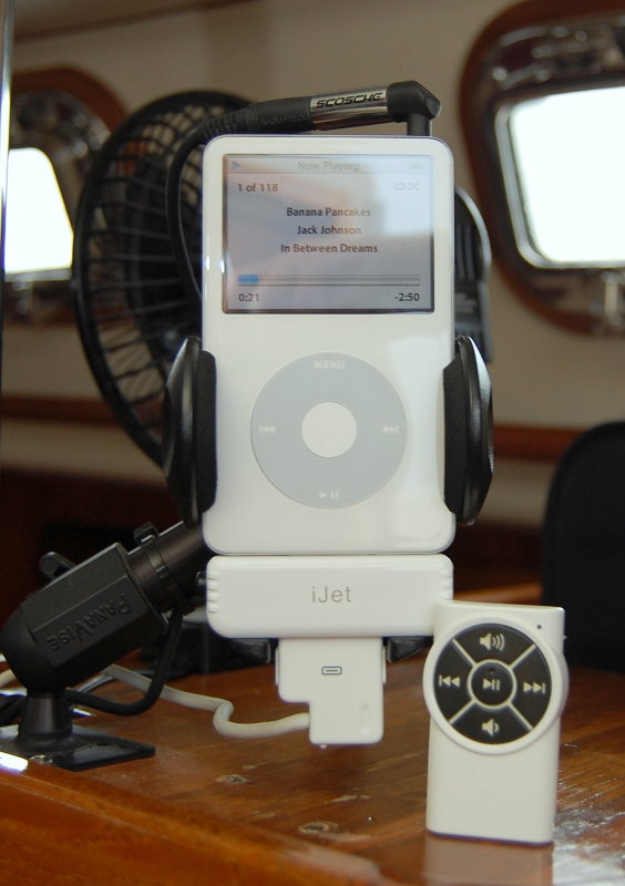

The only ones I know of are infrared or hard wired (pita). Another option is to get an iPod and an ABT iJet RF remote control. The remote itself is water resistant and will work up to 150 feet away..
ABT iJet (LINK)
Image courtesy ABT Tech

The only issues with the Dock-interface remotes is most will prevent you from charging the iPod while the remote is in use. :)

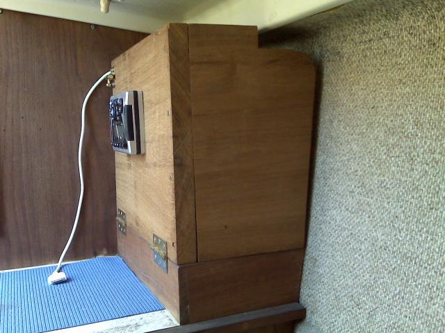

I have an O'day 28, and did exactly what you are proposing. However, the guy who owned it before me did a drop down case with four screws in the ceiling, which put the screws through the deck. Not a great idea. So I built a box in top of the little teak box in the back, put some hinges on it and put the unit on the back with the face on the front. It flips down to work on, and is all out of sight except the control head when latched up. I can send you pics if you like. Anyway, the stereo I bought from WM has Ipod and Sirius and all that, as well as you can run a waterproof remote control all the way back to the cockpit, and have complete control right next to the wheel. Then you don't have to worry about throwing the little remote into the water accidentally like I ALWAYS do.....

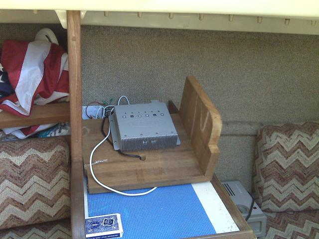

There is, but not as much as you might think. And with a hanger you want to be sure it's secure, and the previous owner put 1.5" inch screws and popped one through, just barely. the rest were halfway in, and the hanger was sitting down on the heads of the half screwed in screws. I'm on the road on business, but I will get you some pictures of what I did, and it works really well and I didn't have to worry about holes in the deck or working on the stereo.

Here is the little project I did for my radio. I am in the process of moving my VHF radio to the bottom of this box, but the sailing season got in my way. It has worked well for me, made it out of teak so it matches, and I can store stuff in the back and have access for all the wires. When I get a Sirius module there will be room for it too! I also will run the waterproof remote back to the cockpit this year, and it wires down to the bottom of the boat and back to the cockpit and right next to the depth/knot meter. It didn't take too long to do, and used a dremmel to shave it off and get it to fit. If you have any questions contact me.
