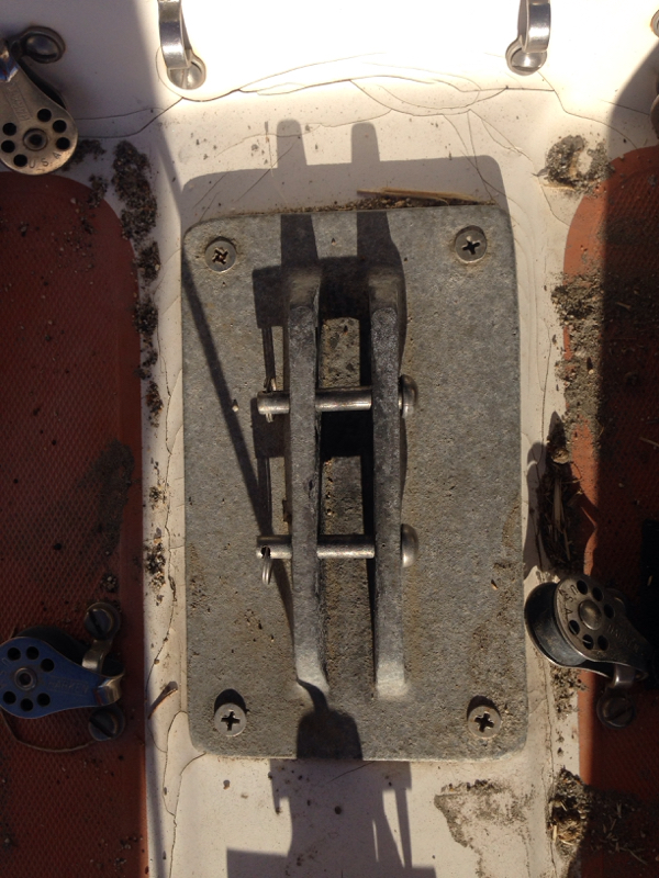

I bought a 1977 Capri Coronado 15. Was wondering about how to step mast. It appears that the stepping plate inside the boat should have two pins for the mast to sit on. (mine only has one) Am I right or wrong...does it only require one pin?

Hi! I just purchased a 1972 model myself in the spring. I will take a picture the plate tomorrow- but, yes, it is two pins.

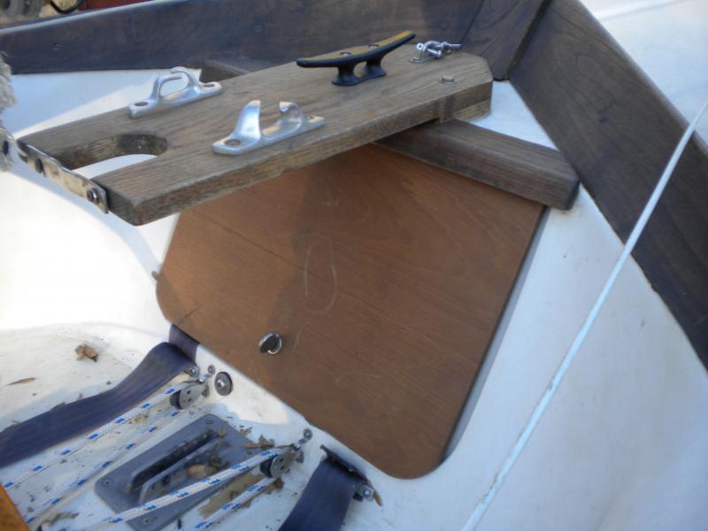

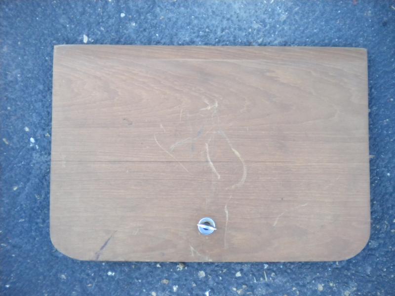

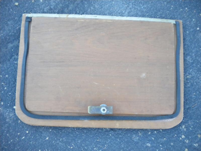

My cuddy is sealed with a formed piece of teak that includes a turn lock at bottom to hold in place. Would be more than happy to take pictures and send so you can see what i mean. (a picture is worth a thousand words!)

Find enclosed pics of cuddy cover. one, cuddy attached to boat, two front side, and three.. back side of cuddy cover with latch. Is it factory??? Or homemade??? Hope this is helpful to you. A cover could be made easily if at all handy with wood. Do your own thing...See attached files to veiw pics...

Sorry for the delay. This is the step plate with two pins on my boat. Hoping to get out next week and enjoy more of our Southern California weather. Got sidelined by a surgery for a bit there but I think I'm up to it again.

Thanks for the photo. This makes more sense to me. Thinking the guy I bought the bought from was sailing with only one pin. He told me the boat didn't sail very well just on the mainsail..with jib up much better. Maybe the one pin method had something to do with it!

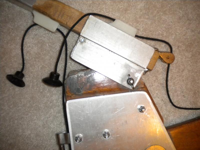

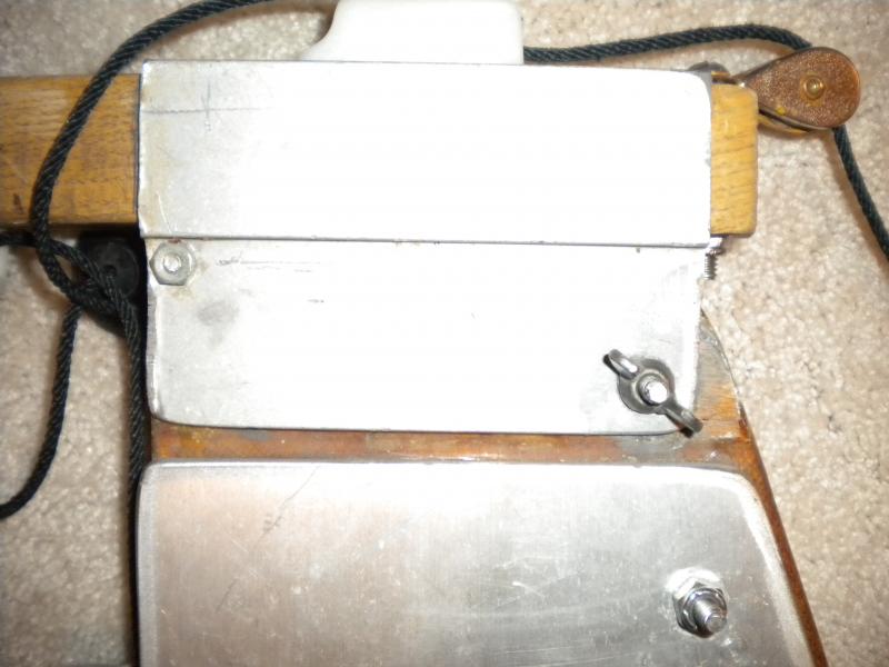

Do you recall how the tiller is fastened to the rudder head? A screw? A locking pin? My factory bought tiller has a very thin hole at the end but it seems too thin to be practical...? Thanks! Keep warm! I was born and raised in Chicago but fear my blood has thinned out quite a bit to tolerate the snow.

Hey!
Hopefully attached photos's will help. The hole you're I think you're talking about is just a pivot hole so rudder is free to move up and down (north and south wise)
As photo's show...mine is attached with a looks to be a 3/16 diameter round headed bolt (3.0" long) with a wing nut to adjust tension of movement up and down.
I can take more photo's if this doesn't explain it well. Let me know.
-B
