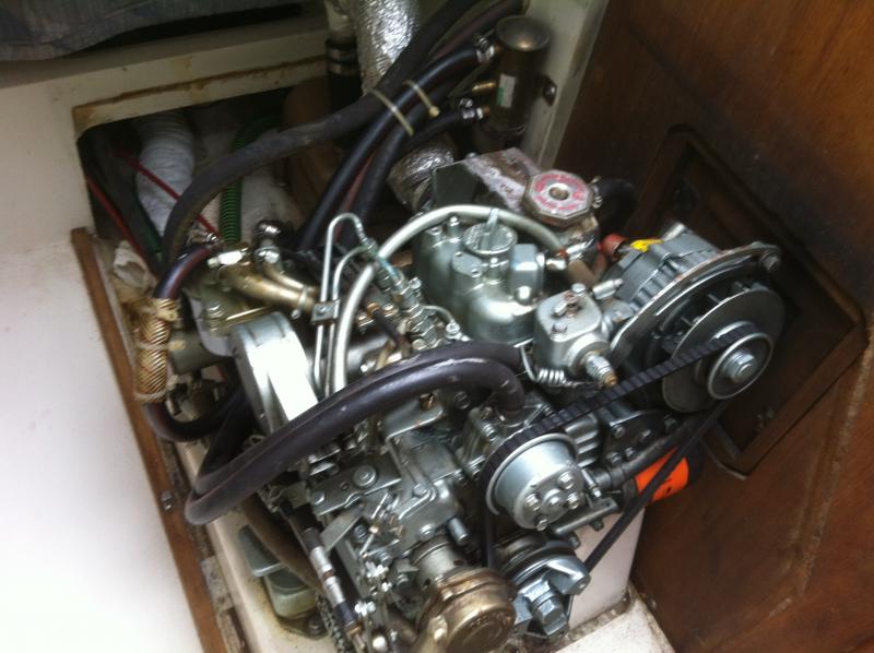

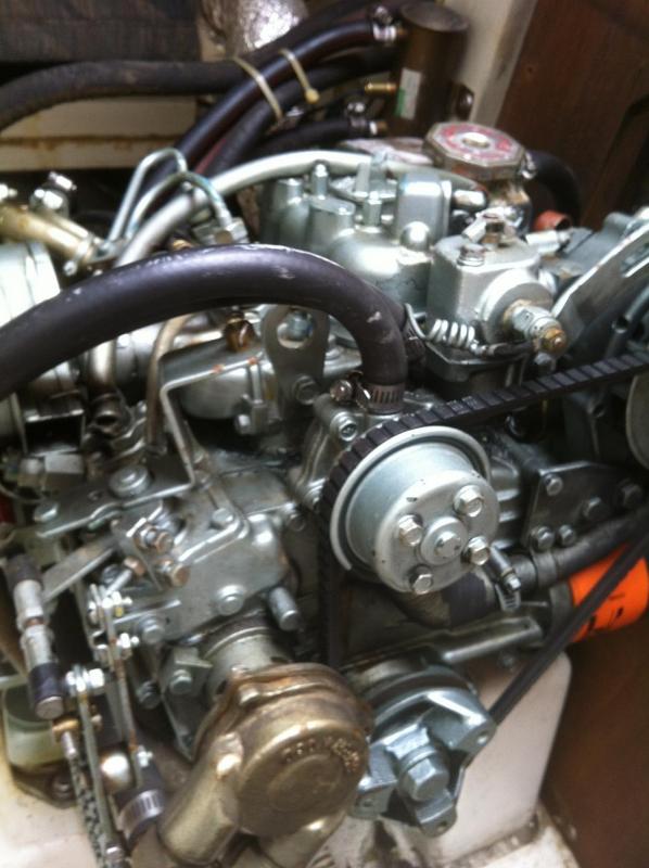

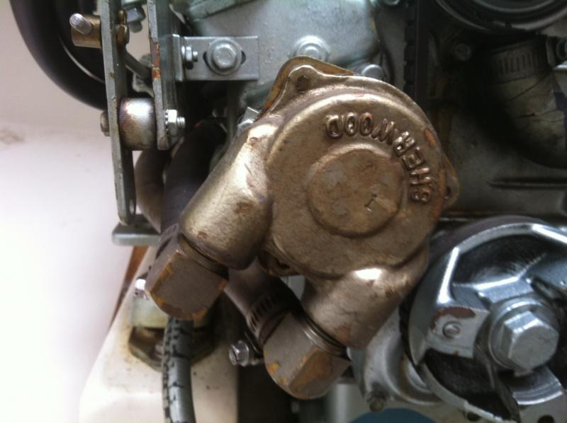

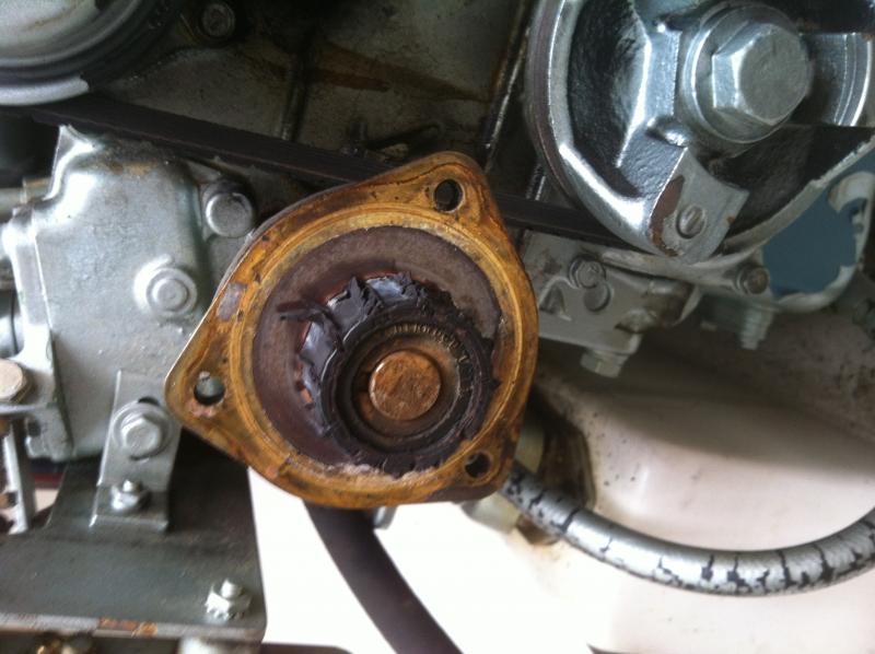

The next day I returned to begin the troubleshooting. After looking through the owners manual it appeared the usual cause of overheating on this particular engine was impeller failure on the water pump, which is located in a housing on the front slightly starboard side of the engine. see photos.

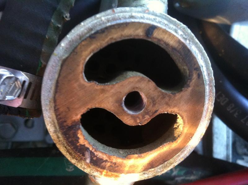

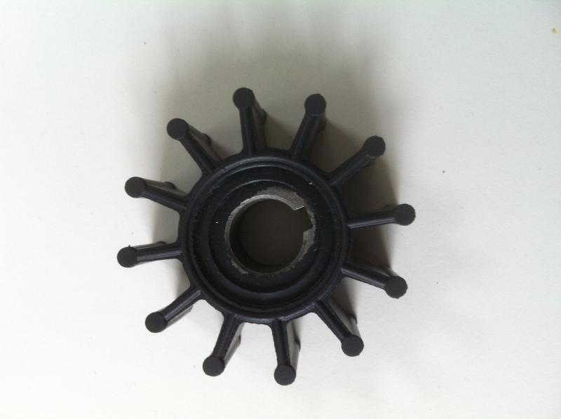

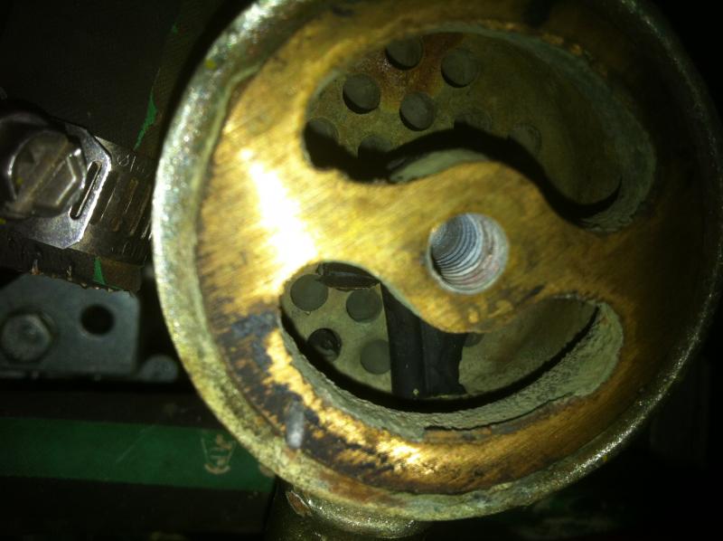

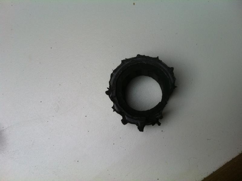

Upon opening the water pump cover I was amazed to see what was left of the impeller, it looked like a rounded melted ball of rubber. Closer inspection revealed that the impeller pieces had broken off, and the smaller pieces proceeded up the entire cooling intake hose, into the heat exchange canister., Other pieces had managed some how to flow down the intake hose all the way to the thru hull and became lodged inside the valve at the thru hull intake. See photos. there where also various bits of impeller lodged in ALL of the cooling system hoses, both intake and exhaust. It literally looked like a grenade had gone of inside the cooling system.
Fearing the worst (some type of permanent engine damage) i began removing hoses and unlodging pieces of impeller from the various areas. Luckily I had not one but TWO back up spare impellers on the boat as part of the recommended spare parts kit listed in the Universal m2-12 manual. Installation was fairly easy ( i have the Sherwood version pump) I believe there are 2 other styles made and installed on the m2-12but the sherwood version is the easiest to repair.
