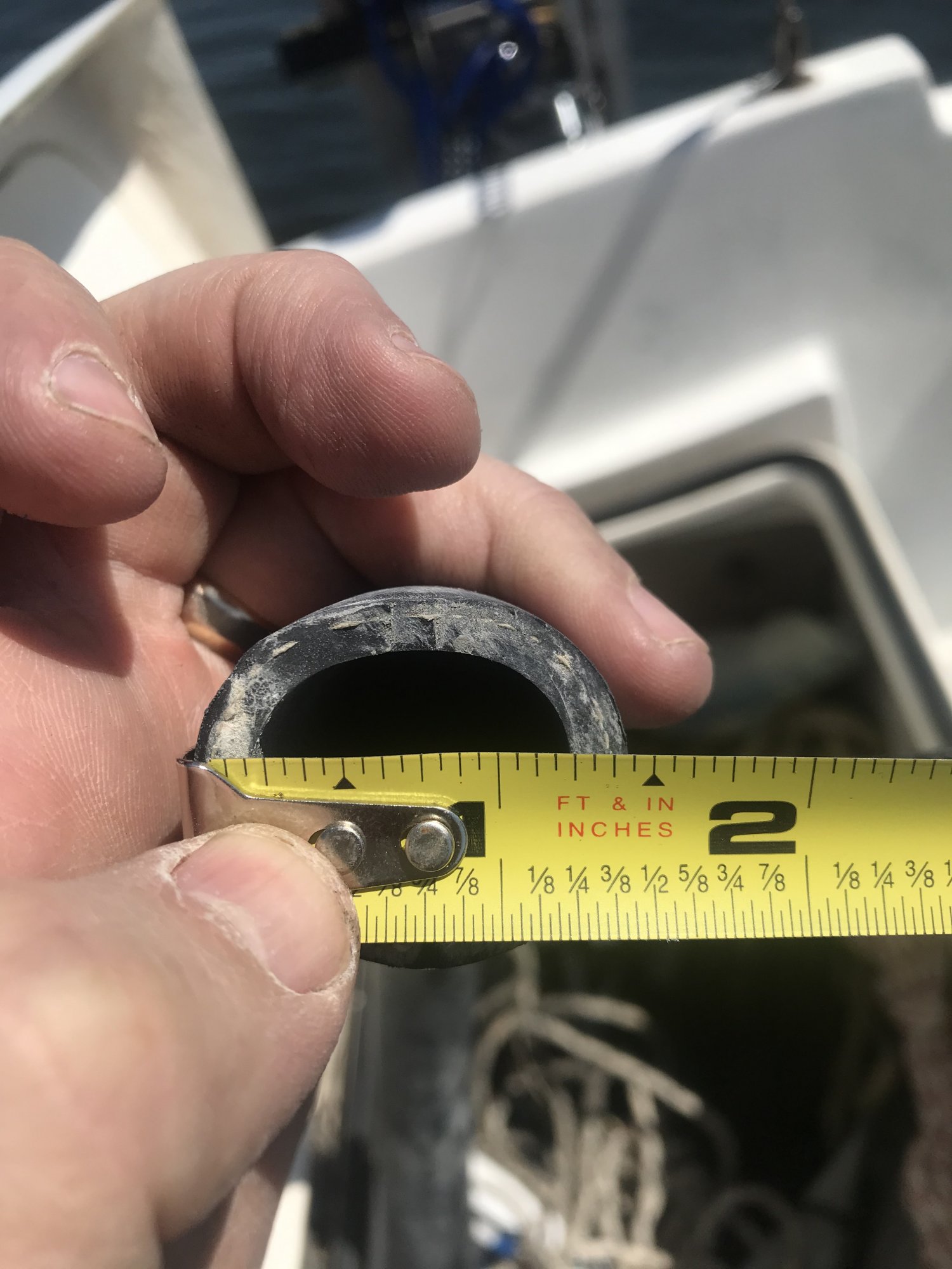

Hello Friends,
I have seen many references to this mystery "hose to nowhere" and then some very confusing replies about it.
My 1987 Capri 18 has this hose in the anchor locker (starboard aft locker) and presumably it leads to the bilge. I would like to be able to pump it out manually when needed. I don't have any electric running on the boat right now, so a simple manual pump would be preferred, but I am just not sure of what is needed in addition to the pump. Most manual pumps seem to have a hose diameter smaller than this one (1 and 3/8").
Any suggestions on what I can use to make this

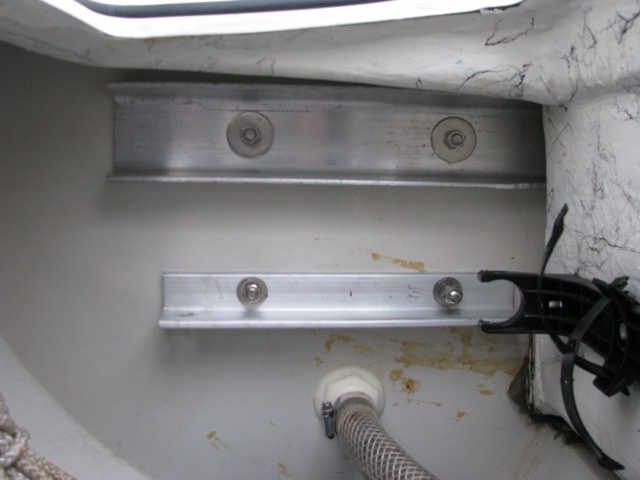

Catalina 18 273 Pine Beach NJ
It does lead to the bilge below the battery box. I believe there was an optional Gusher hand pump that was attached to the side of the footwell below the seat top. I think they may be available through West Marine, Hamilton Marine, Defender, etc. If it comes as a kit all you need should be there. If not a few hose clamps and a thru hull fitting should be enough. Good Luck!

Catalina Capri 18 Bronx, NY
Thanks, I am giving up on this because the pumps they sell are all for mounting below the deck (I cant image mounting it on top of the deck, there just isn't any room, and the instructions say not to mount it inside of the locker. I bought a $25 hand pump from Amazon with a 6 foot tube and will just pump water over the side or into the cockpit to drain out the back. I cant afford a through hull fitting when I have 2 such holes in the main cockpit anyway.
If you can point me in the direction for the right parts to adapt this hose to the intake on the manual pump (https://www.amazon.com/gp/product/B004RDHU68/ref=ppx_yo_dt_b_asin_title_o02_s01?ie=UTF8&psc=1) that would be greatly appreciated.
I have the same hand pump and have had it for years. I just stick the end in the bilge under the battery box and and lay the discharge hose on the foot well deck with the water draining out the aft scuppers and pump away. Simple and effective. I very seldom get any water in the boat and only do when it is stored on land.
