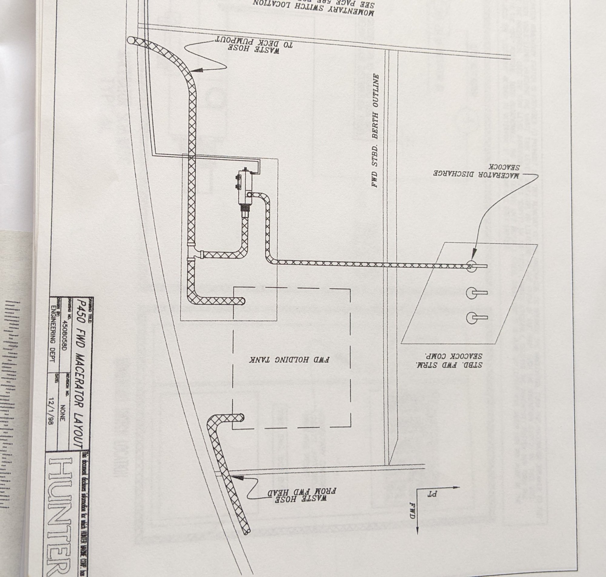

Hi,
Thought I'd finally follow up on this and ask another question. I went to the pump out station and the aft tank was empty (confirming it is working) while the fwd holding tank was full. I got it pumped out and when back to port. I pulled the discharge line off the macerator and confirmed with air pressure that the line was clear to through the hull. Has to be the macerator, right? So I painstakingly replaced it, filled the tank water and some biodegradable soap from the deck pumpout fitting hoping to see bubbles when I ran it, but nada, nyet, nicht. Soo, what next? Apparently the new macerator is still not sucking out of the holding tank? Is it the hose from holding tank to the macerator? Or should I suspect the off brand replacement macerator? Since the macerator is above the holding tank, there it must first suck air before sucking water, so it has to be an air tight vacuum in order to start the liquid running I suppose. Would you all recommend I (painstakingly) replace the hose from holding tank to macerator as the next step, or something else? Mahalo for any suggestions.
Oct 2, 2008
3,811
Pearson/ 530 Strafford, NH
We met some cruisers with a similar problem. The tank was plugged so bad that neither the macerator nor the deck outlet would work. They were able to add vinegar and baking soda to soften the plug. Eventually the deck outlet worked, but the macerator had to be replaced. Could you draw a diagram of your system? Our friends actually had disconnected the hose from the bottom tank and were poking a wire to break through the clog when they finally asked for help.

This adds another potential issue to your Trouble shooting.
Jim...
A vacuflush system does not change a single thing regarding the holding tank and pumping it out. All it does is push the waste into the holding tank.
It's either a faulty macerater or blockage in that line.

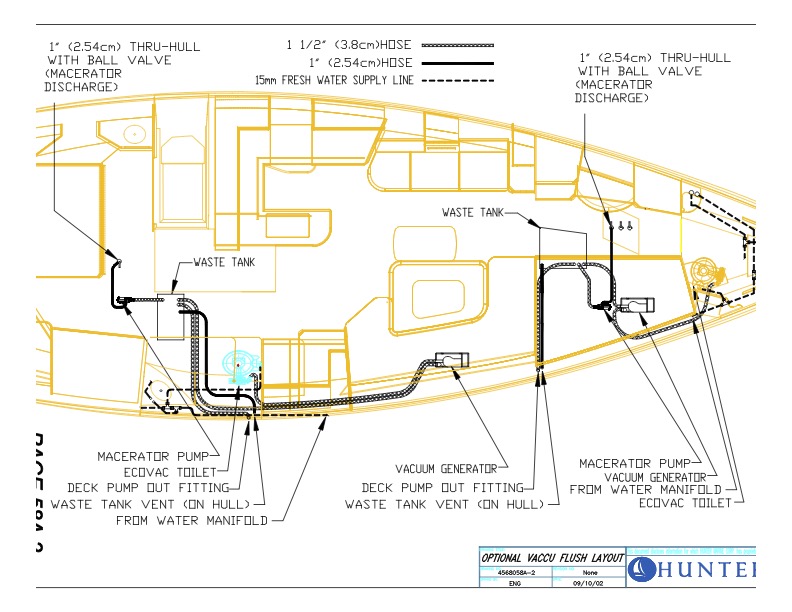

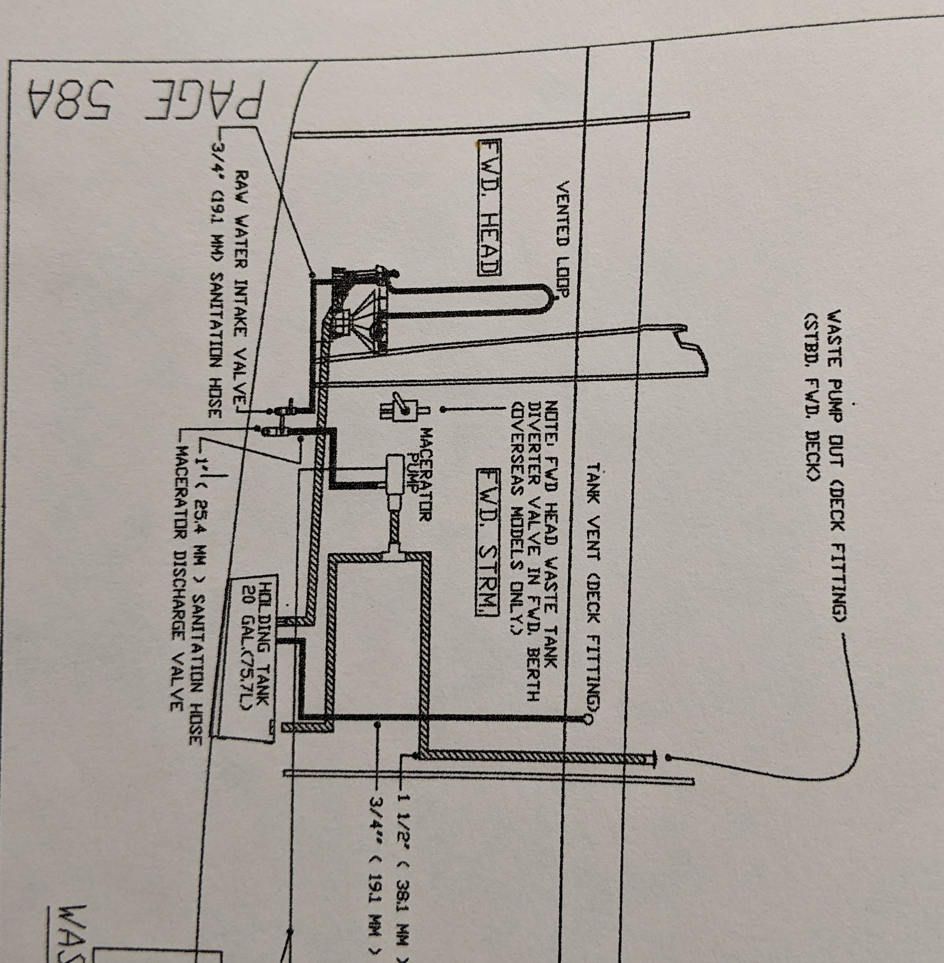

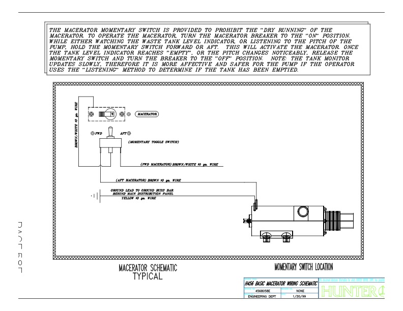

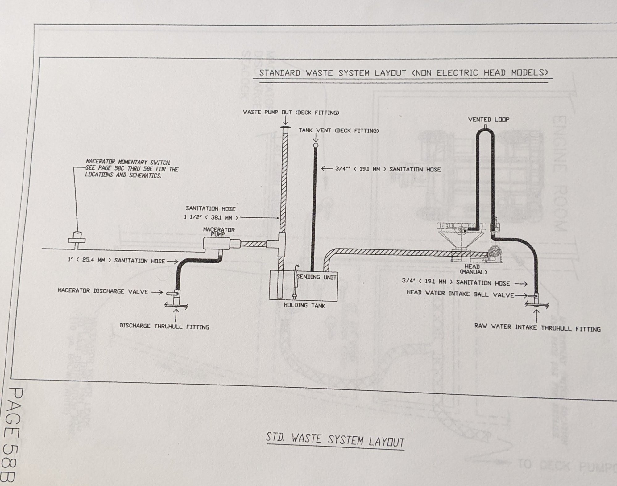

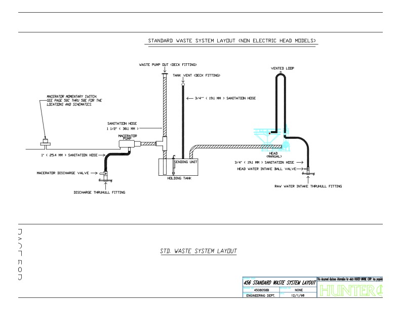

Thanks for the comments. I'm really hoping it's a deck pump cap.
@JamesG161, since I was able to pump out, does that mean I can rule out a plugged hold tank vent line? It seems like like a blockage there would prohibit pumping out also?
@Windpilot, is taking off the macerator and running a snake down the line to the holding tank a good idea?
Attached are a few diagrams for the record. Of course I have the vacupump between the head and the holding tank, which is not shown.
thanks, John
