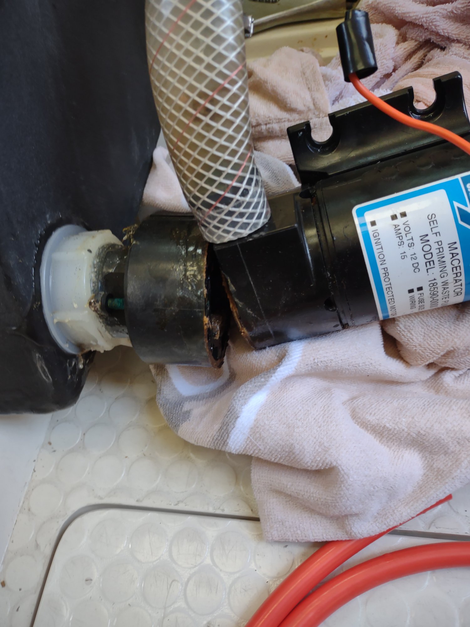

Danger Will Robinson!!! Having a 2003 boat makes your macerator(s) almost 20 years old. You should replace the macerator(s) before the bolts rust away and deposit poop like substances into your bilge. Ask me how I know this. Also my macerator failed years before it rotted out. I cruise the Chesapeake so the macerator was a non starter so I stupidly did not pay attention to it. My money is on a broken macerator(s). Fair warning.

Yes. Should locate it and replace it or at least carefully inspect it. It will rot out whether you use it or not. I remember somewhere the manufacturer (Jabsco) upgraded the bolts to a decent quality of stainless steel but I do not recall what year.

Yes, I'm not afraid of sinking the boat, as the seacock for it is always closed, but if it breaks apart it will spill sewage into my bilge!
