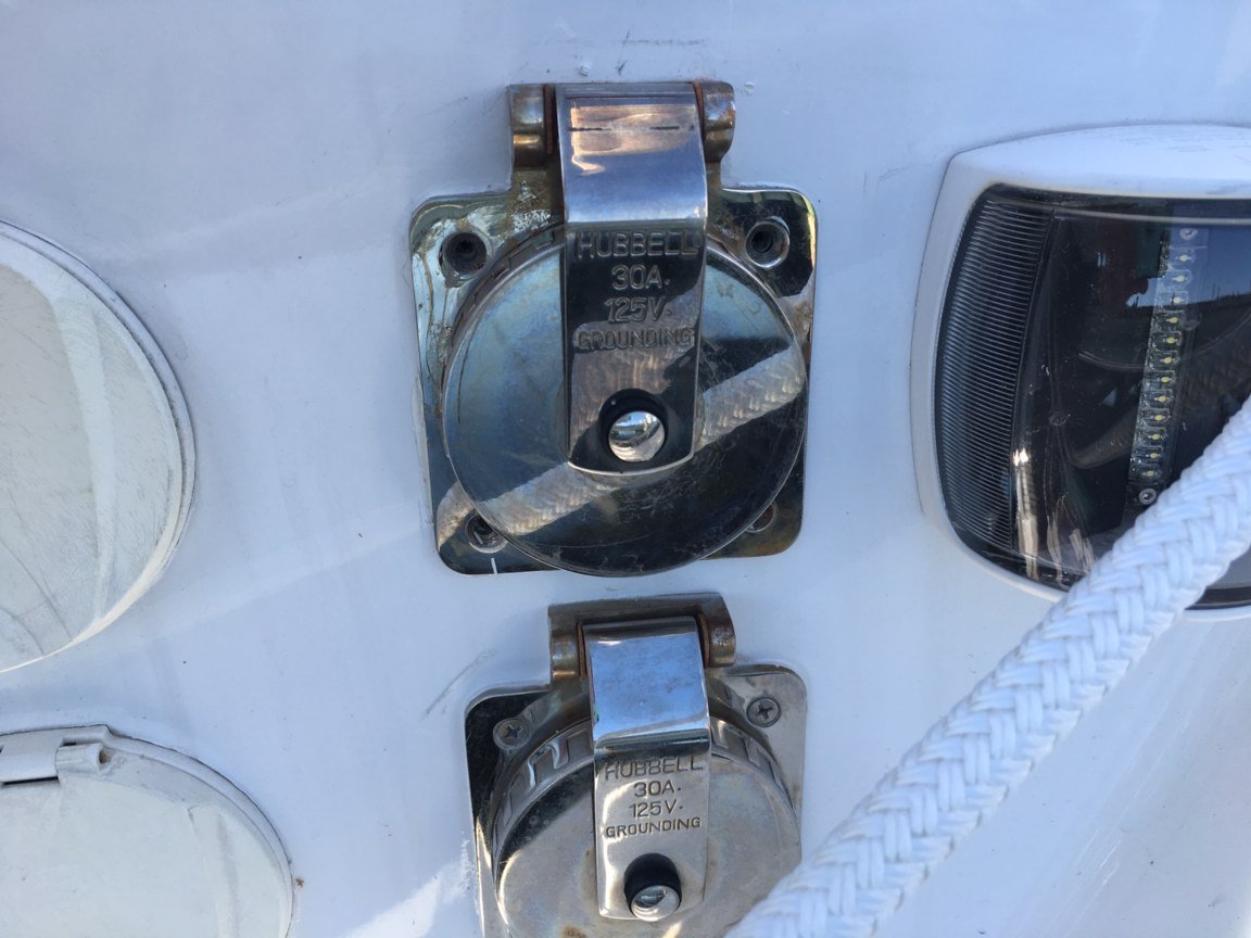

5200 will release with a heat gun , I changed out 2 transducers and 3 thru hulls and other peoples boats done with 5200 no problem ,just keep it moving and heat the fitting more than the glass ,use common sense not to burn gel coat.
Should mention as you heat the fitting ,get someone on the inside of boat to start pushing on the fitting working it using a piece of wood ,it will come out
with no damage to glass

@HanBan I often think that the part that won’t come off I has a mind of it’s own... But I have now revised that mistaken idea. It is really the boat. She is testing you. Will you immediately breakout the hammer and crash away or will you seek a persistence approach going at it a little at a time coaxing the offending part off the boat. Like removing a barnacle. You want the barnacle to want to leave as smashing it only makes a bigger mess.
Start with @Mechone approach heating the part so as to heat the glue. Then gentle work a thin putty knife around all of the part where ever you see the glue. If you can get the part to start to pull away this might give you the space to try the piano wire. My suspicion is that once heated you will have success with the putty knife.

She is certainly testing me, but I do love her and that won't change.
The piano wire didn't work, so I'm going to wait for some solvent to spray on the back of the fitting from the inside. I'm a little worried about using a heat gun on her, as I've never used one before.
This sounds like a good plan, but I've never used a heat gun before. With my luck, I'd set the boat on fire.

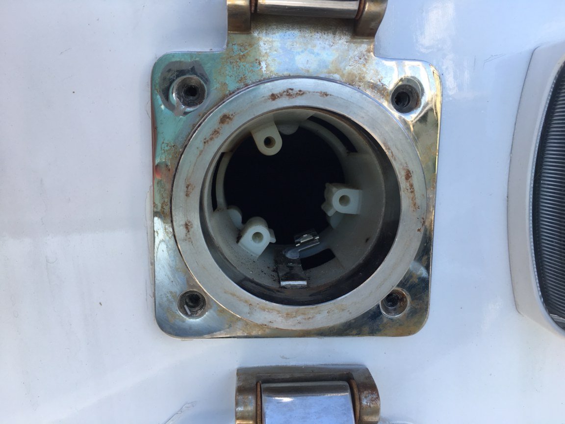

You might find that you don't actually need to replace the whole outer cover to fix the broken pins. We just had a problem with one of the wires inside ours breaking off the other day. We were able to just take off the screws on the inside of the fitting, and then pull out the whole "guts" without moving the cover.
David, I was getting so frustrated with this little repair job that I'd gladly just replace the innards to this fitting. I've gone to a bunch of electrical stores in the area and none of them have the correct receptacle.

It’s possible that a previous owner may have replaced the receptacle and in their “wisdom” may have used a strong adhesive.
I replaced mine a few years ago; there was only a rubber gasket that allowed the receptacle to be simply removed. Have to agree that careful heating with a heat gun, a putty knife / piano wire will get you where you need to go or wait until the debond solution arrives if you are more comfortable with that method. Please, no sealant on the new receptacle! Sealant only on the four screws for ease of removal in future. Good luck.
Feb 21, 2010
363
Beneteau 31 016 St-Lawrence river
If you don't trust yourself with a heat gun, try a hair dryer on it's highest setting!

In the end, I gave up trying to get the inlets off. I just couldn't get them to budge, so I replaced the innards, some of the wiring, and took the opportunity to install a galvanic isolator while I was at it. Finally, we have shore power again. :)
