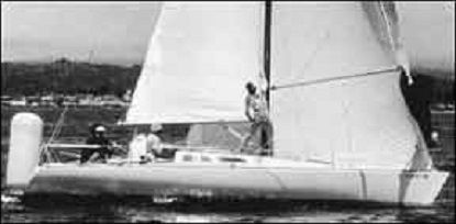

This writeup on the boat doesn't mention the angle of the winches being a problem. It does say they are barely adequate. Might help on your quest to know what offset angle you need.
