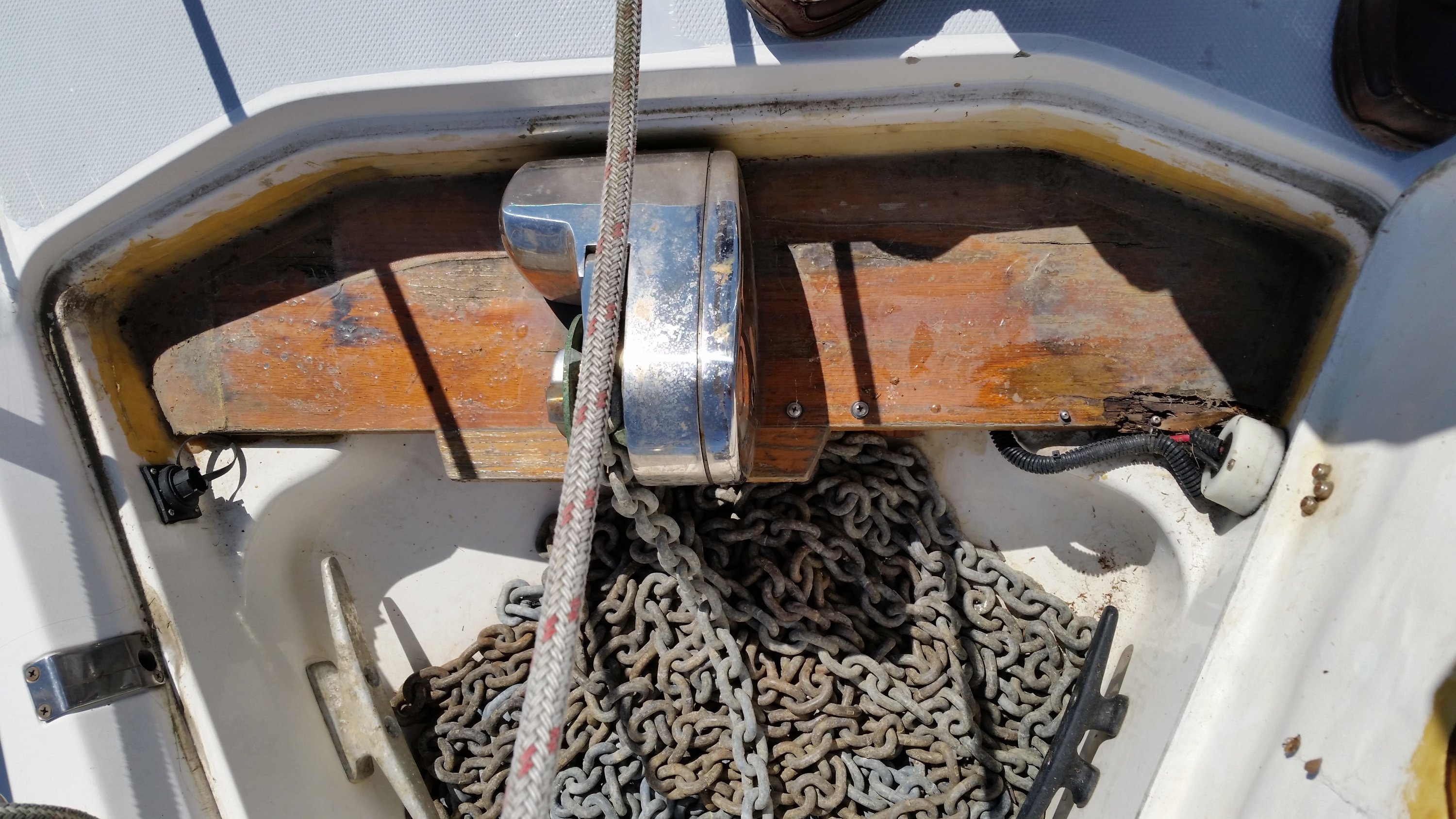

I posted what I did about 10 years ago, simple job and works well. Look in the archives, maybe first under my name. I epoxied in a board at the AFT end of the well and mounted the windless on it. The chain simply goes into the well.

that that is what the manufacturer says. But I actually installed one in a 376 as I described in a posting and have used it for about 15 years; it works fine dropping the chain into the well from the board. You just push some links a few inches with your hand from time to time to spread the chain in the well when you are at the well operating the switch.
