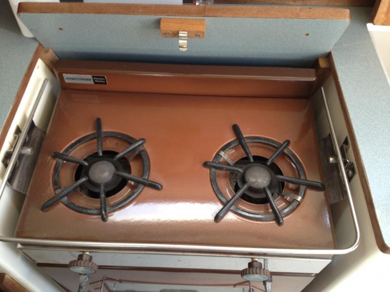

It took awhile to come up with a solution to our old Homestrand Alcohol Stove that was in our O'Day 27, but I'm very proud of the result.
The alcohol burners were a pain to use, would not stay lit and took forever to heat anything. So we pulled the old stove (the brown stove seen below) and I looked for a replacement.

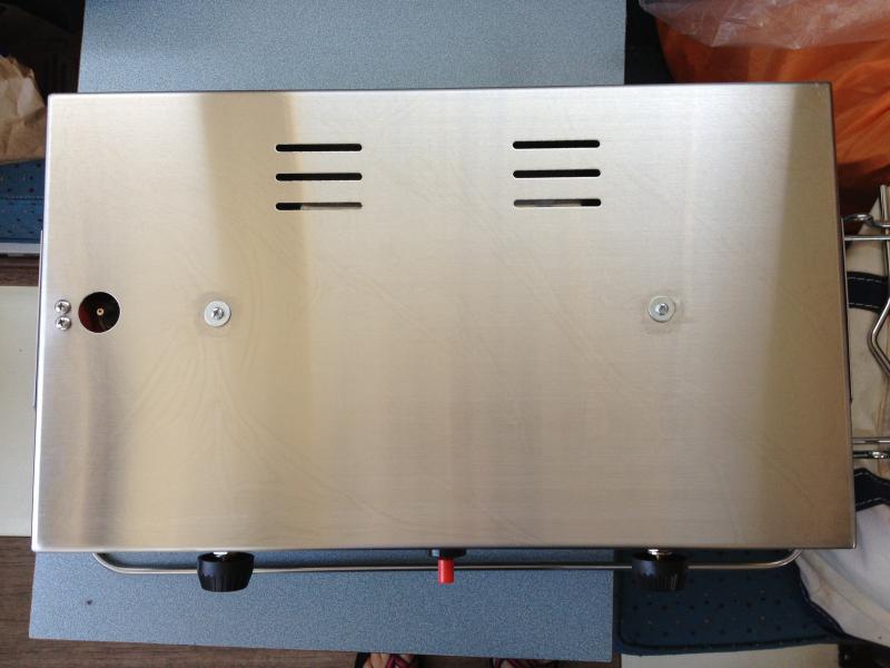

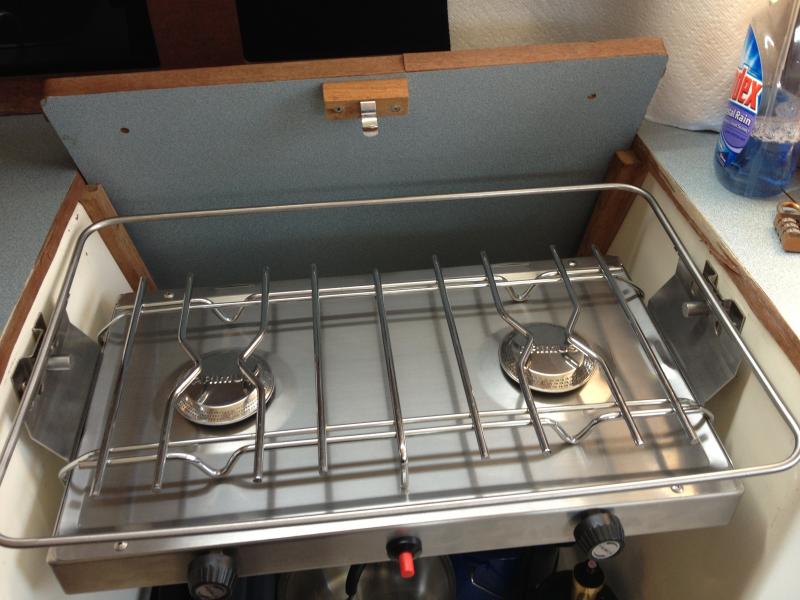

Enter the Primus Atle Campstove, AK Metal Fabricators in Alexandria, VA and lots of ambition to make this happen. Results pictured below!

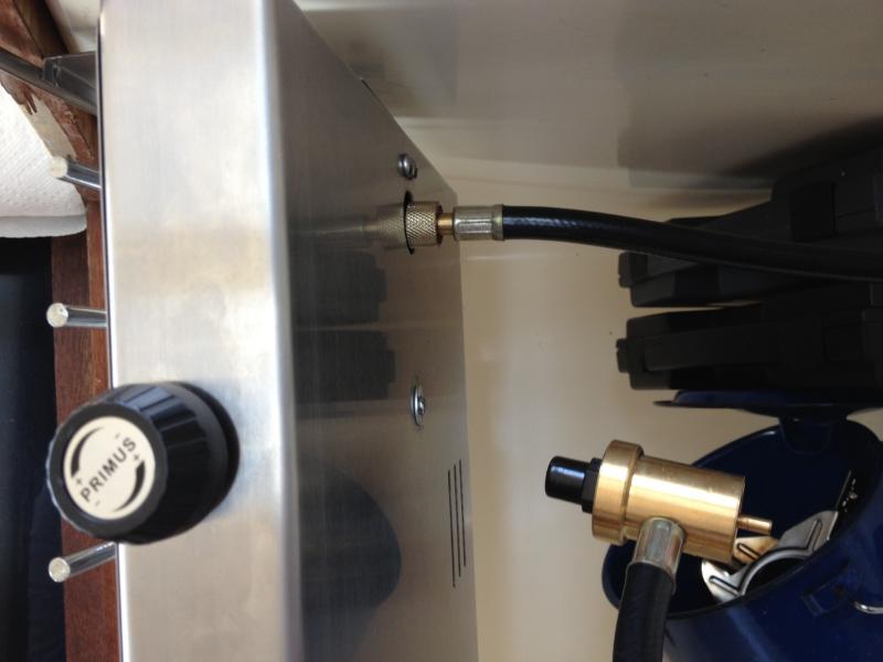

We had a setup like that for years, and it was actually a 20 year old Primus marine stove. Ours did not come with a propane hose nor regulator so we deviced a fixture based on a regular gas grill regulator, a pressure switch (shut gas off in case of a major leak) and an adapter to use the 1lb bottles. Our stove had thermocouple switches offering protection in case the flame went out by shutting gas off. I guess we had everything but a propane tank locker which brings me to the recommendation of disconnecting the gas bottle after every use. I would not rely solely on the stove valves. I do like the gimbaling mechanism and pot holding frame on your stove. Did it come with the stove or was adapted? First class, clean installation. Never mind I just realized you used the gimbaling frame of your old alcohol stove. We could never get pot holders for ours.

The tanks do not stay inside the compartment when not in use. We use the old "fuel locker" that still holds the soon-to-be-removed pressurized alcohol tank and only carry two on the boat. They actually last quite a long time.
Safety was a big concern with this refit, and the old fuel locker is not airtight in any way, and a big tank/marine stove combo I think would have been less safe without construction of a new locker. I am surprised the galley had such an elaborate stove to begin with.
I have a ticker list of safety items to check on: 1)pressure guage - I don't think they make one for one pound bottles - does anyone know? 2)I was going to have a stainless bracket made to secure the tank, instead I am going to use some bungee cord and hooks against the icebox bulkhead. 3) The small tank will be below the waterline in use, the stove will be attended however, we don't cook or use the stove unless one of us can hang out below.

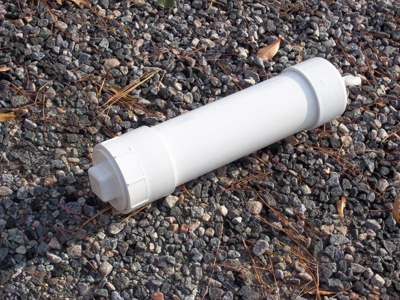

I carry 1 pound propane bottles for my grill, and didn't want to expose them to the weather by storing them in the elements above deck. Here's what I did:
I used about a 2 ft length of 4" Schedule 40 PVC drain/sewer pipe, capped one end, and glued on a threaded cleanout fitting and screw-in cover on the other end. I installed a 5/8 ID hose barb fitting in the capped end (all of this is air- and fluid-tight). I mounted the pipe with large hose clamps under the deck, in a cockpit locker that is adjacent to the boat's propane locker. A section of 5/8 hose connects the barb on the pipe cap to a "T" barb in the propane locker's overboard drain. The pipe is precisely the right diameter to slide in 1-pound bottles, and in my installation can hold 2 of them. Just as added security, I added an extra sensor to my cabin propane sniffer system, in the bottom of the cockpit locker. Here's a couple of pix of the pipe before installation; couldn't find one after it was installed.

I think your stove & the installation looks great!
Once your done cooking you close the tank valve, doesn't get much simplier than that.
You do not have a remote tank so a pressure guage is not needed to detect a leaking gas pipe. You do not have a remote tank so an electric solenoid valve is not needed.
I'm not sure why this doesn't meet the LPG standard for marine use. Only thing that comes to mind is on a camp style stove there's no thermo coupling (sensor) to shut the gas off in the event the flame goes out on a burner.
Other than that, what else about this installation does not meet the standard because I've considered doing this very thing?
