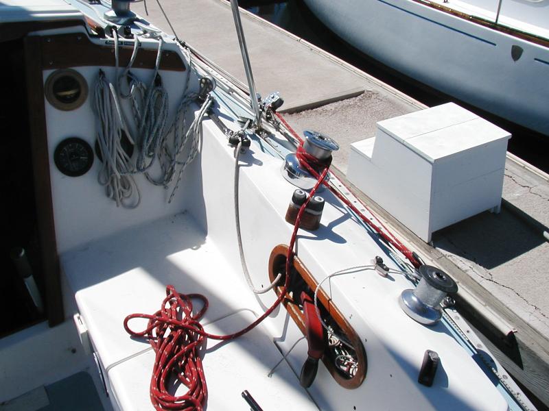

Thinwater's pic is illustrative. I like the cam cleat in that position because you can release it from the "High" side using your legs and back before a tack. If it is on a horizontal surface you have to stand up, on the low side of the cockpit, and use your arms to pull up on the sheet to release it. On a multihull maybe its a moot point; but if you are heeled over, standing on the low side is dangerous on several levels. In the pic the line will chafe on the seat but there isn't so much tension on the line at that point and I would prefer that to the horizontally mounted cleat. You could install a stainless chafe guard there if it turned out to be problem.
