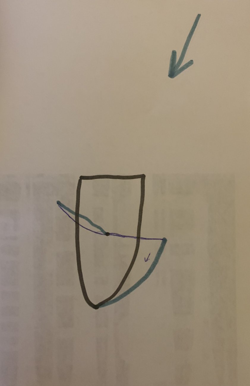

This will be your fastest set up in light to medium airs. Pole your Genoa out, and sail slightly by the Lee, so the headsail telltales on the genoa flow backwards. Open your mainsail outhaul far as you can and set the boom perpendicular to the wind. Drive carefully to manage the amount of lee.

Your picture matches what I was taught to be fastest, but is it really "by the lee"? The main is to starboard, with the wind from the port quarter. I thought "by the lee" would be the wind off the starboard quarter with the main still to starboard.
Incidentally, I've found that at least with my rig going by the lee seems to be less stable than just DDW. Once I get more than 3 degrees by the lee or so it seems like the jib starts to get interference from the main and begins to collapse. It probably differs based on things like jib sheet angles and sail sizes, but for me DDW to about 170 degrees of wind angle (not by the lee) seems best, just as you drew it.

I posted the wrong drawing! Backwards! I’m at a party right now, will sort out tomorrow. Or someone else can. :)

jibes138, I do have a pole
jackdaw, your drawing is exactly what I try to achieve and like best, but now that I think about it, were I'm coming up short is the ultimate importance of the use of the pole. Especially in light winds. I've tried to fly the genoa "free", and being a ODay 28 with sail plan that has a bigger than normal headsail, then having a big heavy 150 genoa of traditional Dacron w/sunbrella UV protection cover, I might be trying to get water to flow uphill. Especially without that pole.
daveasailor26 I agree 170 degrees is the perfect target and has always seemed to be where I've had the best luck.
Starting tomorrow I'm going to get reacquainted with my pole.
