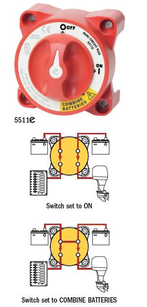

To possible better clarify my question: There are 2 wires ( about size 8 AWG) that run from the engine compartment now to feed the entire Panel, and the current ignition system is tied through the "DC Main" feedswitch....so to power the ignition system, the DC main must be on, which also feeds the house batteries.
All connections of the battery cables themselves aside, how do you reroute/ eliminate/ or permanently connect those lines now feeding the DC panel, so that the ignition power is an isolated circuit?

Got it. I would simply add an On/Off switch going from your starter battery to the starter motor/ignition system and bypass all that other stuff. You can then use your house battery - ies to power the DC switch and the DC needs of the boat. Again use a Combiner to automatically connect the batteries when they are being charged by the engine's alternator or an outside AC charger.

You;re buying or have already bought the Blue Sea "kit" with the switch and the "isolator." That isolator is NOT a diode, it is a true ACR (automatic combining relay).
What you do is wire the alternator output to the house bank and use the ACR to connect the house and reserve (start) banks. You're done.
If you have a wire between the alternator output and the starter, remove it (see this for why: OEM 1-2-B Switch Wiring History http://c34.org/bbs/index.php/topic,4949.msg30101.html#msg30101).
You seem to be confusing the "ignition" circuit with the power from the switch to the starter. The Blue Seas wiring diagram should show all this, although, IIRC, it only seems to show outboard motors instead of inboards with alternators.

On most every boat out there the engine panel is powered directly off the starter lug. When you flip the battery switch on the engine panel can then be powered by turning the key on. If you are wiring in a dual circuit plus switch the engine panel should just pull power off the starter lug, properly fused of course.

It sounds like you are installing the same system I have on my C310. You are describing an isolating circuit battery switch with an ACR. The battery switch has 4 terminals. The start battery cable goes to a terminal on one side of the switch, and the engine start cable goes to the other terminal on that side. Then the house battery cable goes to one terminal on the other side of the switch, and the feed to the DC panel goes to the second terminal on that side. You are in effect replacing the "DC Main" switch. The ACR is then installed between these circuits, to parallel them for charging purposes. The sensing circuit for the ACR can be calibrated to the house battery or the starting battery. The idea is to isolate any voltage surges in the starting circuit from the electronics in the house circuit. The battery switch is labeled "OFF", "ON" and "BOTH", no "1" or "2". Correct?
As Maine Sail explained, the ignition circuit is still energized from the start circuit.
I'm sorry but it simply can't be if the switch only has three positions. Even a simple 1-2-B switch has only three terminals, but four positions.
Sep 28, 2008
922
Canadian Sailcraft CS27 Victoria B.C.
Yes it can Stu. The switch in the "Add A Battery" package from Blue Seas is unique in that it closes 2 separate circuits when in the "on" position. The 2 circuits are kept separate when in the "on" position and there is a "combine" position that parallels the house and start batteries when selected. You already noted that the Blue Seas diagrams (including the one below) only show outboards. That is because this switch is intended for battery banks of equal size. This applies to smaller powerboats that have a single house battery and a start battery. I have installed it on this type of boat, mostly small sportfishing boats and it is ideal for this. It is not intended to be used when one bank (house) is appreciably larger than the start battery. If the start battery is discharged and unable to start the engine the only option with this switch is to combine the banks. If the house bank discharged to 50% and the start is dead combining can leave you with the inability to start the engine. A discharged battery should never be combined with a good battery as the current will flow to the dead battery - if the house is discharged enough - as it might be after a weekend at anchor - you can end up with a start battery that has little charge and a house bank with less capability than before combining.
I love the ACR but this switch really doesn't belong on a cruising boat with unequal bank sizes. One is better off to keep the 1/2/both/off switch that is already installed and add the ACR by itself. This gives you the option of starting with each bank individually without using the "both" position. And it costs less.:)
Stu - Blue Seas also makes switches that are simple on/off with 3 studs on the back - one source and dual outputs.
Feb 6, 1998
11,772
Yes it has FOUR terminals and is OFF, ON & COMBINE
