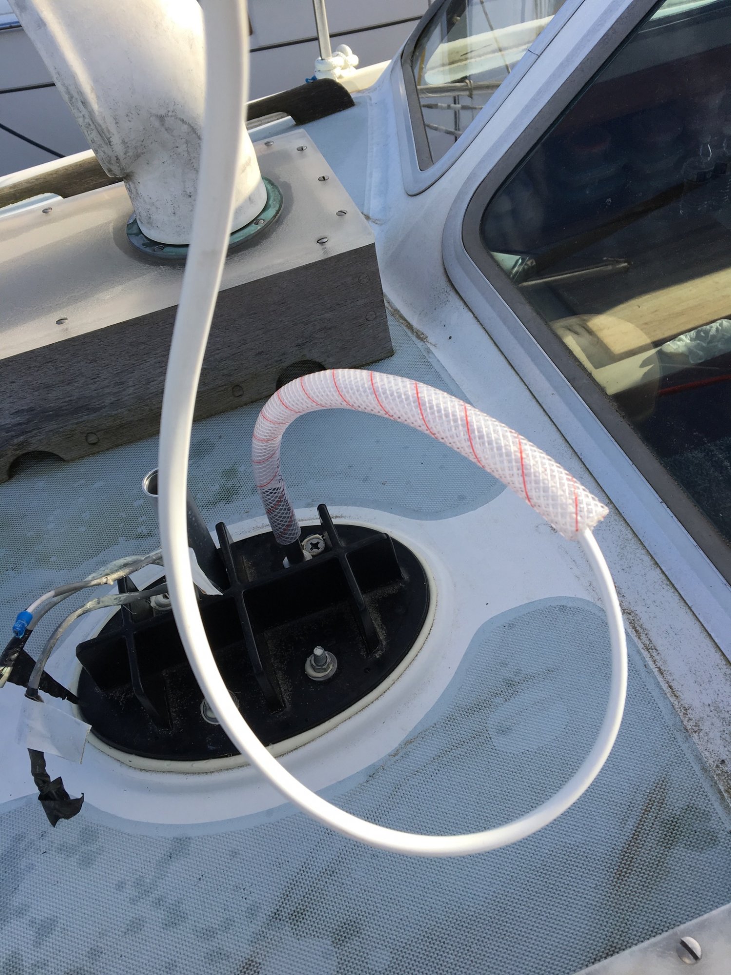

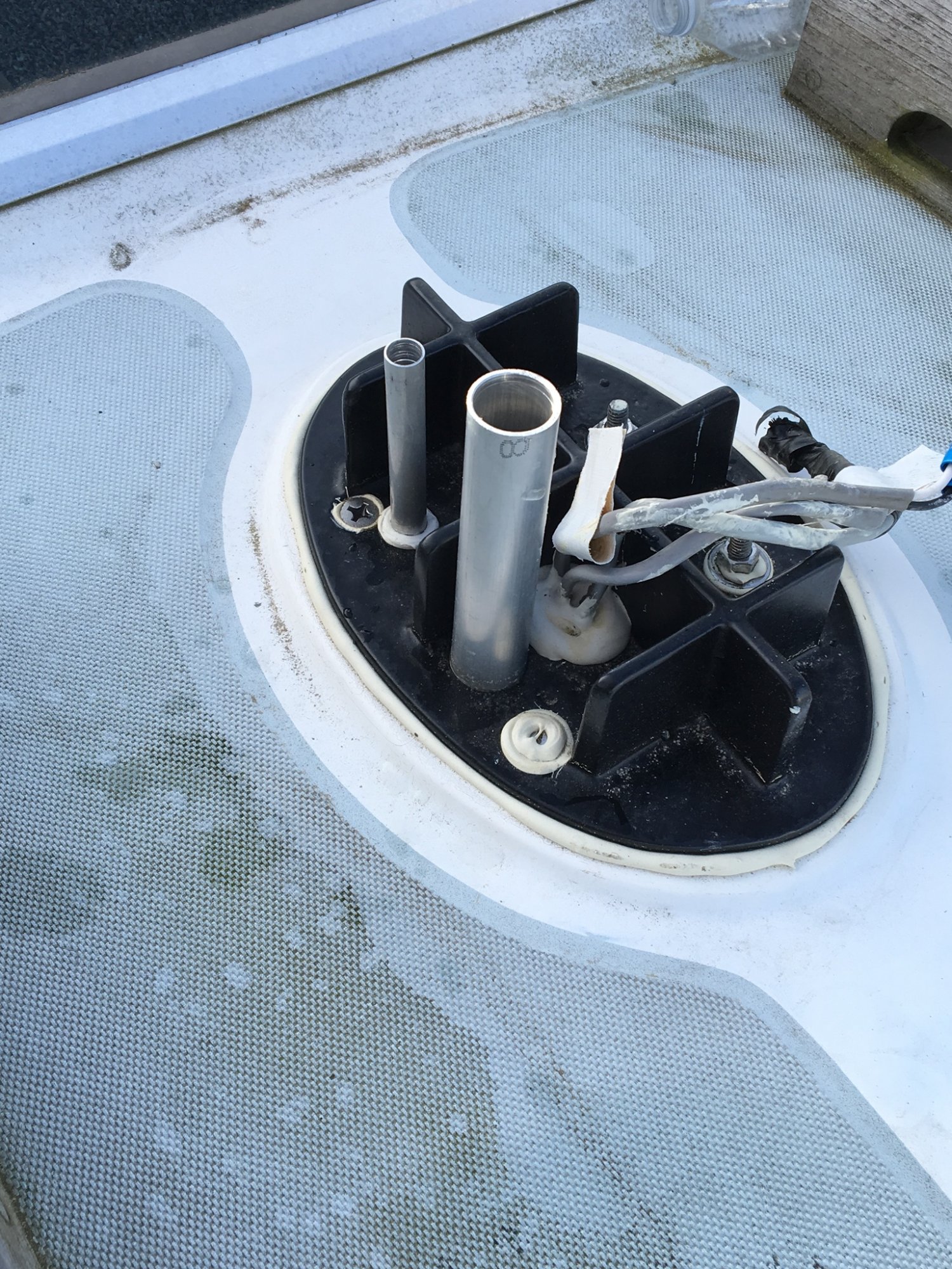

This is what my 1974 CAL35C mast base looks like. The pipes are for the wires to penetrate the deck. The base has weep holes for the water that comes down the inside of the mast.
