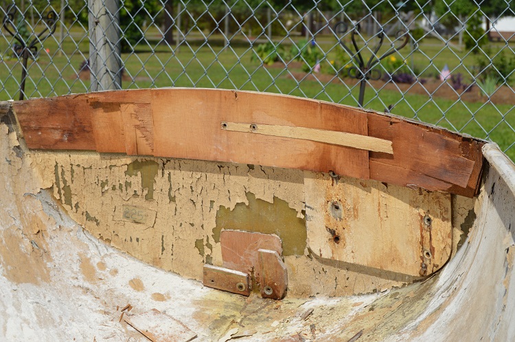

Inside structures removed
Shot of the stern from inside the cabin. Note the rotted wood along the top of the transom, rudder backing and outboard motor backing.
