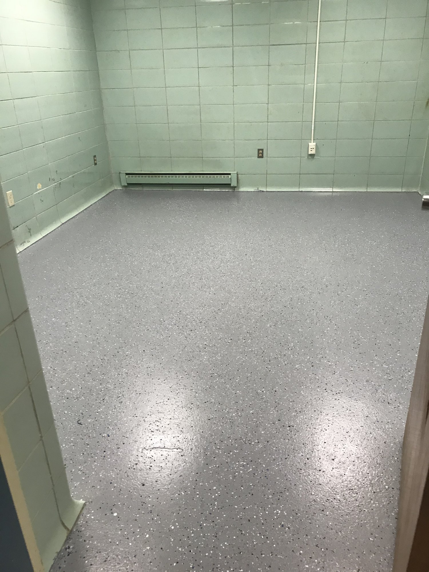

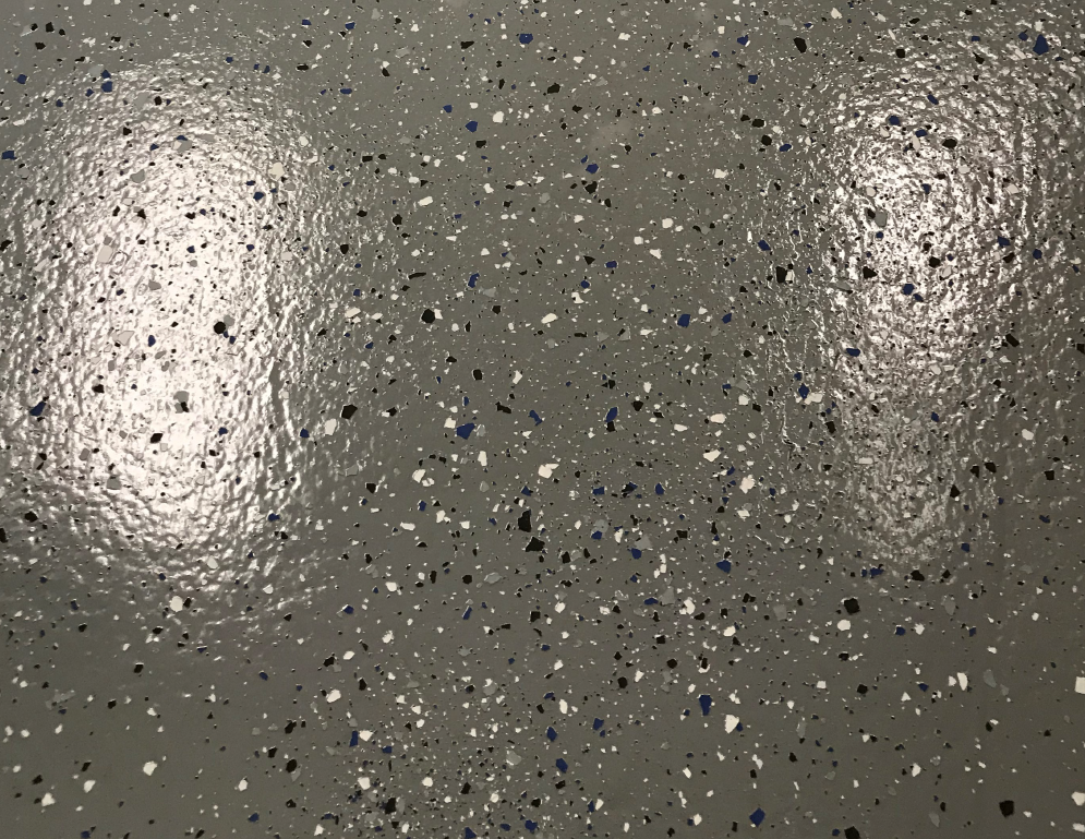

In the past few months I have surfaced two concrete floors with Rustoleum’s epoxy garage floor surface paint. It is marvelous stuff. I can’t say enough good things about how the job turned out and how easy it was. A gallon would be WAY more than you need so you could easily test it out on a piece of fiberglass. The can says it will work on fiberglass but I have no first hand experience there. You can add anti-skid beads and a high gloss surface if you want. This is a picture of the gray floor I did. This is a utility room at work. I also did a floor in blue. You can get many different colors. The floor in my picture does not have the high gloss or anti-skid. My understanding is the anti-skid is only necessary if you go with the high gloss.

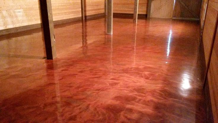

Here is a color that would look nice as a faux wood floor... kind of looks like cherry.

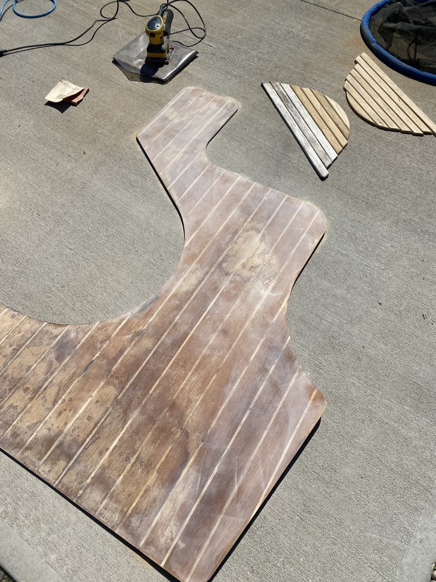

I just removed mine and sanded it down. I stuck some luck because the glue holding it was very weak. It peeled right up. I haven’t finished it yet but it’s looks like it will turn out well. Picture is half sanded. If it wasn’t loose I would finish it in place.

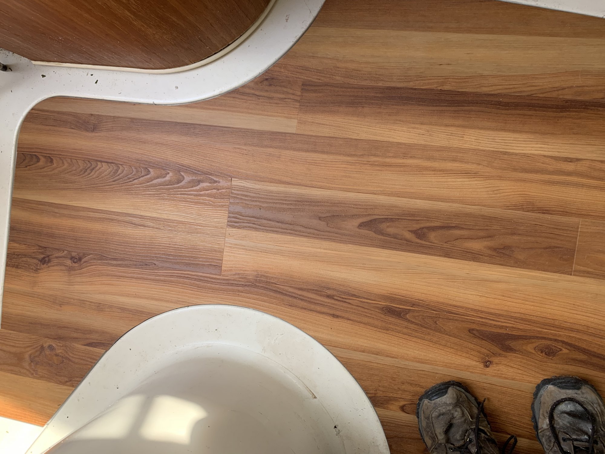

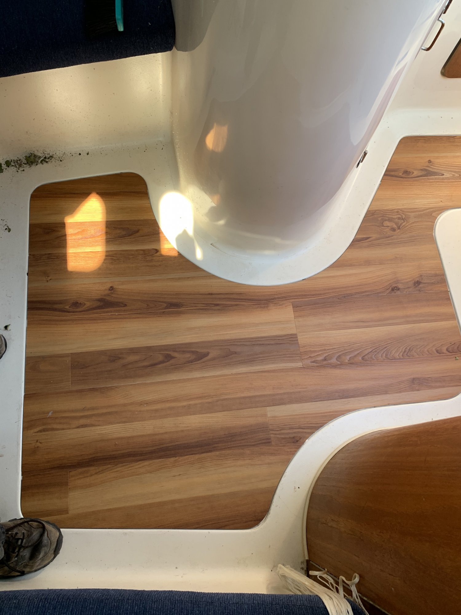

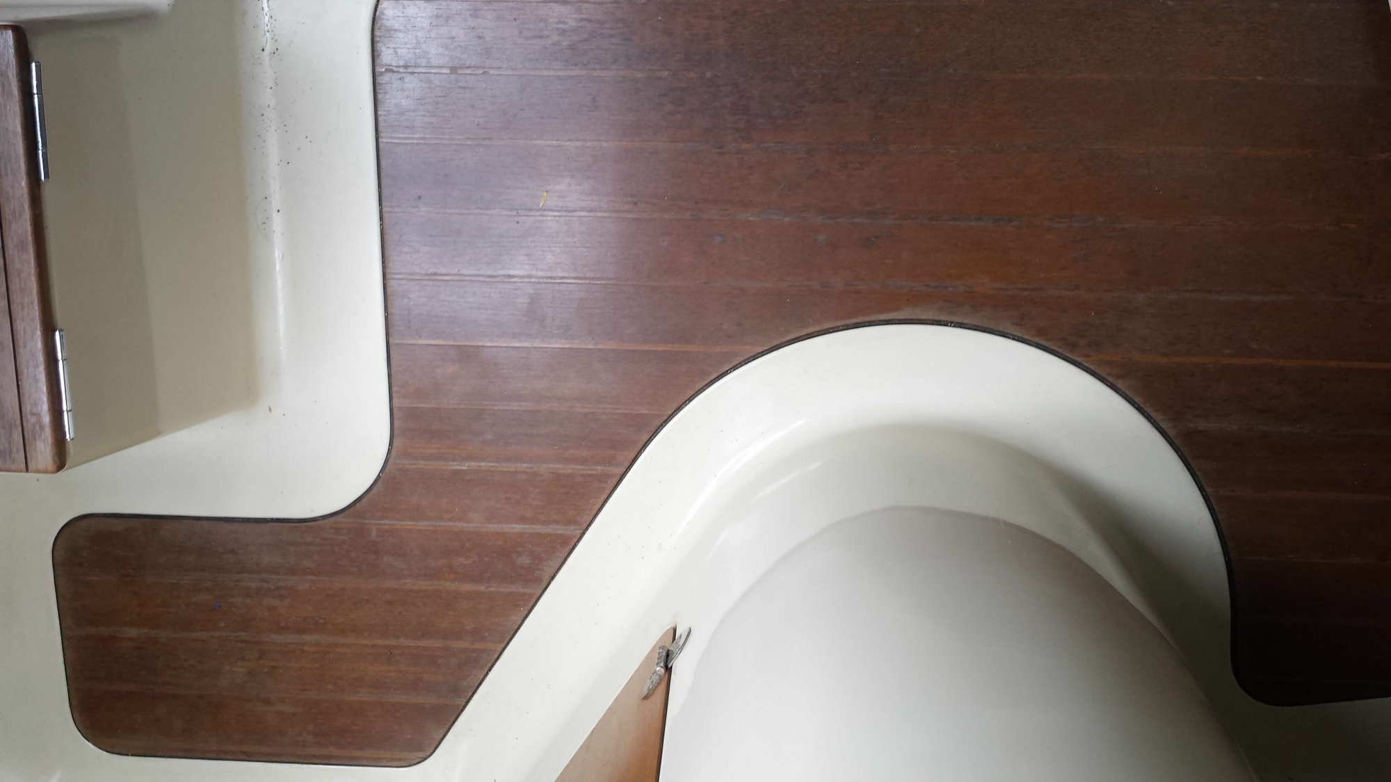

I had to pull ours last year after the ply completely delaminated. I replaced with a plastic laminate plank. not sure if it survived our winter yet but will post a follow up in a few weeks. This is how it it looked after installation.

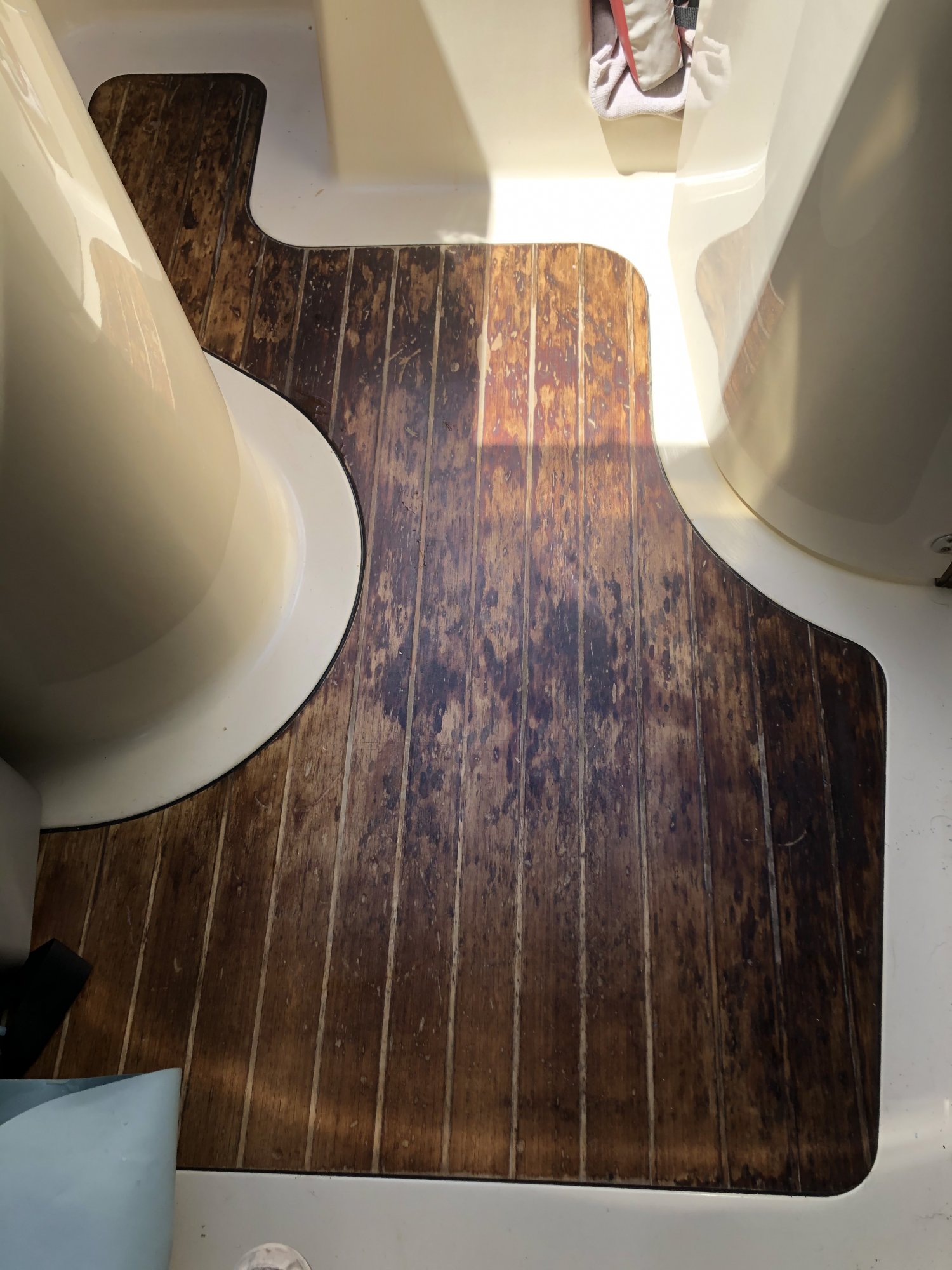

Got this from a Google search.
"Fill a bucket with warm water and a splash of Dawn soap. Use the 3M scrub pad with plenty of soapy water to scrub the sole. This acts as a mild sandpaper without scratching, but it will deep clean most of the built in grime."
I think I'll try this first. Should be the least risky.
Here's what mine looks like.

Now that looks amazing! The biggest issue is the thickness of whatever replacement material is used. It has to match the height of the surrounding area. Having something that can easily be removed and replaced is important to me.
