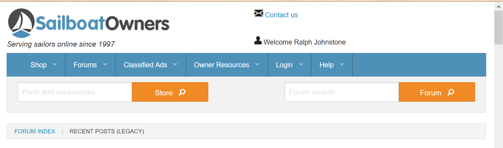

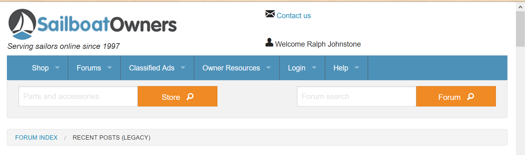

Welcome to the site. If you go to the top of your screen, you will see a very dim window labelled "Forum search".
Just hit the orange Forum button and you will have a search engine which will take you to a library on fixed portlight and hatchlight repairs. And "yes" there are an enormous number of people who have undertaken this DIY project and many of them have videoed their work. Some are excellent, and some ...................... not so excellent :yikes: . You be the judge.
