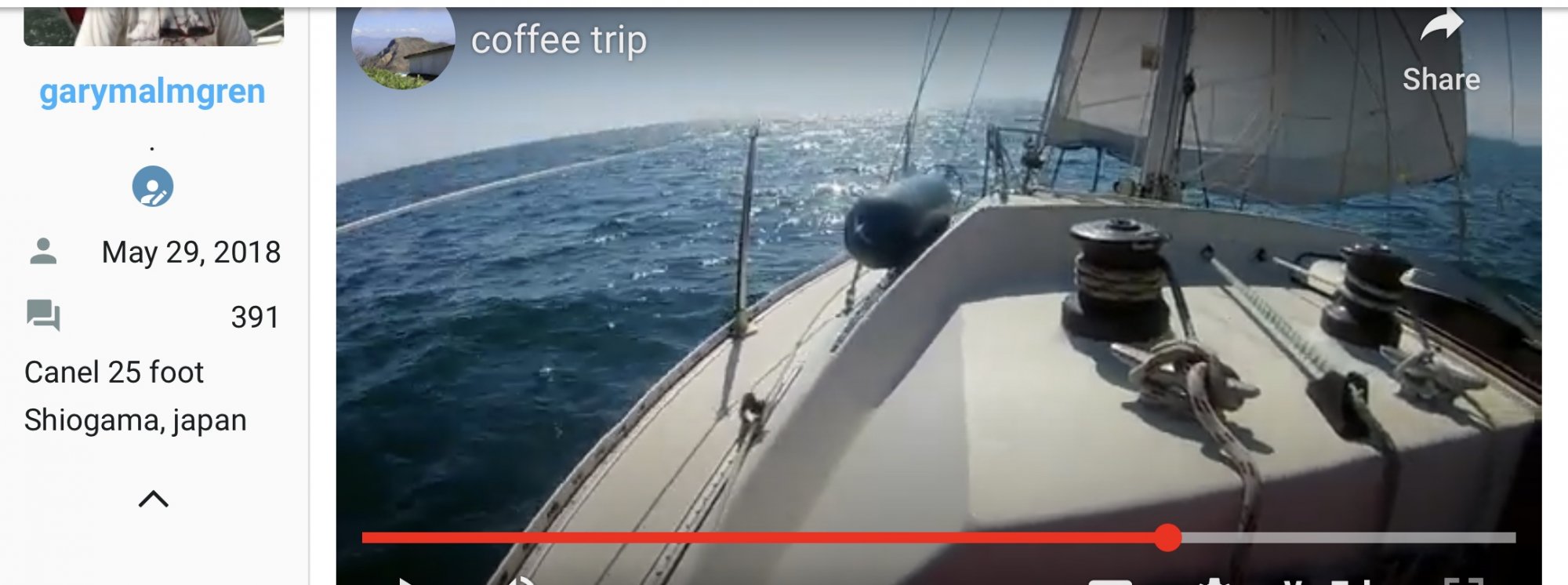

While enjoying a fellow SBO owners sailing video, ( here is his post... Stepping out for a coffee )

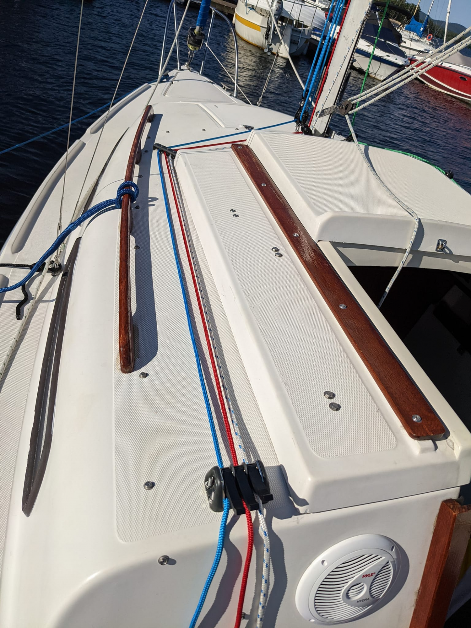

@garymalmgren had an image of his cockpit lines in the video of his sail. It is simply and effective at a moderate cost. His boat is a 25ft Canel sailboat. You could do something like this on your boat running the lines back between the companion way pop top and the hand rails.
As Joe suggested, using some small winches would help. Cleats are simple to use and less expensive than clutches. You can use a jam cleat like here in the image, or a cam cleat for lines you need to make frequent adjustments.
Simple is better on a boat.

Thanks John and Joe for your great feedback, ideas, and for pointing me to some examples which led me to some other examples. One such example from @fudderrucker851 on youtube uses clutches without winches on his Sirius 21. I have asked and now I'm waiting for his answer on how the halyards are tensioned. If the answer seems reasonable then that might be the simplest solution. Maybe he uses the jib sheet winches. Not holding my breath though.
John, thanks for showing me the @garymalmgren solution. I might be wrong but it looks like that method requires a dedicated winch for each line. That would work for me because I'm only concerned about the mainsail. But I don't want to limit my options in case I want to add a line, as Joe suggested.
NO. One winch for several lines. Yes he has an extra winch, but it is not necessary.
You need some way to hold each line in the cockpit.

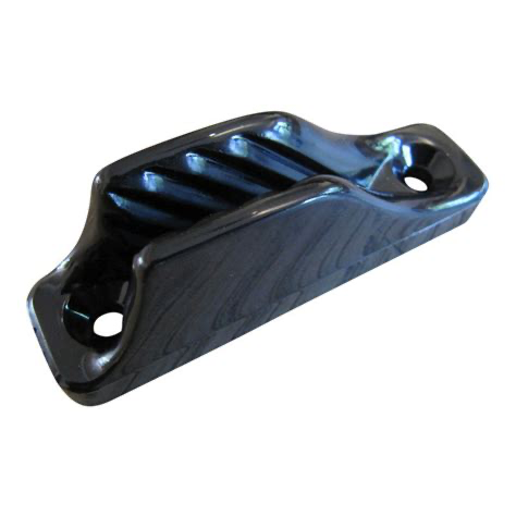

Gary uses 2 Cleats and a "jamCleat".

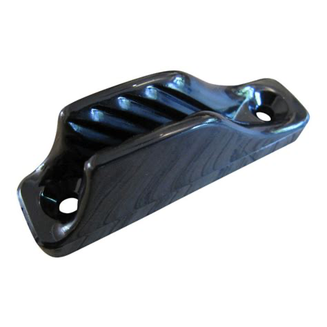

This is a jam Cleat.

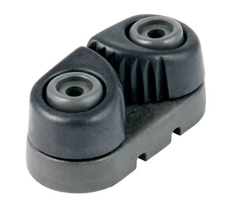

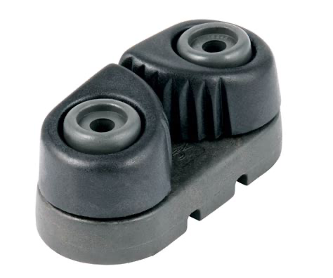

You could also use cam cleats.

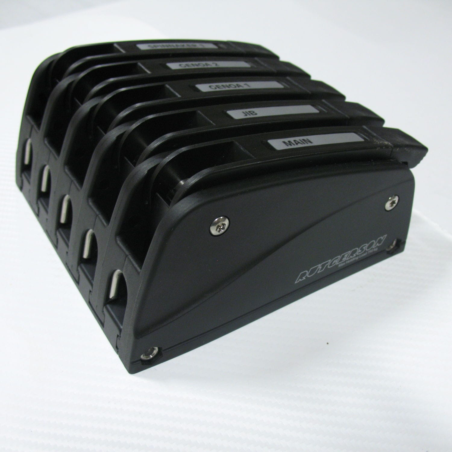

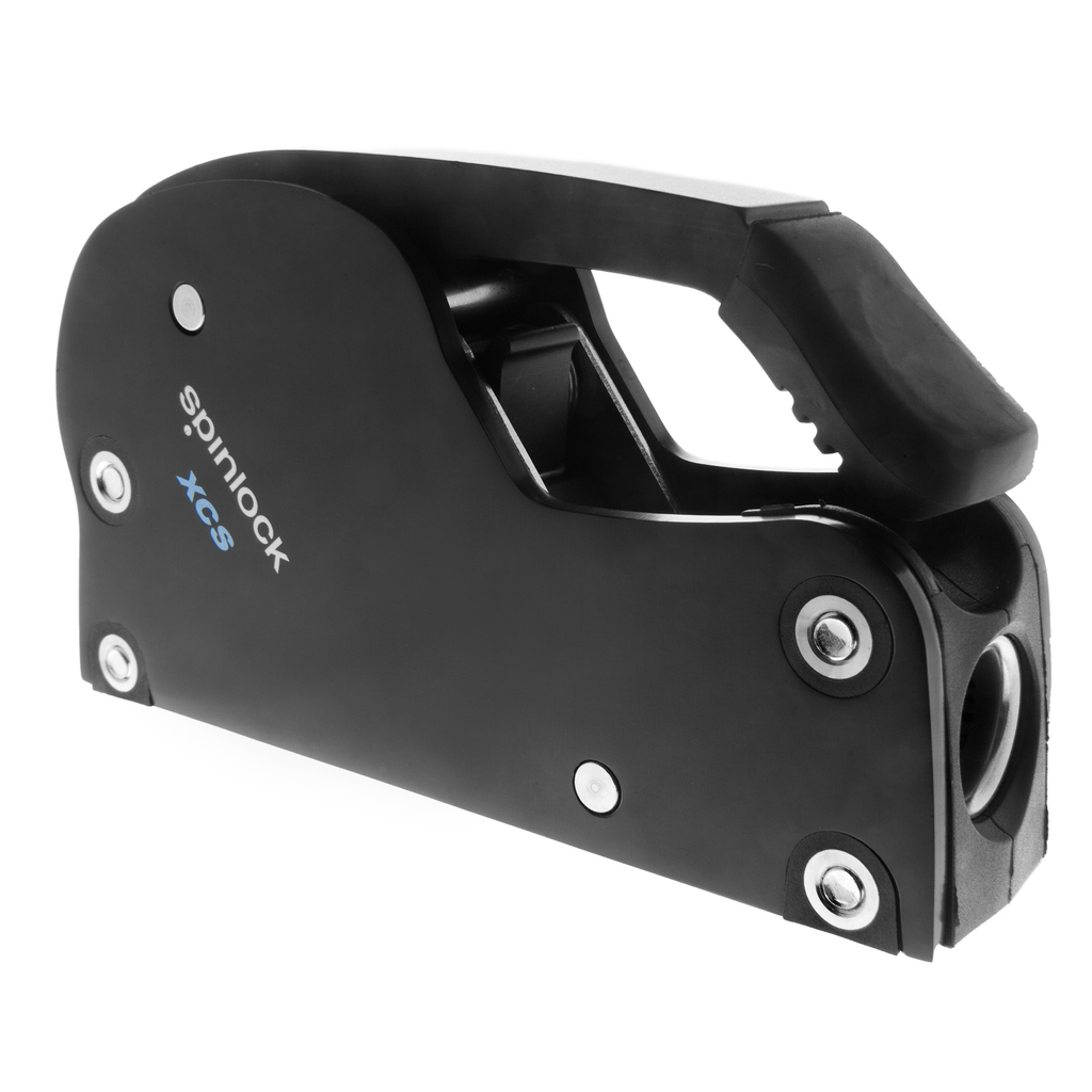

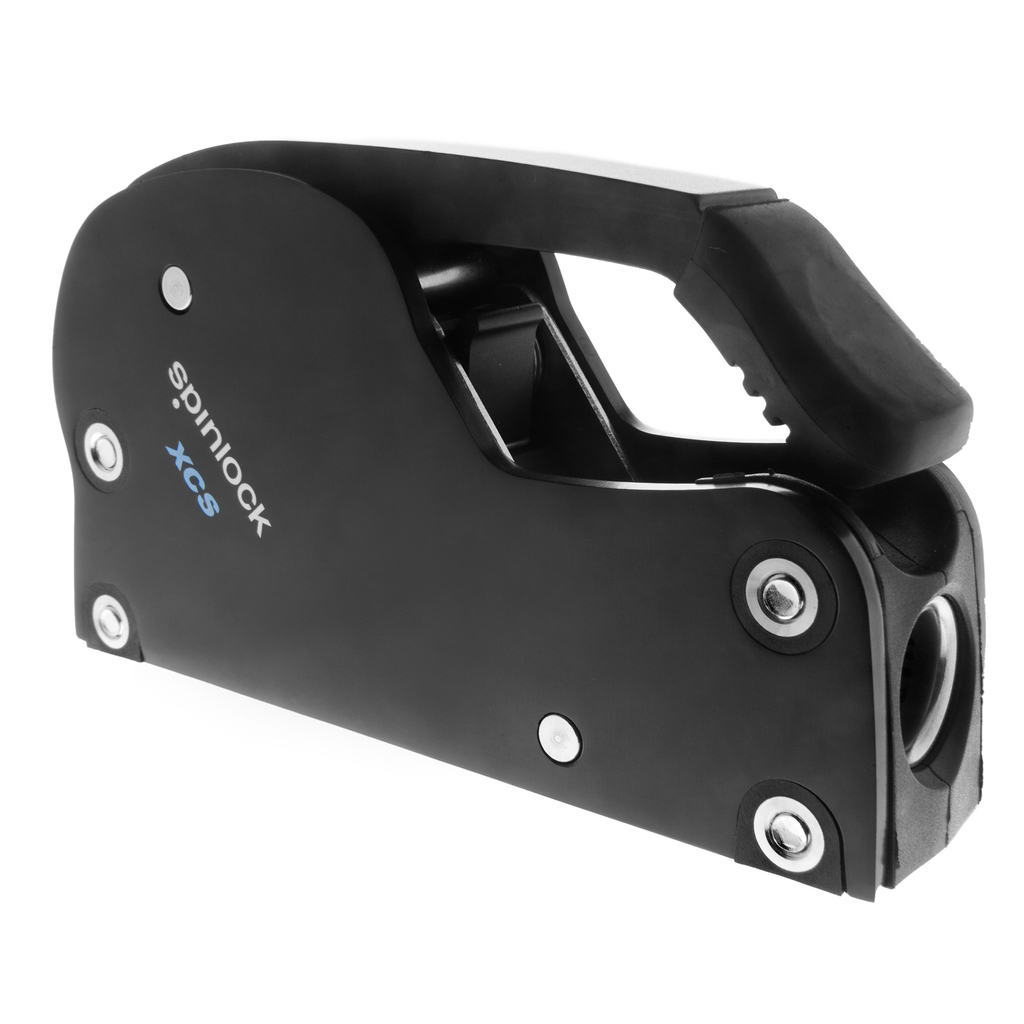

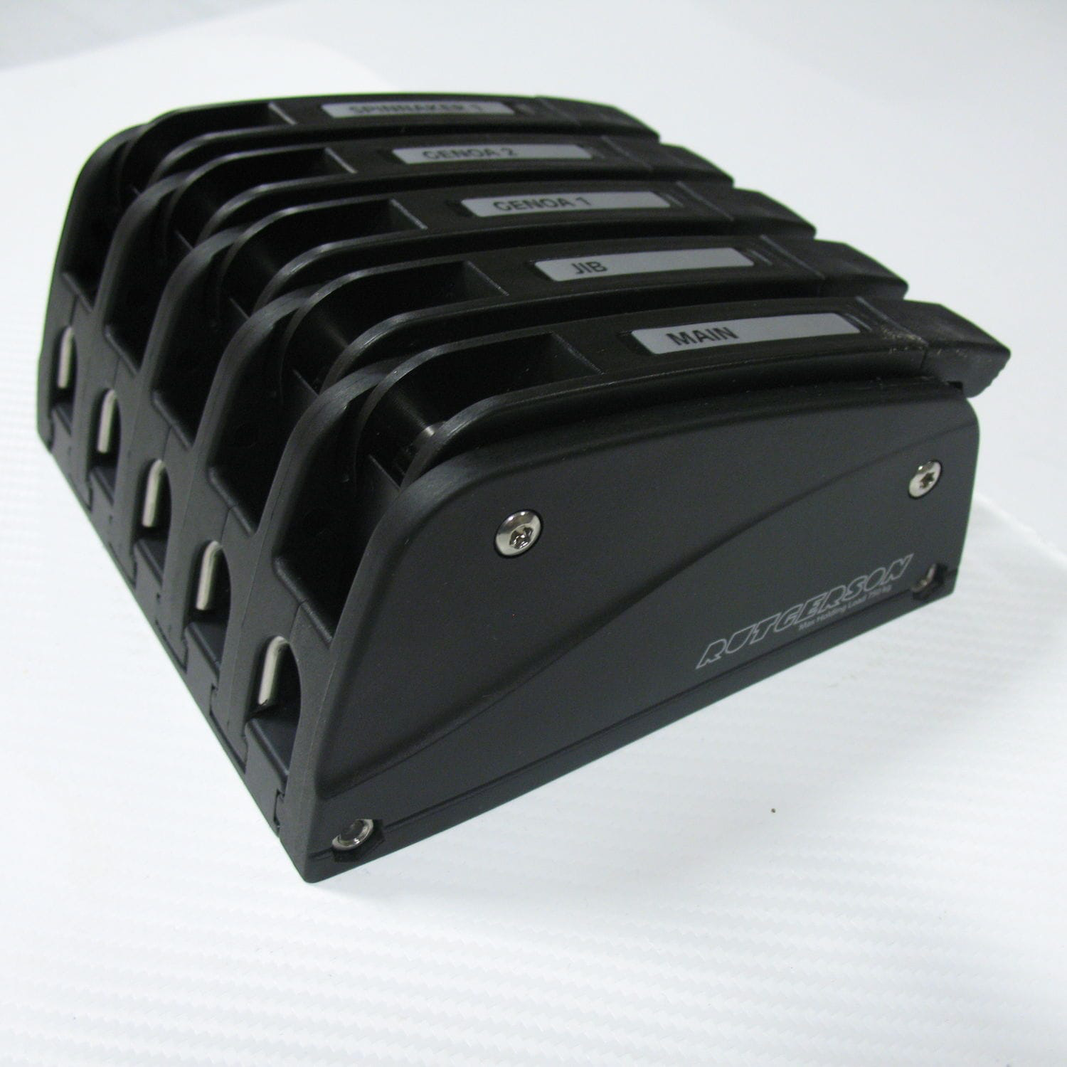

Another alternative is the clutches. They come is several designs. Singles and groups.

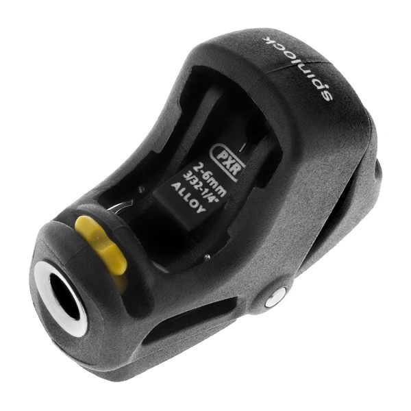

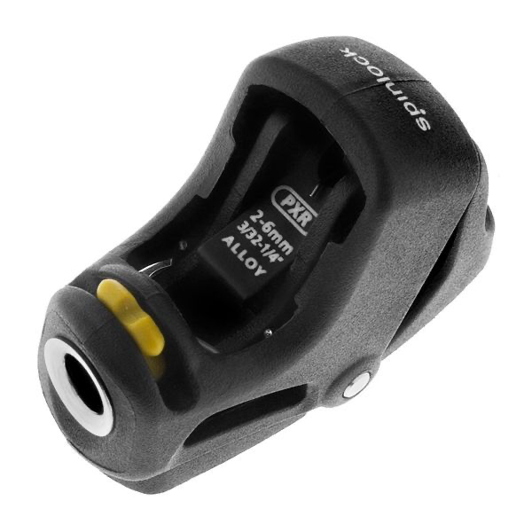

Spinlock designed a new camcleat one that is easy to release. You pull up on the line and it releases.
Spinloock detail:
Fast precise control for hand tensioned lines
Roller action ensures easy release under high load
Hard anodised alloy cam and base
Ideal for high performance lines
Micro size for small diameters
Three stage release control switch
Ideal for single line spinnaker hoist systems
Resists accidental re-cleating
