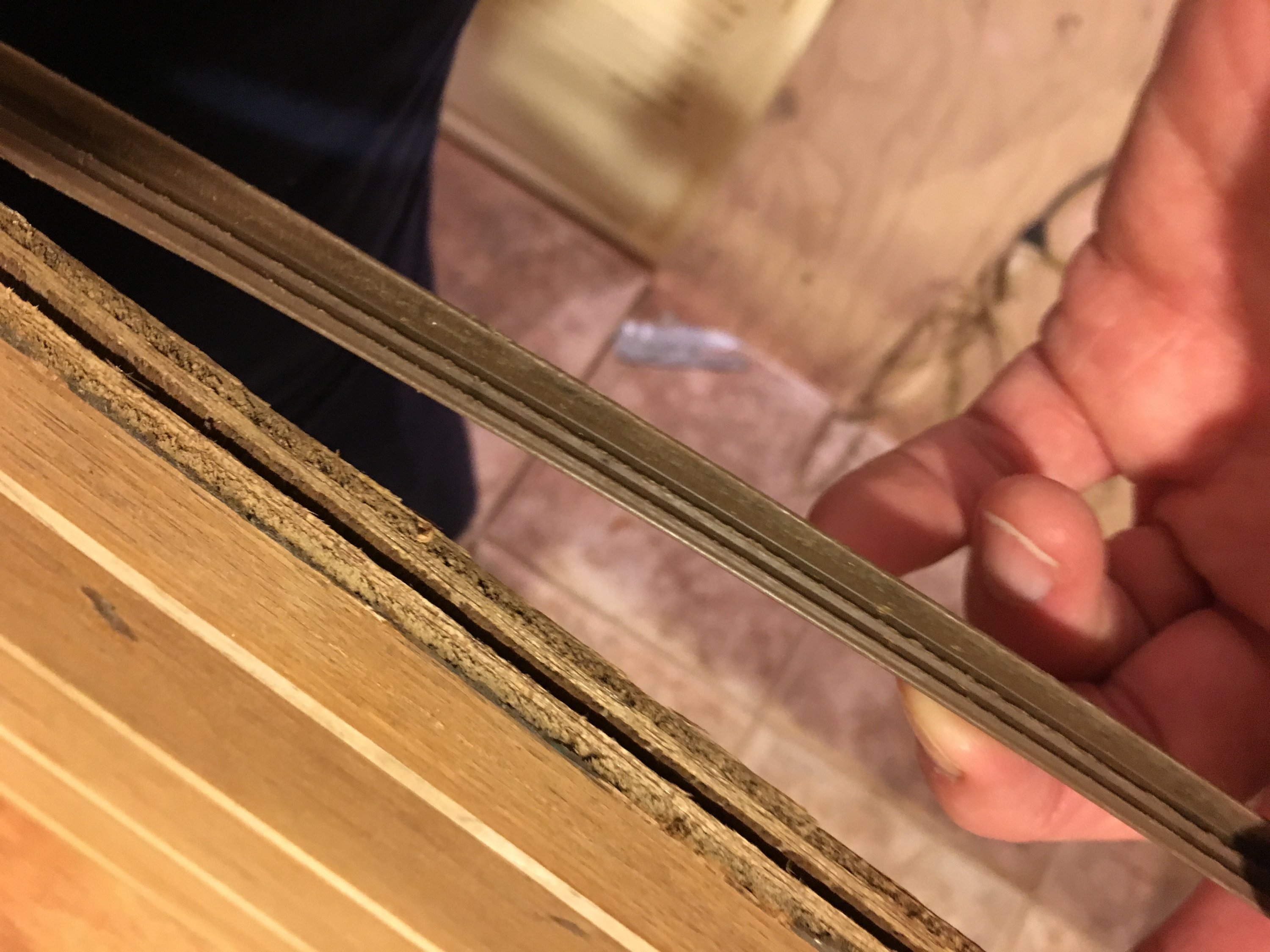

Anyway, with the day coming tomorrow I'll be in the basement continuing to rehab the teak sole I pulled from the cabin of my 1985 O'Day 28 this past Fall. A couple questions on my rehab work (and do see photos). 1) I have a couple pieces of stripped (heat gun) flooring that clearly are no longer in the same color family (no, I didn't burn them). Not clear how this would have happened, but now wondering how to get the 5-6 pieces I've pulled to look somewhat similar before I put on a protective cover, i.e. Interlux varinsh? 2) Related, there is a plastic edge piece which fits into the side groove of the teak flooring - I'm certain it serves a purpose but I can't seem to find replacement plastic edge anywhere (not even Rudi & D&R). Time for me to wing it??

That edging looks a lot like the plastic spline that is used to hold the storm glass in a Larson screen door. It must be relatively common material. I wonder if you could find a suitable material at a really good hardware store, a glass company, or even Lowes.
When you get all of the old finish stripped, you could try wood bleach or even Bar Keepers Friend to even out the coloration difference. Since it the cabin sole, try a clear gym finish, it might stand up better than spar varnish or a urethane product.
