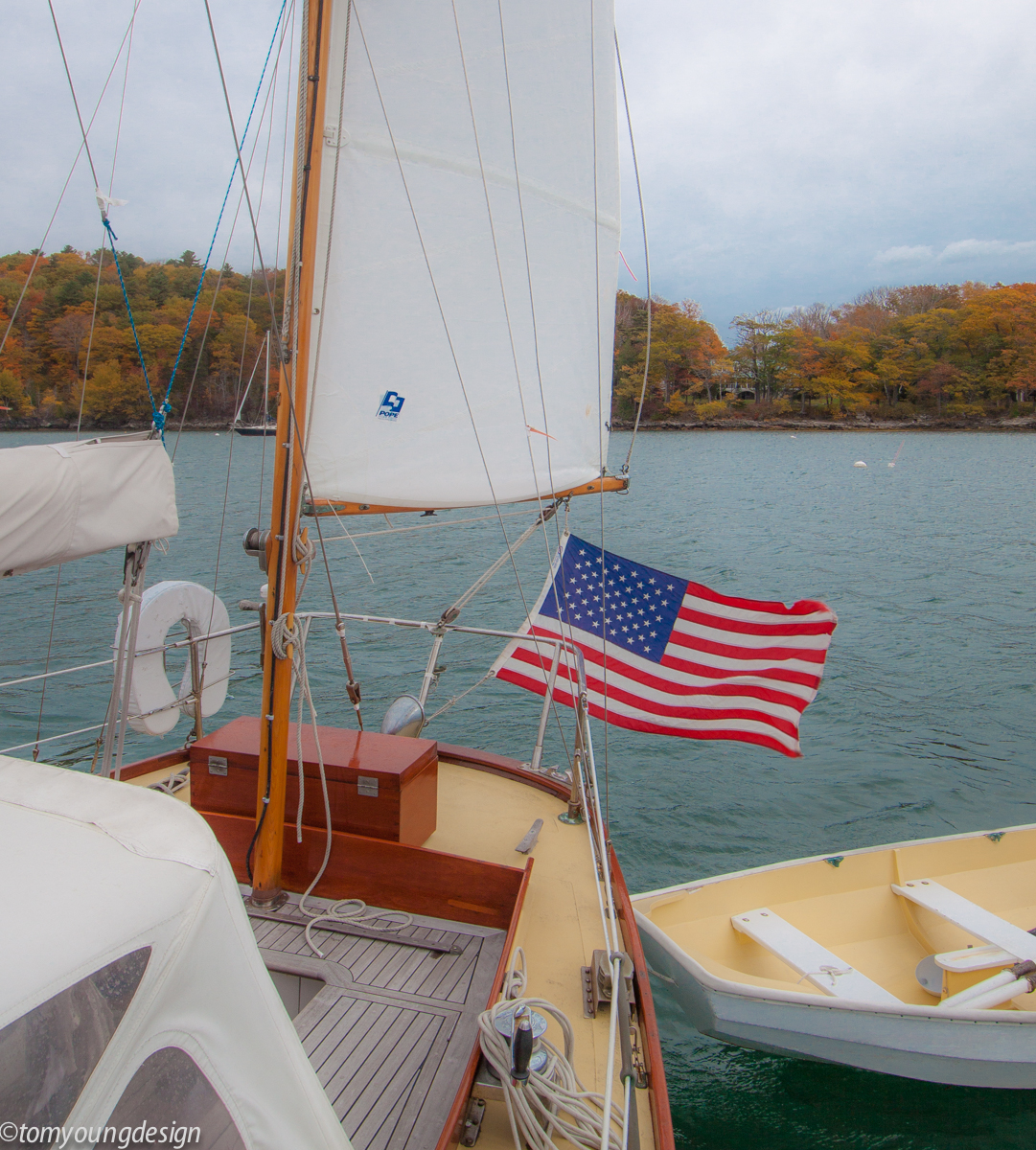

Rustoleum, Valspar, both available at my local hardware and supply. I use a Porch and Floor water based acrylic in both Rustoleum and Valspar, but I also use Valspar water based acrylic enamel in Valspar. Either comes in bases that you can get colors mixed as well as finish (Satin, Gloss etc.)
These decks are a Rustoleum Porch and Floor, now about 6 years old (they need recoating but no peeling). The dinghy interior is the same or could be a Valspar enamel. Easy to get the shade you want.
